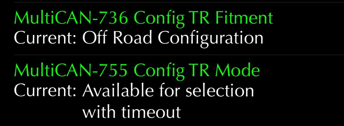

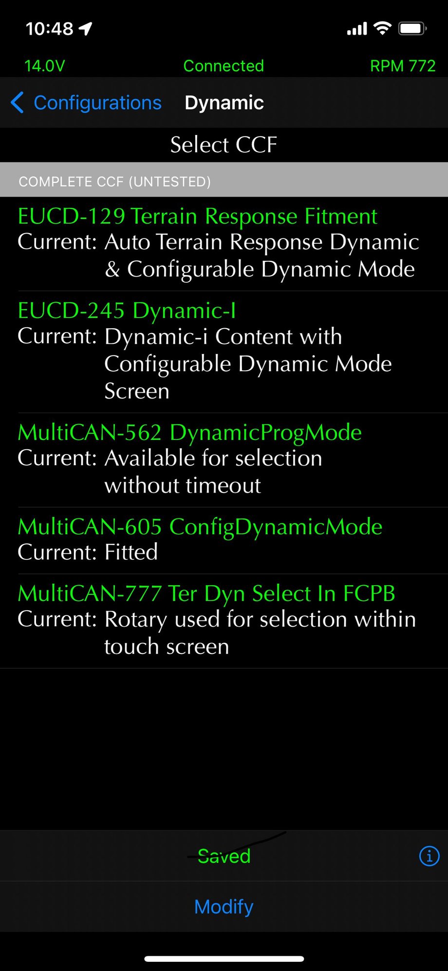

I admit, I am struggling with a few items. I can’t seem to enable dynamic mode, yet followed closely the guidance above even making changes one setting at a time. Below are my settings:
Additionally, the configurable terrain response eludes me as to activating and using it; any guidance?
Not sure on all but for dynamic your list is not complete. You need these. *Dynamic Mode*
EUCD - 245 Dynamic 1
Set to “Dynamic 1 Content with Configurable Dynamic Mode Screen”
MultiCAN - 562 DynamicProgMode.
Set to “Available for Selection Without Timeout”
MultiCAN - 605 ConfigDynamicMode.
Set to “Fitted”
MultiCAN - 682 DynamicLiteMode.
MultiCAN - 777 Ter Dyn Select In FCPB.
Set to “rotary used for selection within touch screen

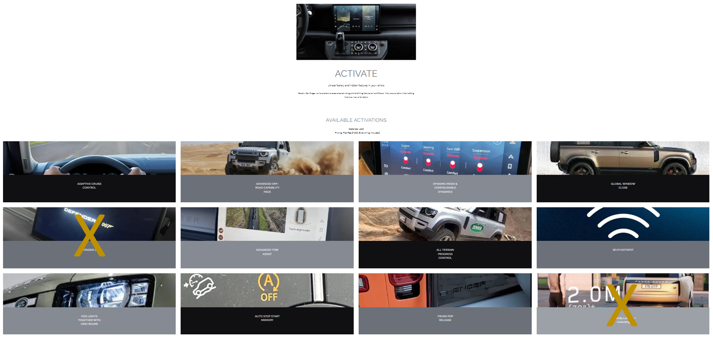

I decided to stop waiting for ACC and jumped into the abyss by contacting JLR Active (www.jlractive.com) for the $1,000 package.
Here's the deal -- you no longer need to be in -or travel to- Southern California to get the activations. Garrett shipped me a loaner laptop, cables and tool for me to use at home in the PNW.
Great to talk to on the phone. Answered all my questions and concerns. Gear arrived as promised and was preprogrammed(!) with my VIN and my desired features. We did the full activations with him on Teamviewer to his laptop in under an hour - including reconfirmations, reboots and a test drive to validate it all stuck. I could not be happier with the results!!!
In addition to the full list (I didn't care for the 007 splash screen, and Global Close is only available on MY24), he activated and updated the firmware on the OEM towbar electronics module I installed a few months ago, turned off the annoying Drive-Away Locking and Drip Wipe features too.
ACC/Adaptive Cruise Control WORKS!
Dynamic Mode works!
Auto Stop/Start memory works!
Advanced Tow, Key Fob rear door release, All Terrain Progress, foglights stay on with high beams, wifi hotspot, IT ALL WORKS!
I know a lot of good people are working hard on the GAP Tool and other ways to get the evasive features like ACC to work. I wish you well, but I can't say enough good about the service and results from JLR Active. Thanks Garrett!

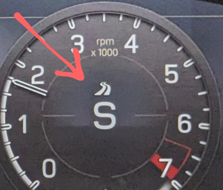

I have the same result after the JLRActive activation of Dynamic in my 2020 D110 P400.
The gauge rims did not turn red (like they did in my L494 RR Sport), but yes, the Ambient Lighting around the cabin (passenger-side dash, footwells, door handle recesses, etc.) turn from my preset color to red when Dynamic Mode is selected and go back to my preset blue color when out of Dynamic. The Dynamic symbol however does appear over the transmission setting window while in Dynamic Mode.
