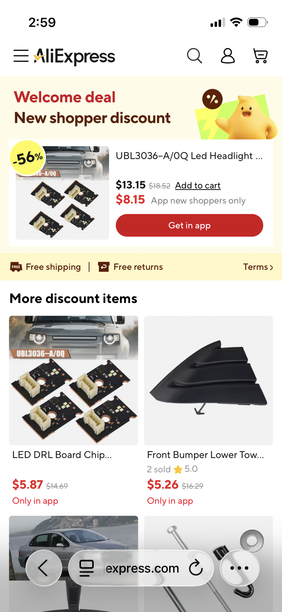

You can get a wide range of pricing on the DRL module.
I got mine from Aliexpress
$2.38 including shipping.
I have no idea how but that’s what I paid. There are oodles of options to buy.
Some seller were selling them in packs of 2, 4 or 10

Originally Posted by DoctorofRocks
Could you share a link? For that price I would order some to have as spares.
Its been a while since i bought it but a quick google search found these in seconds.
$6 for 4 seems good value.
