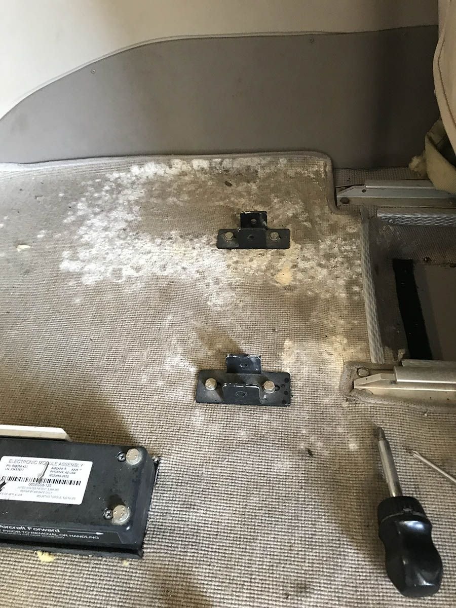

Bad news, all river water has spores for mildew. You can head it off with a technique we use in airplanes, since they leak like sieves and tend to be parked outdoors. While doing the cross ventilation drying process you can put a shallow pan on the floor somewhere inside the car (put something under it just in case) with ¼" of ammonia. The Ammonia will vaporize and kill most of the spores during the drying process. It also give your car a wonderful antiseptic smell.
What happened to my airplane on the ramp in Mumbai in very short order, so not even remotely a joke about mildew:
