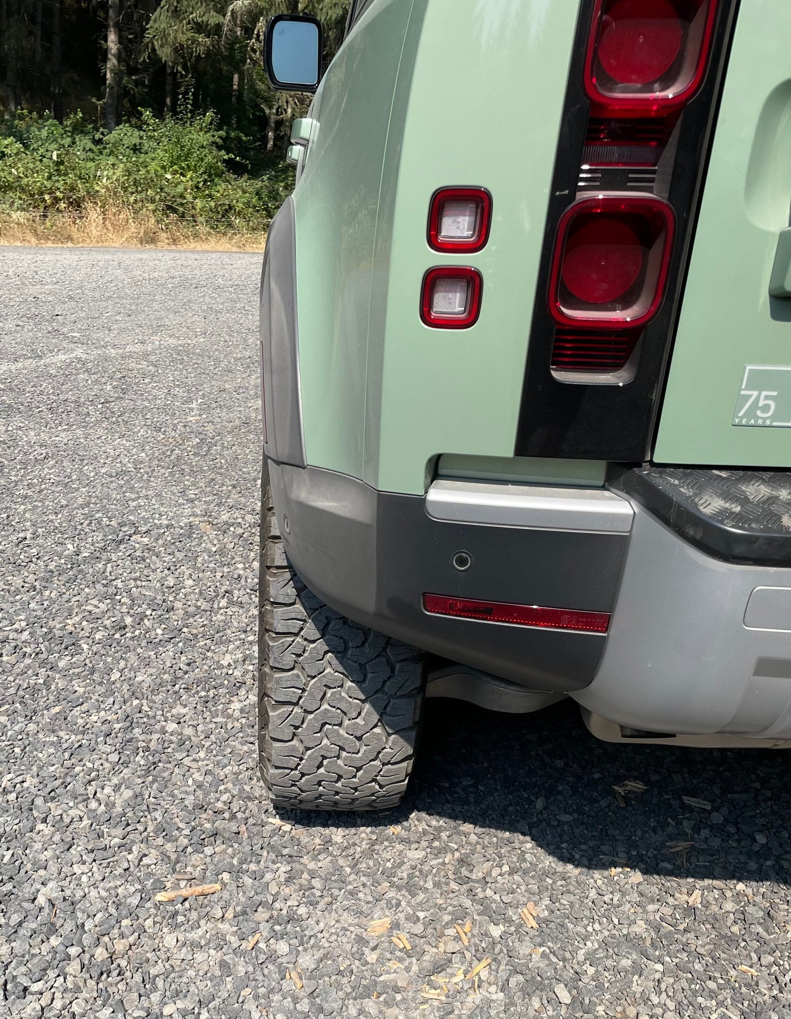

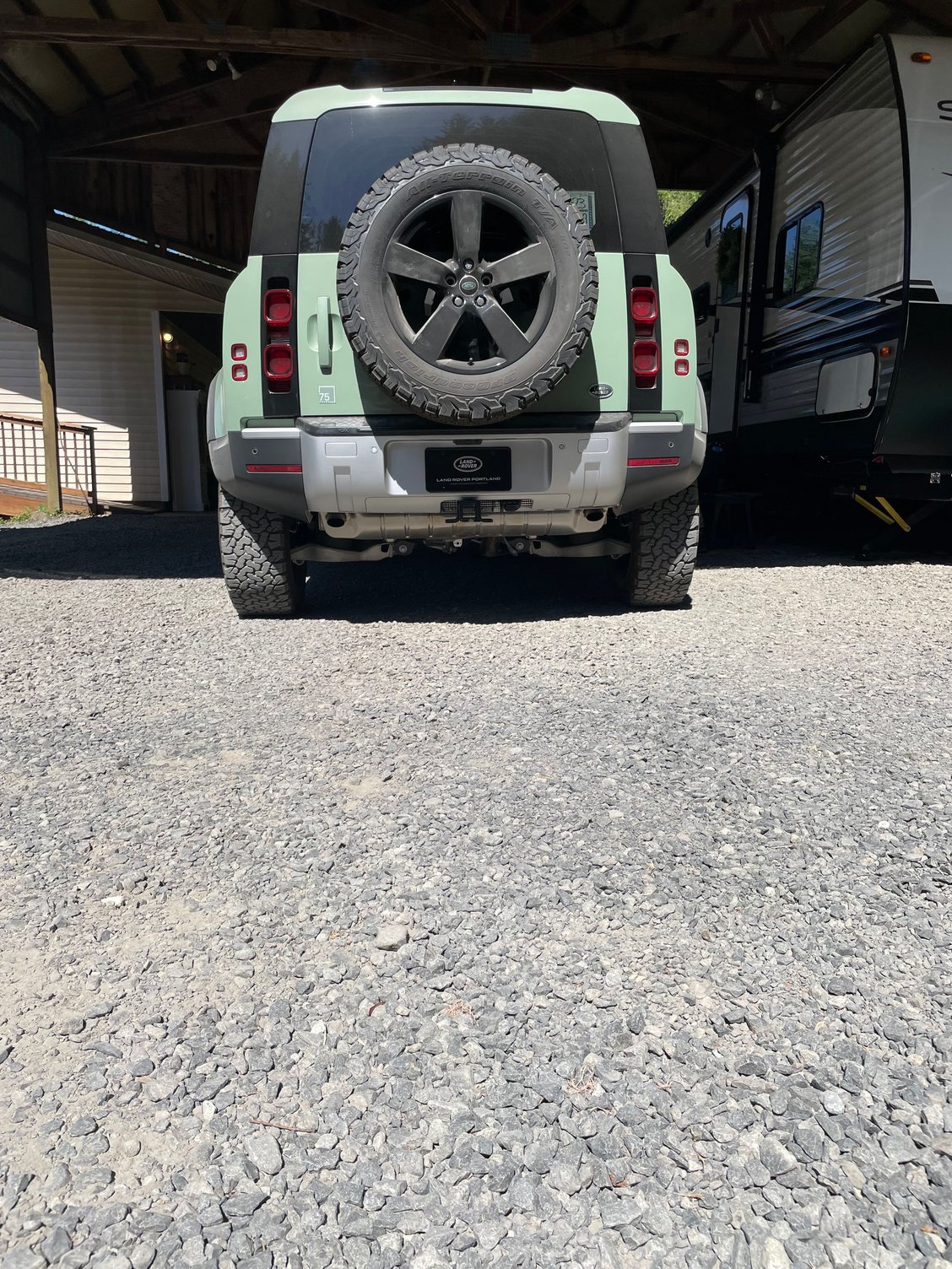

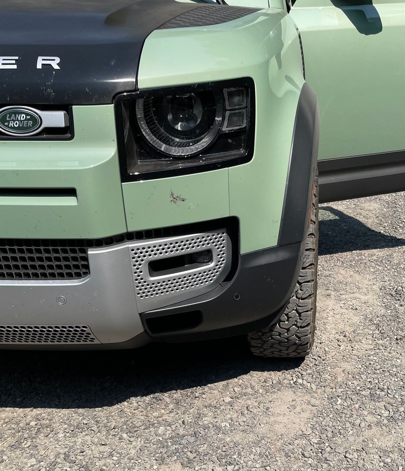

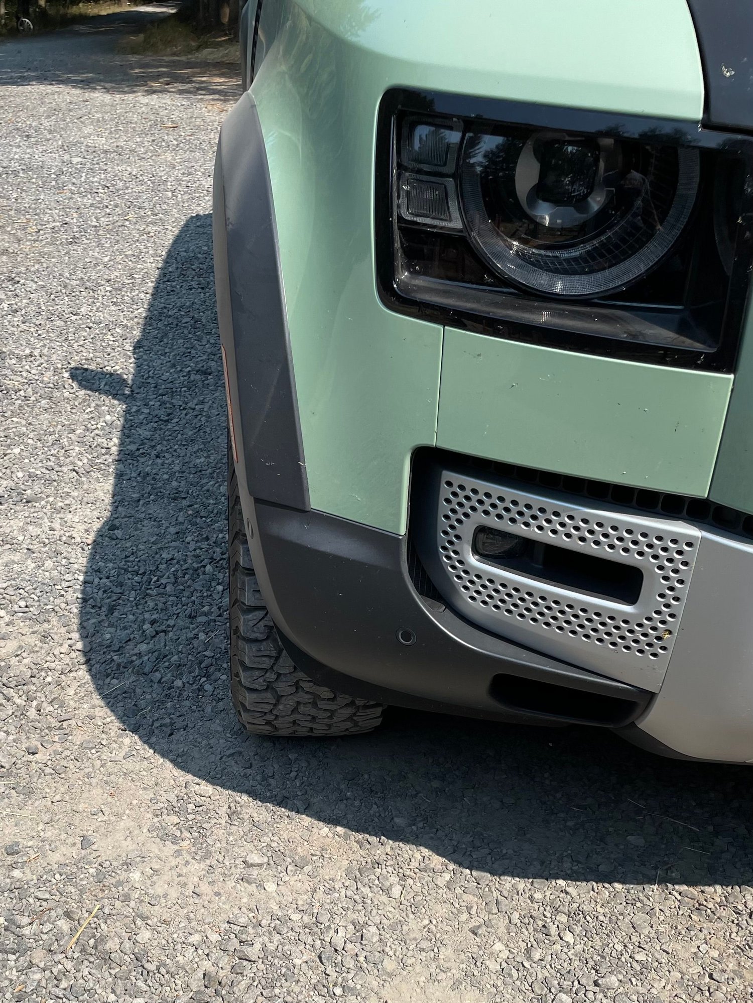

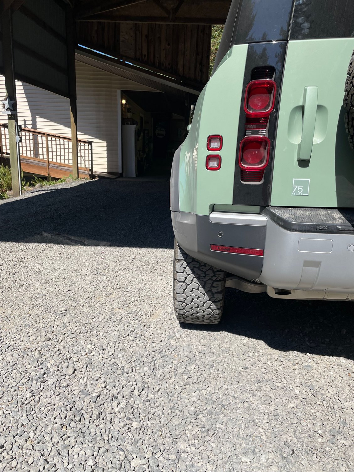

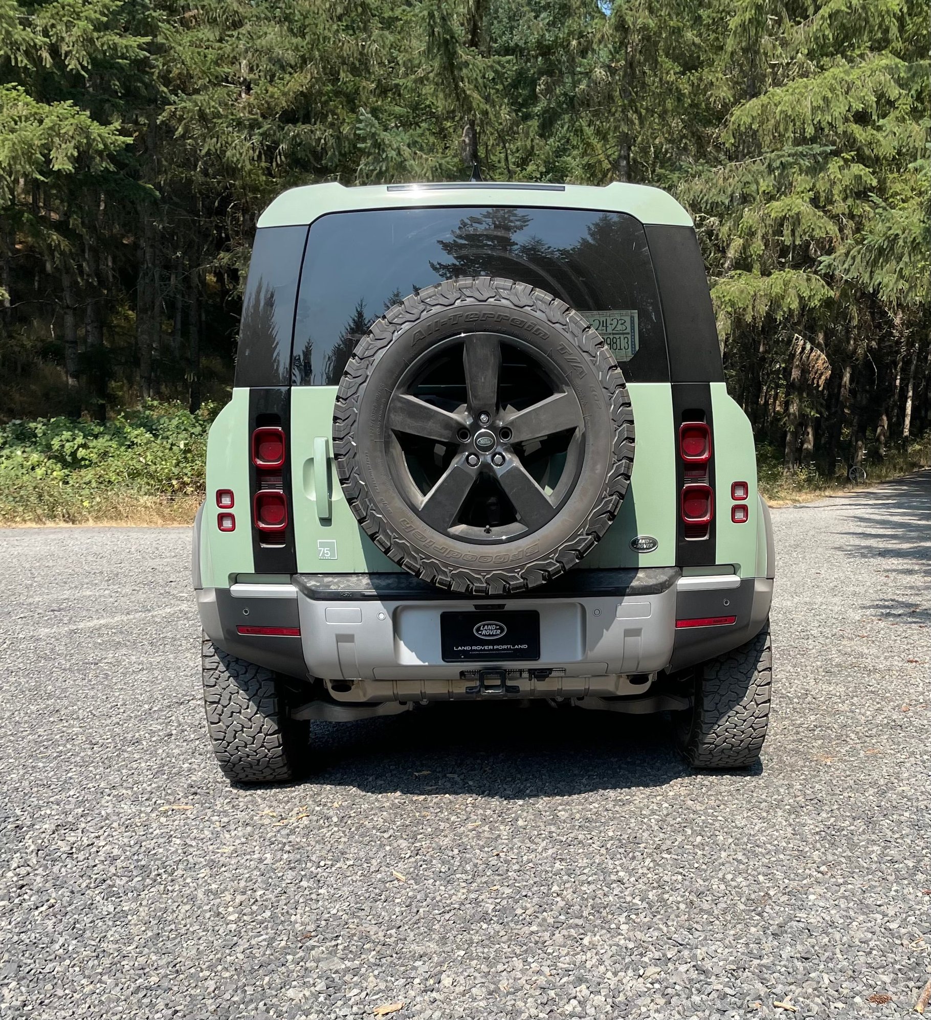

Tried the 25 front 30 rear and that was a no go. I am running 1.5 inch lift rods with 275-60-20 BFG KO2’s. The 25mm on the front caused significant rubbing at full lock both front and rear. If it was just the front I would have considered inner cooler relocation for more room. Ended up doing 20mm front 25mm rear. Turned off auto access height as it is too tight in the front in access setting. Will still use it manually when not moving. In normal height it is tight but looks good.
Here are the before pictures.
And the after.
Old Aug 18, 2023 | 10:17 PM
