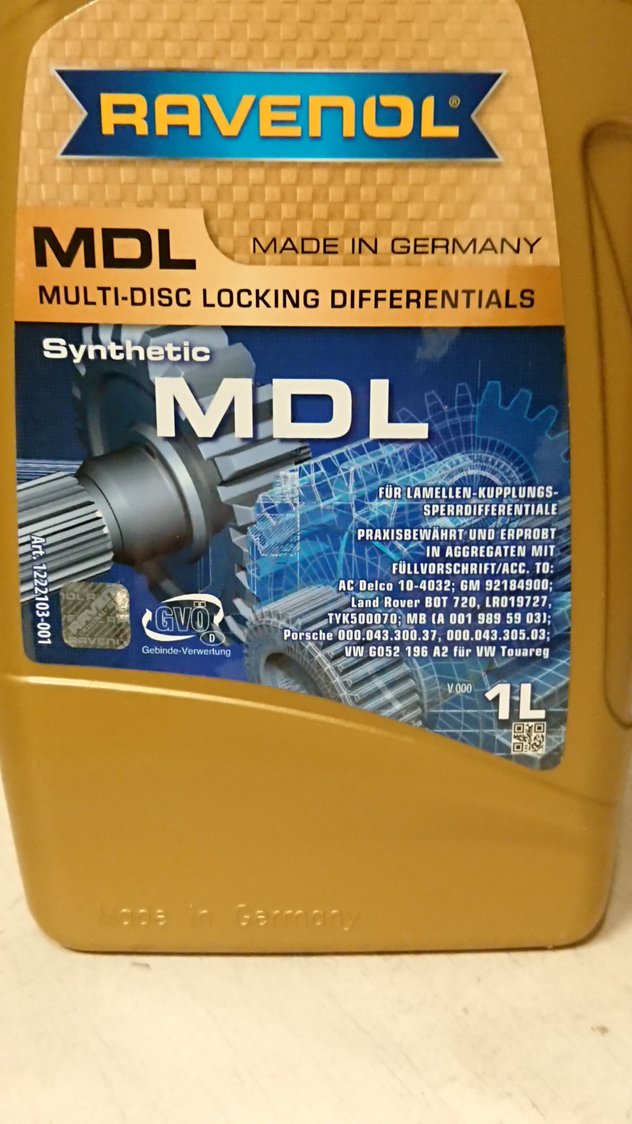

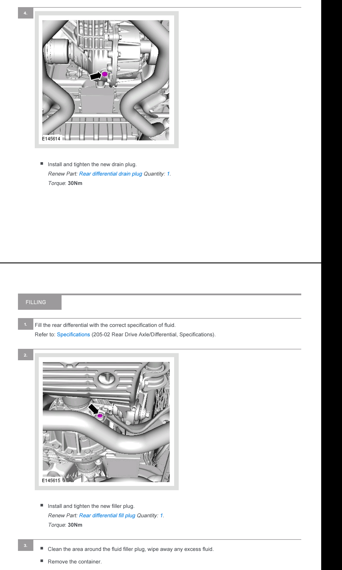

Last week I did a oil change for the rear e-diff, it's almost 4 years old not done that many miles but for peace of mind.
Looking for the Castrol BOT 720 / LR019727 recommended by JLR, little hard to find and relative expensive.
So checking the specs I went for Ravenol MDL
Drain plug comes out with a 1/4" ratchet. Filler plug uses an allen key 8mm

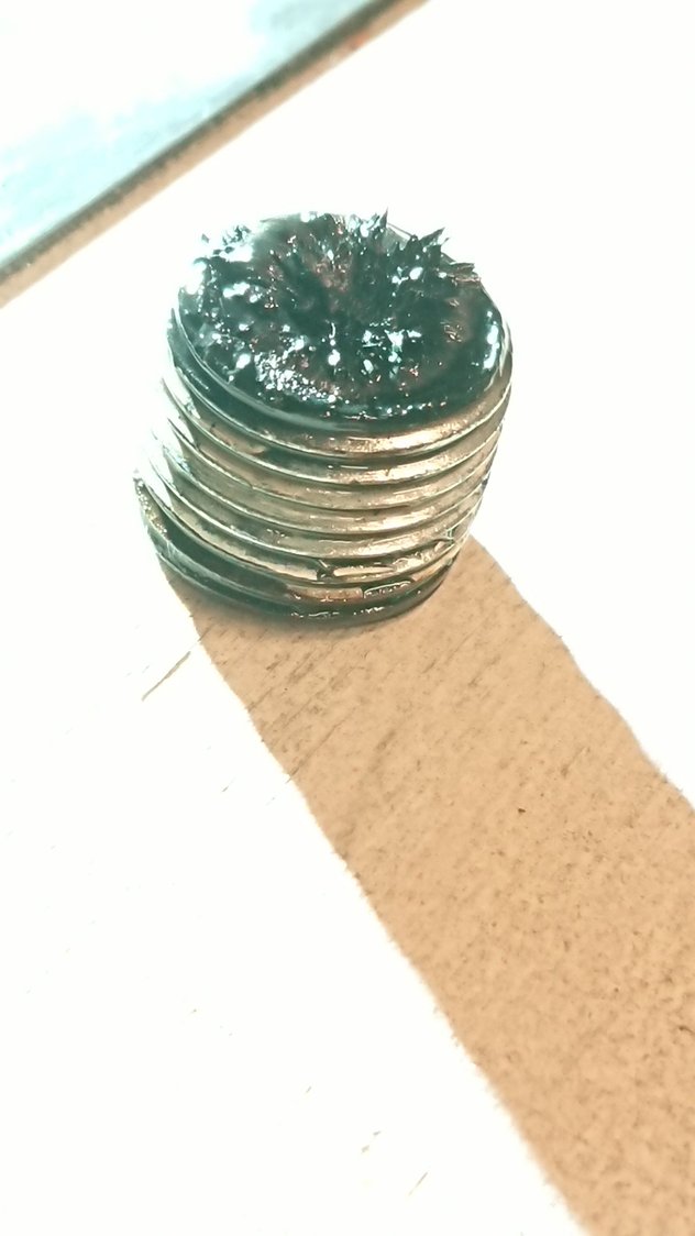

The oil was dirty but without metal debris, the magnetic drain plug keeps it out of the oil.
Refill with a pump 1.2 Ltr / 2.6 pints , closing up the filler plug and done.
So maybe to early, but better safe than sorry.
