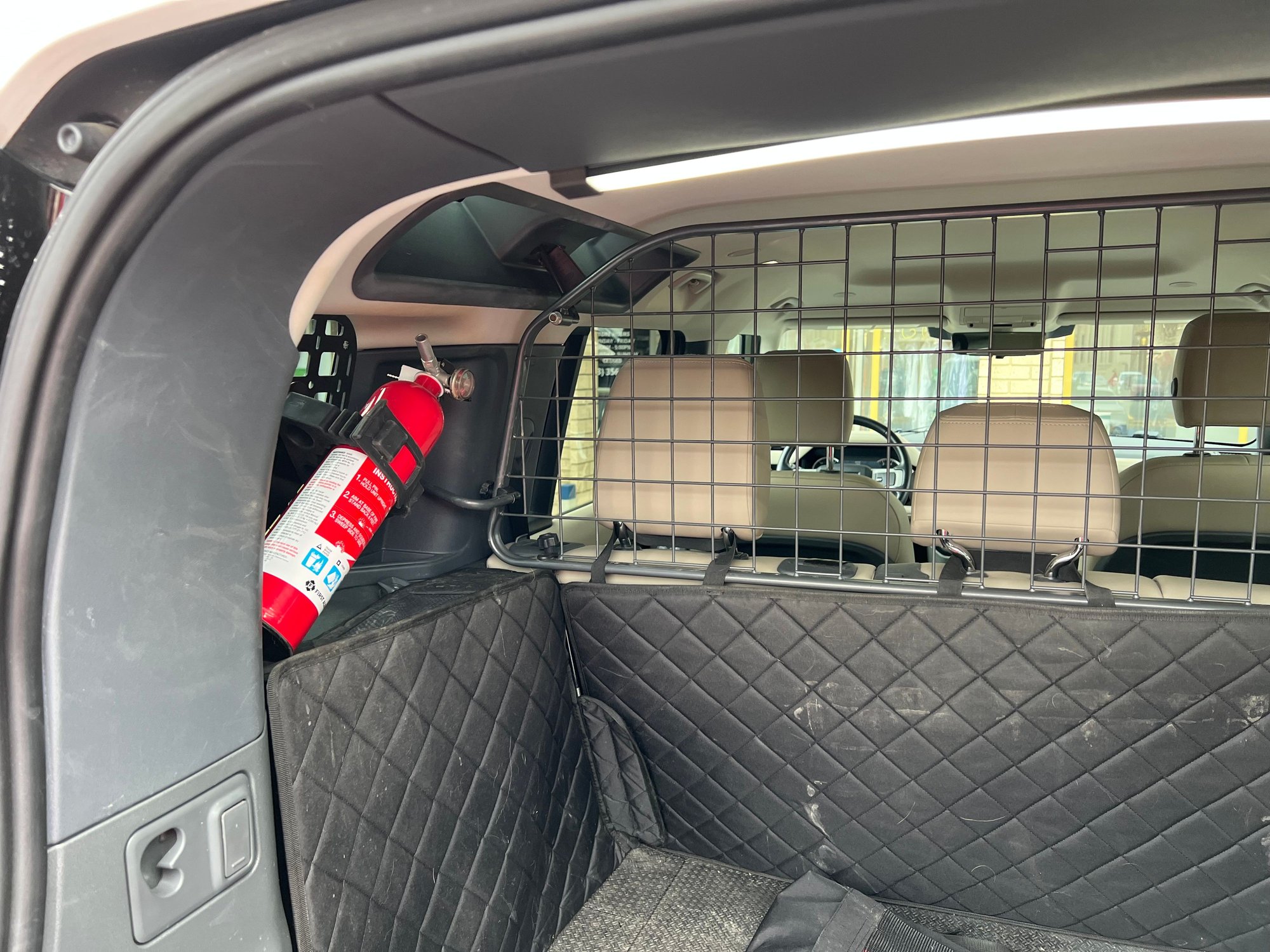

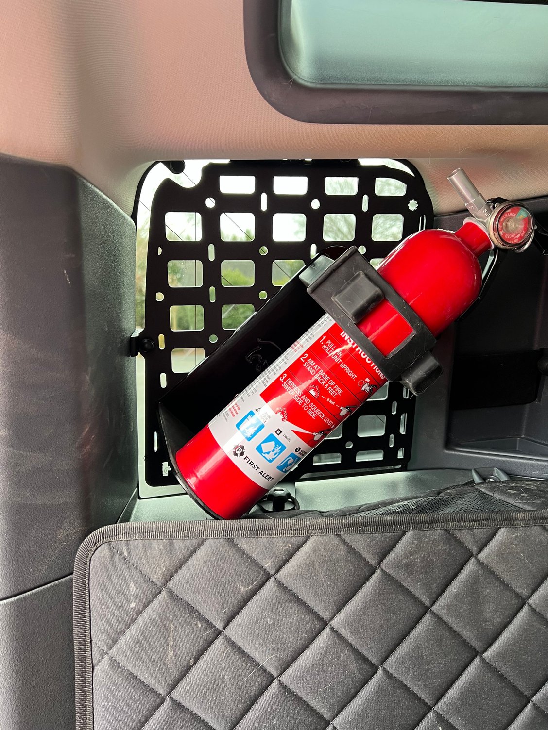

Fixed a squeak in my 2023 110S that had been driving me nuts for more than a year.
I have a Travall Dog Guard to keep our 85 lb Golden Retriever in the back where he belongs. It's well-designed, well-made, and does its job.
https://www.travall.com/travall-guar...ender-110.html
I wanted a fire extinguisher in the vehicle, but there was no easy place to secure it. Then I saw the Lucky 8 Dog Guard Fire Extinguisher Kit.
https://lucky8llc.com/products/dog-g...tinguisher-kit
Perfect. I mounted it to the dog guard well on the driver's side so it wouldn't block my view, and was happy. Until the squeaks started. The weight of the fire extinguisher on the dog guard makes the dog guard's attachment points wiggle and squeak, no matter how tight they were.
Finally, I decided to try Powerful UK's Interior Side Molle Plate:
https://www.powerfuluk.com/collectio...ender-110-left
I installed it this morning on the left side, with the fire extinguisher mount angled so it would fit. It's hard to see in the picture, but the mount is fully suspended; it's not resting on the plastic sill.
No more squeaks. Should have done this long ago.

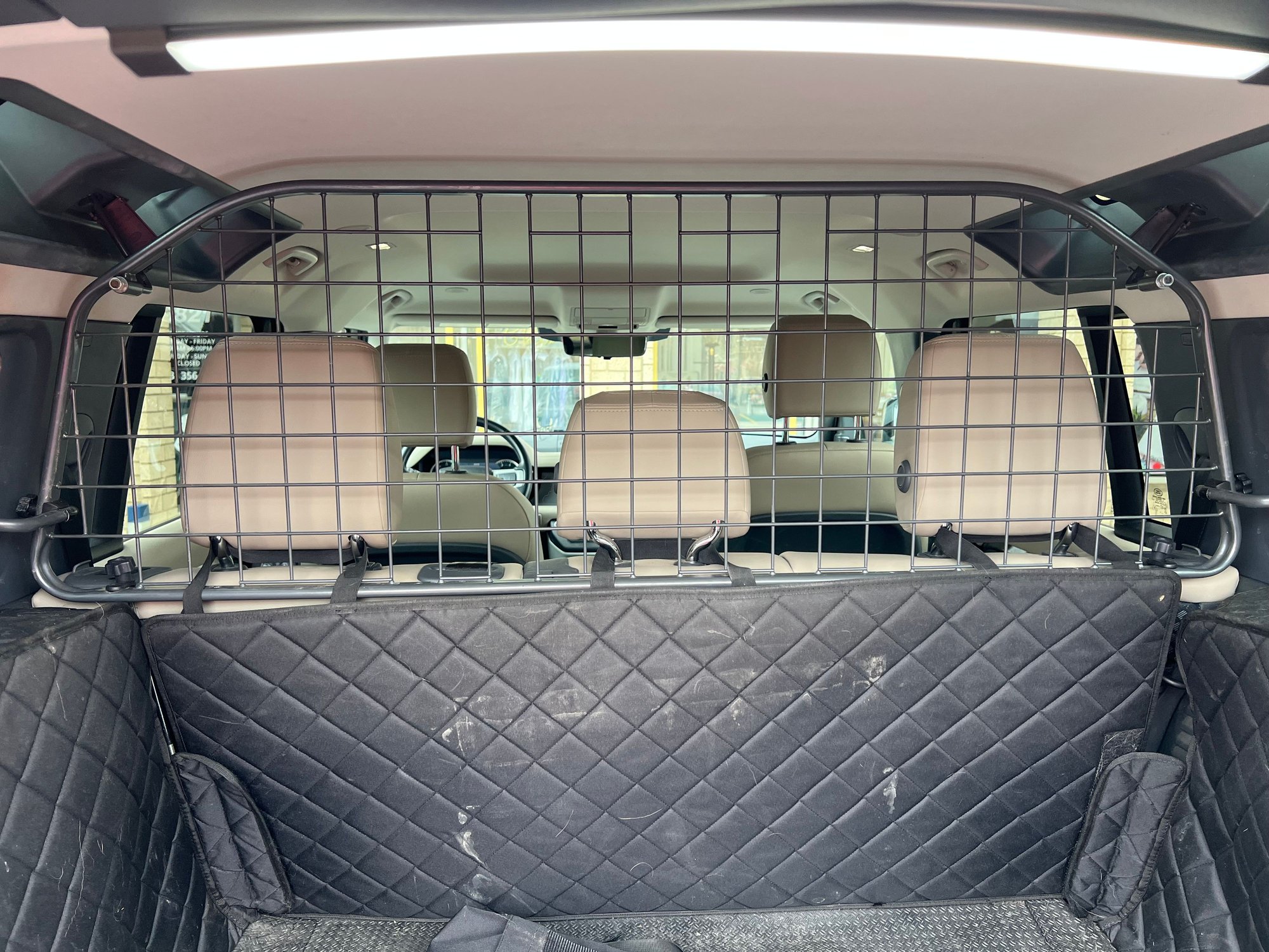

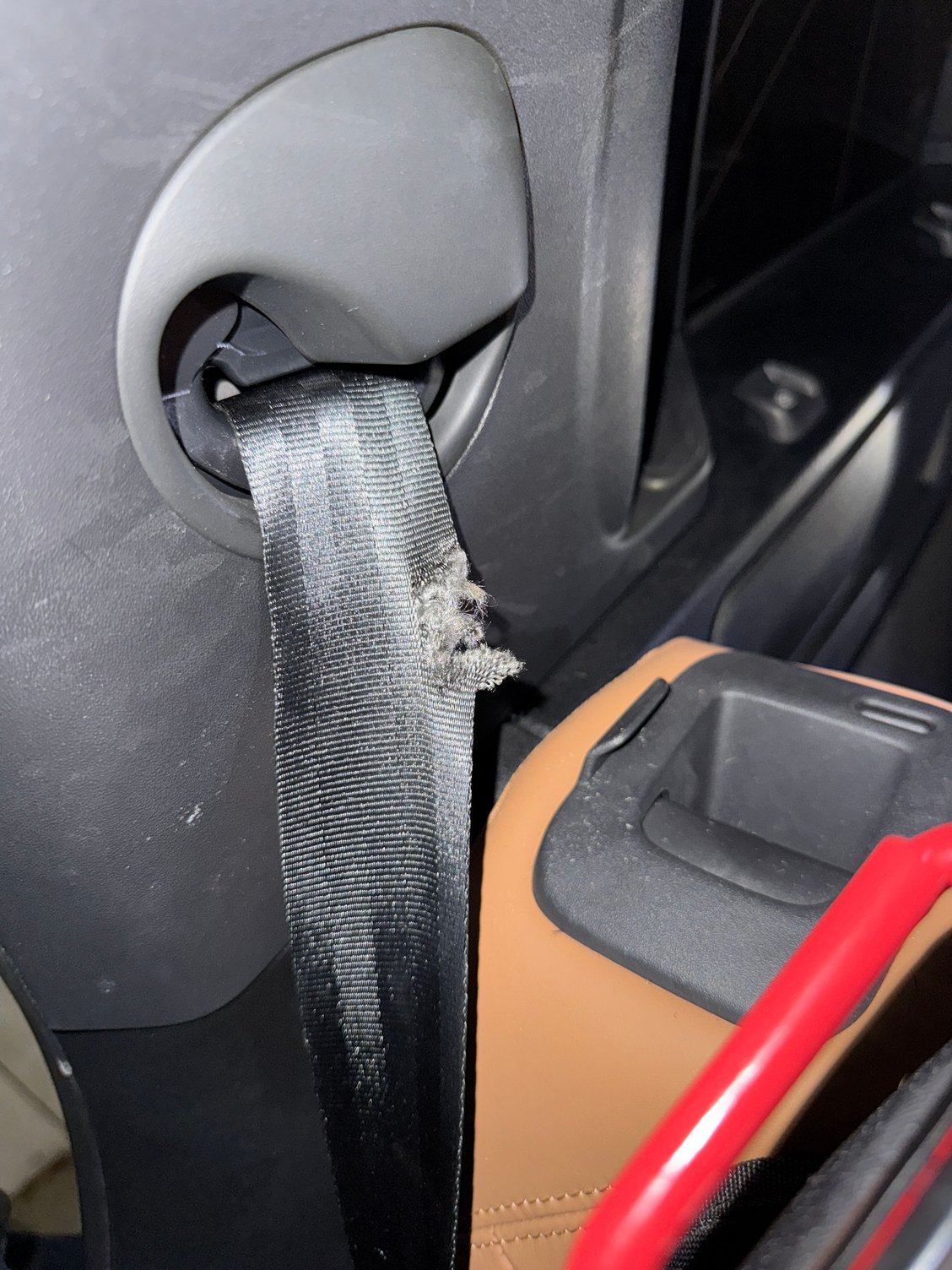

where did you get the diamond quilted trunk cover? I need that setup because my Doberman got to my rear seatbelt

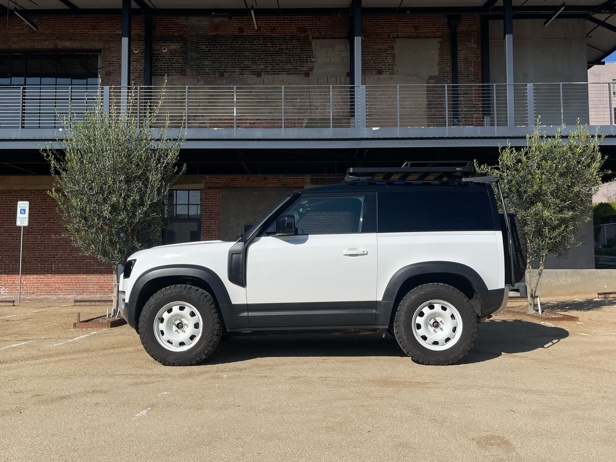

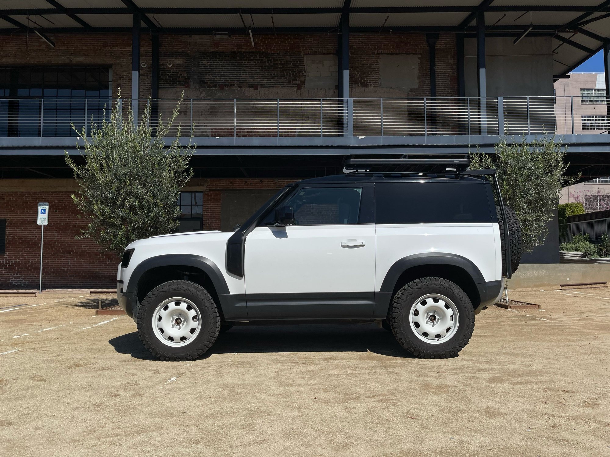

Finally had a chance to install and put some milage on my Sarek coils. Rides just like stock and appreciate the extra clearance on the trails.
Went with a custom 1.5" all around as it's my daily and I don't usually carry that much gear in the back. Tires are K02 265/70R18's.

I’m sorry I didn’t see and reply to this earlier.
The liner for the cargo area is a Lamd Rover accessory that I ordered with the vehicle and picked up when I took delivery in late 2022. I just looked at the website, and it appears they have far fewer accessories than they did when I placed my order - the various mats and liners are all gone. Weird.
I’m sure there are aftermarket versions out there. I just wouldn’t know what to recommend.

I got a genuine LR quilted liner from Land Leaping...the pics are not great on the website, but I can post some if you like once the rain stops in my area. Here is the link:
https://www.landleaping.com/oem-part...iner-vples0568
