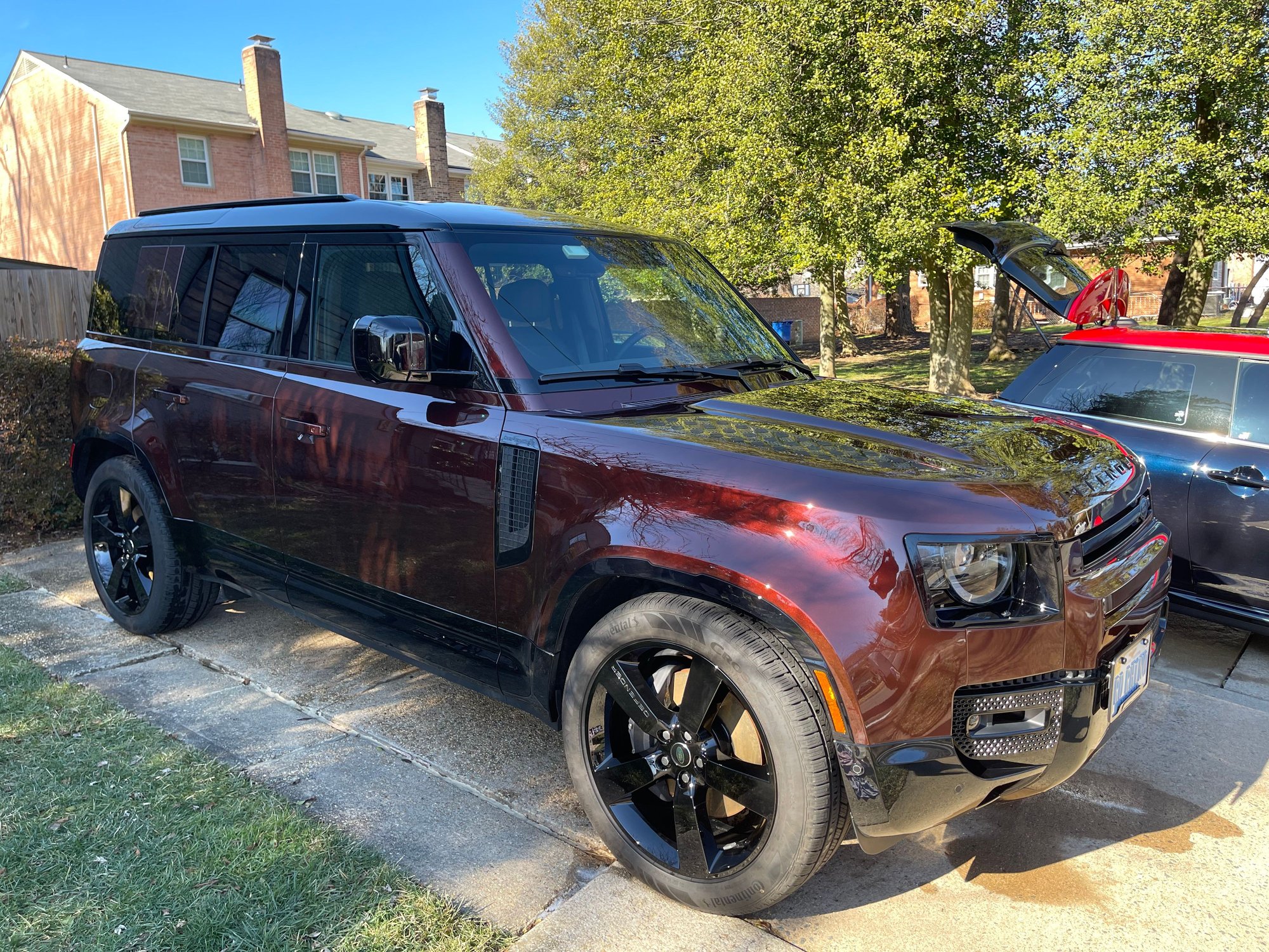

First wash...man that thing is big...I thought my Land Cruiser was a lot to wash - this thing has so many nooks and cranny's.

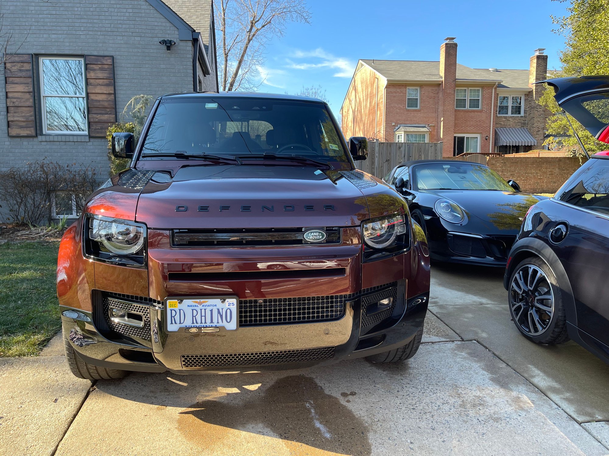

looks great!
What from license plate holder are you running?

From: NoVA
@RoverMcRoverFace it is a Sly bracket for Land Rover Defender with mesh grille - I have used these on a few other vehicles and they are great. I initially had it mounted in the center below the camera...but the camera picked up the top of the license plate and I didn't like it interfering with video. YMMV - I think it looks better in the center...but the video really bugged me.
Just ordered one, thanks for the info!

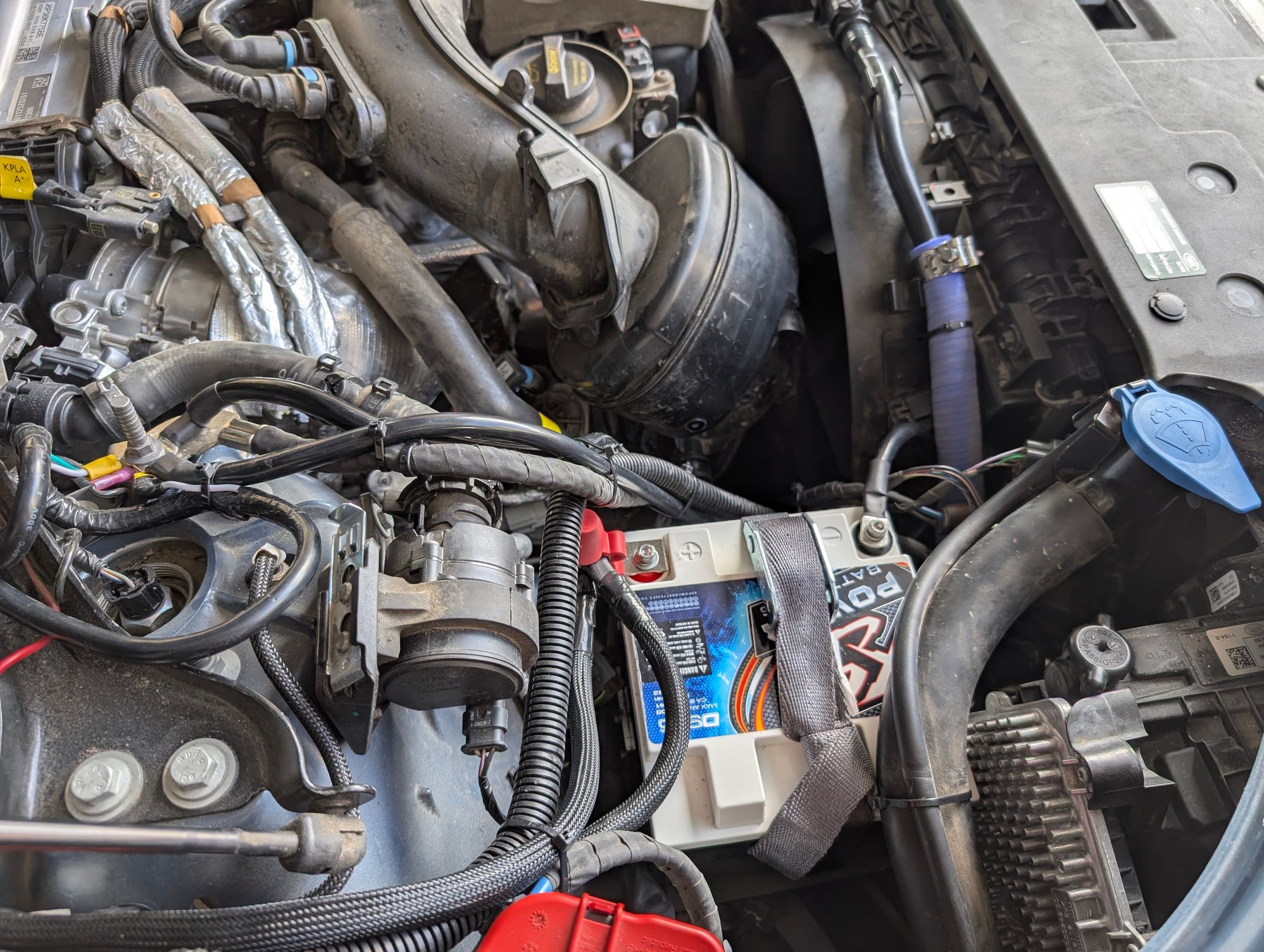

Installed Sarek battery tray today. Decided to do it so the winch has a little more power readily available and can run a few more accessories without the low battery warning light comming on while camping.
The tray was a little bit of a struggle to get in. I believe this tray was designed around a 90 p300 with standard headlights. The coolant pipe to the aux radiator needed to be modified. The tray itself needed to be notched to fit correctly as the aux radiator was in the way. That is because I installed saltek aux radiator relocation kit. The relocation makes the top of the radiator interfere with the tray. The final problem was I think the tray might have been designed around the standard LED headlights, I have the premium headlights, which appear to be longer. So that caused the battery to push closer to the wheel well, but that wouldn't work because of some structural ribs being in the way. The solution was to raise the battery about 3/4 of an inch. I made some brackets out of aluminum.
