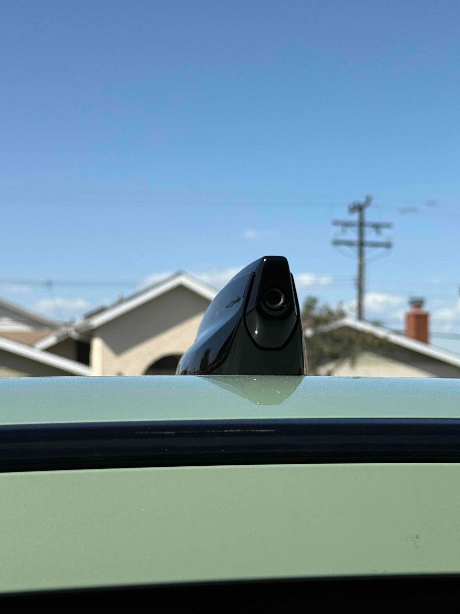

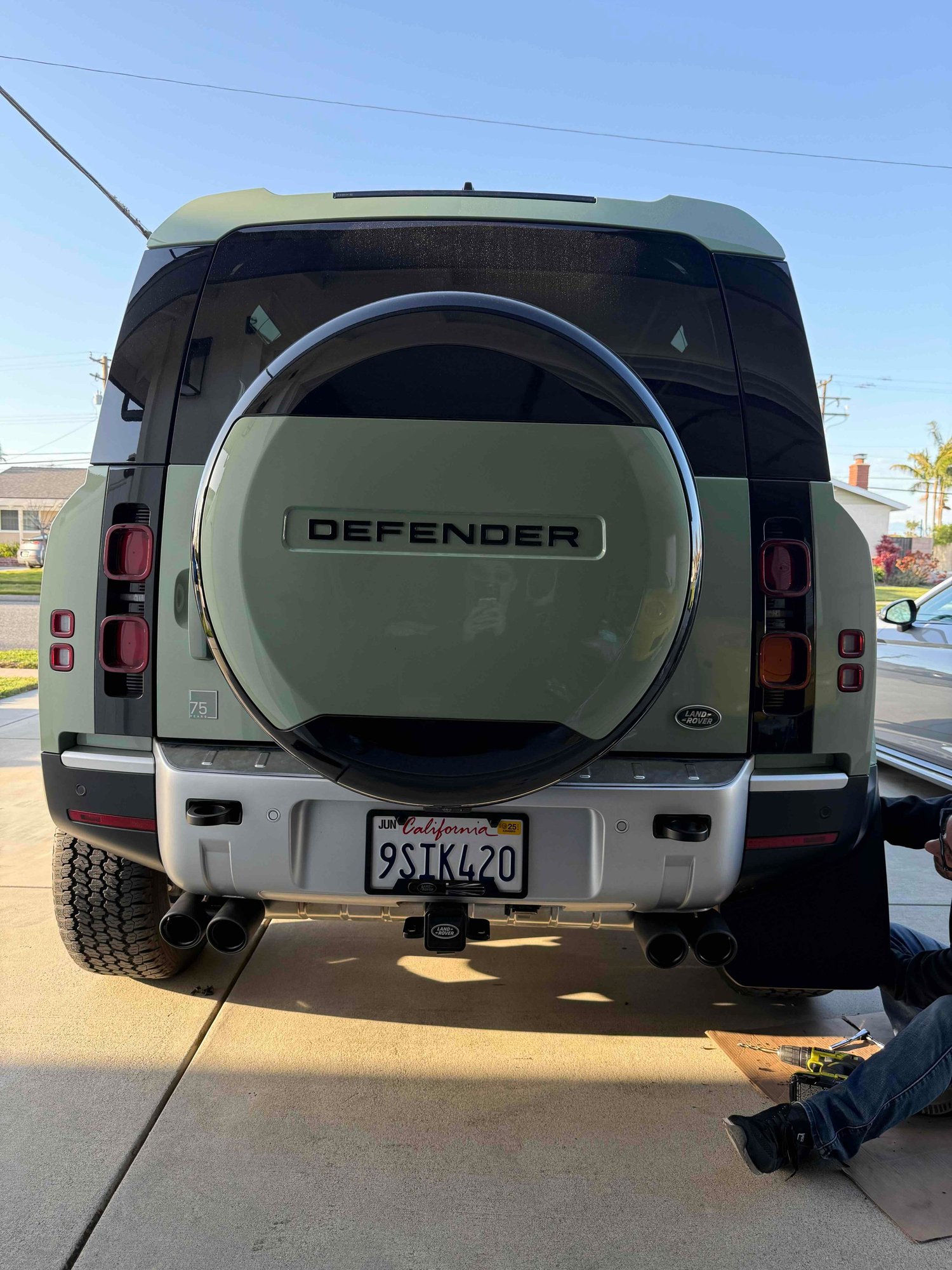

I bought Clear Sight mirrors (used rear view mirror, new shark fin camera + housing, Fakra cable), mud flaps, rear tow eyes while back and finally installed past weekend.
• Clear Sight Mirror: Install was very straight forward. only hard part was fishing Fakra cable from shark fin to mirror. Other than that it was surprisingly easy job. Even Gap tool was instant.
As it does not show right behind anymore, it requires some learning curve and adjusting time. But very clear sight on highway driving is awesome.
• Rear Tow eye install: taking rear bumper out was a puzzle. When I thought I removed all, it wasn't close. Keep finding more hidden screws. Mix of Philips, Torx and clips. Painful. Didn't disconnect any of wires behind the bumper. Just put bumper sit on the stool and installed tow eyes. As I didn't like rough finishing and gloss pain of OEM, installed eBay version with Satin finish.
• Classic Mud Flaps: rears were pretty straight forward. I did same time when I was installing back of rear bumper. But fronts were unexpectedly harder. I may need to re-do front passenger side as it's not sitting perfectly.

As there's no OEM option for Grasmere Green wheel cover since it was never offered, I bought it off eBay. They have a few options:
Black area: matte vs. gloss, lettering: OEM style no color vs. gloss black. So I picked gloss black. Search on eBay. They have pretty much all colors. Under 250 price tag, color match was pretty good and took about 2-2.5 weeks.

I bought my mirror used from eBay. You will be able to find one that is from parting out cars from damage.
And the brand new shark fin camera + camera cover is also from eBay. It's from European seller.
Then only thing you need is female to female Fakra cable (12 ft. was plenty long for D90) from either eBay or Amazon.
These are only 3 (or 4 if you count the camera cover) parts you need to install. Then GAP tool config will do the job.
While I was doing it, I did mirror tab hardware detector.
Other than fishing wires from shark fin to camera, rest of projects were much simpler than I thought.

These are the parts you will need:
• LR1403340 Smart Mirror with Home Link: $465 + Tax
Ebay from a donor car
• LR140535 Fin Camera (US specific, it has an extra XM antenna connector) + Cover: $375 + Tax
https://www.ebay.com/itm/386774670497
• Fakra Cable Female to Female (10-12 ft. for D90): $13.5 + Tax
https://www.ebay.com/itm/383156702966?var=651705440726
• Gap Tool
MultiCAN-711 Interior Mirror Variant: IRVM changed to SVRM (with or without HomeLink)
• (Optional) Fish Tap Wire Puller: $13.65 + Tax
[url=https://www.amazon.com/dp/B0C5RXGW3Y?ref=ppx_yo2ov_dt_b_fed_asin_title&t h=1]
Amazon Amazon
Dealer quote is around $2,500-3,500 while it's $600 option. My total cost was around $950 + 2.5 hours of struggle
