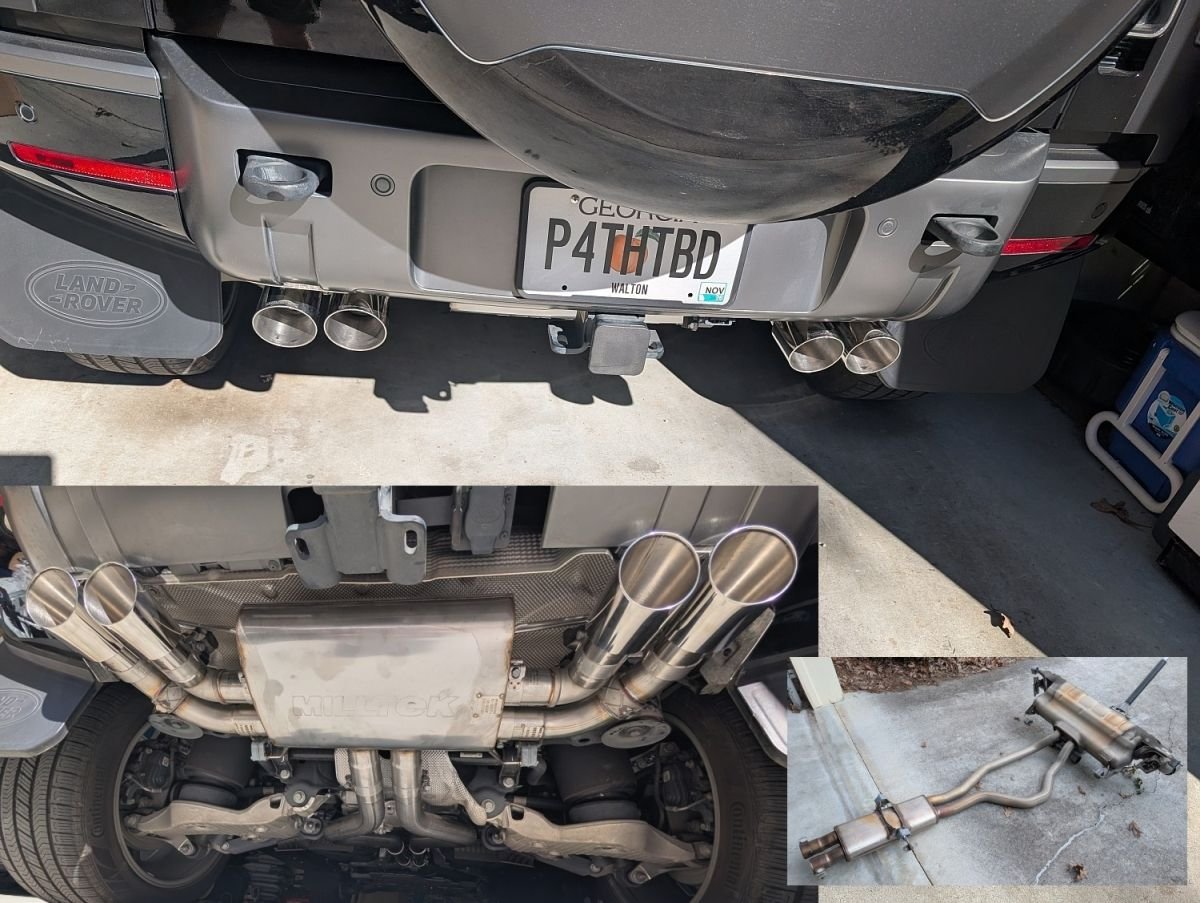

Installed Milltek non-resonated exhaust = PERFECT, sounds almost as good as my F-Type now. Took longer to get the OE Exhaust off than to install the new exhaust, the upper rear rubber hangers were worst part. Having read some other reviews about drone, I was surprised that both my wife have no issues.....regular or dynamic mode.
