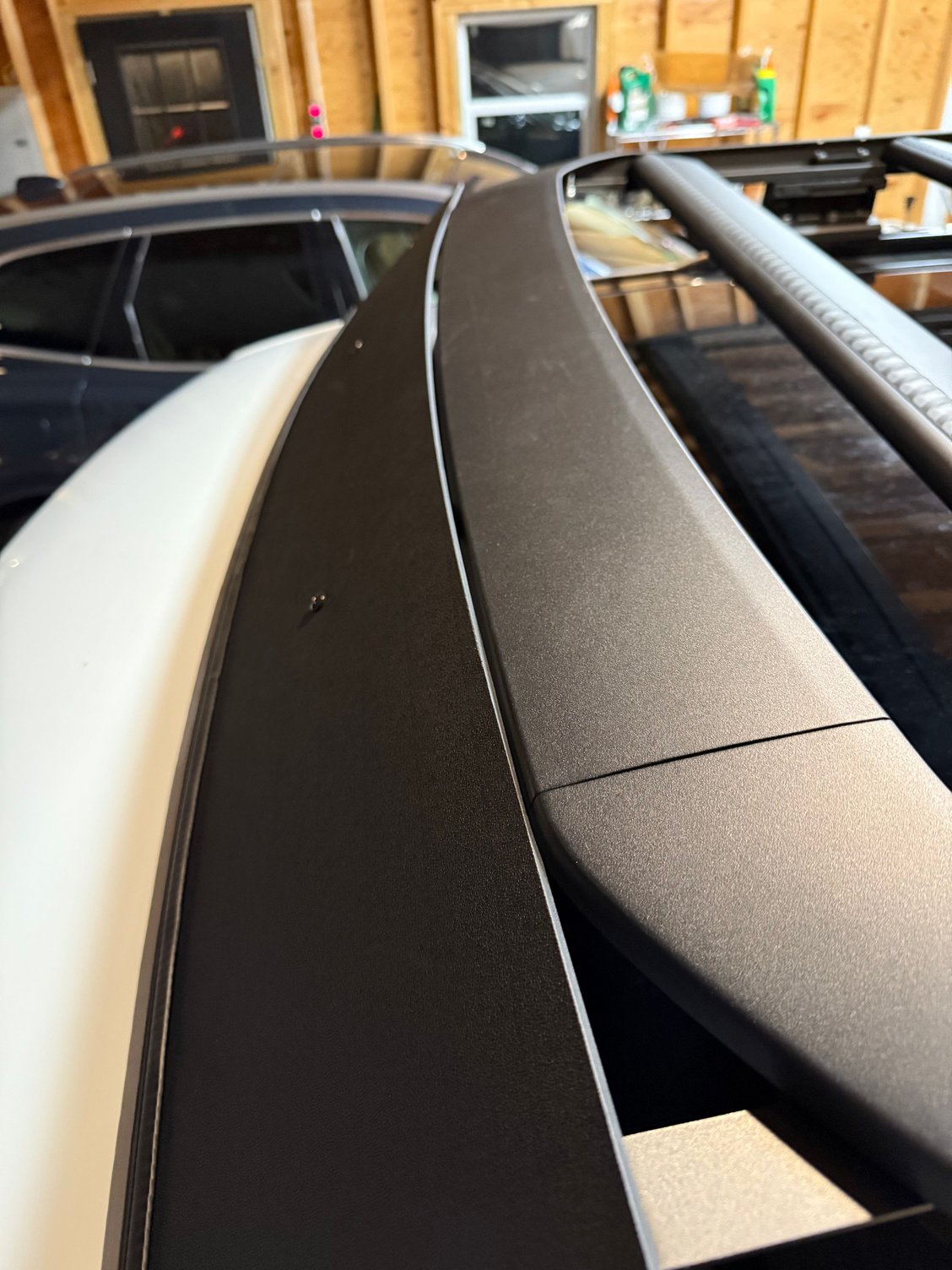

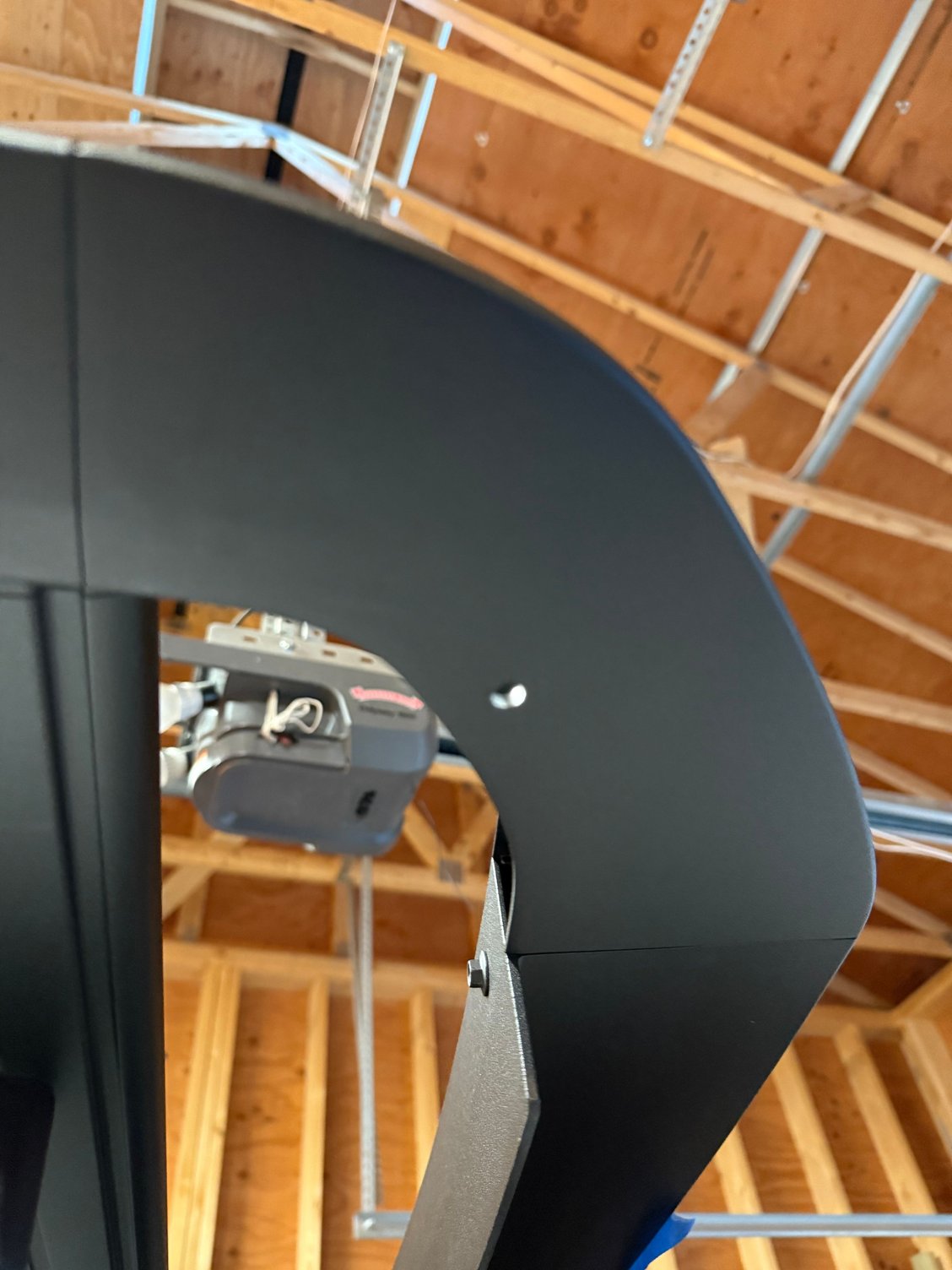

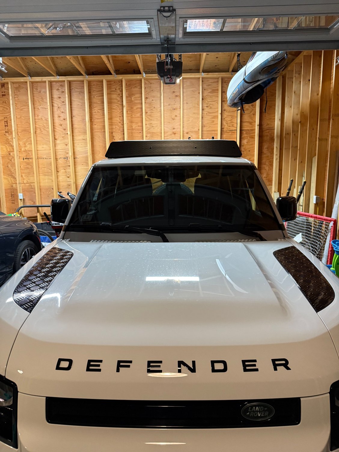

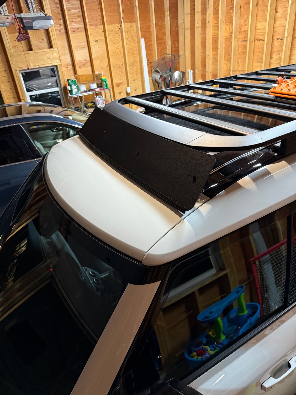

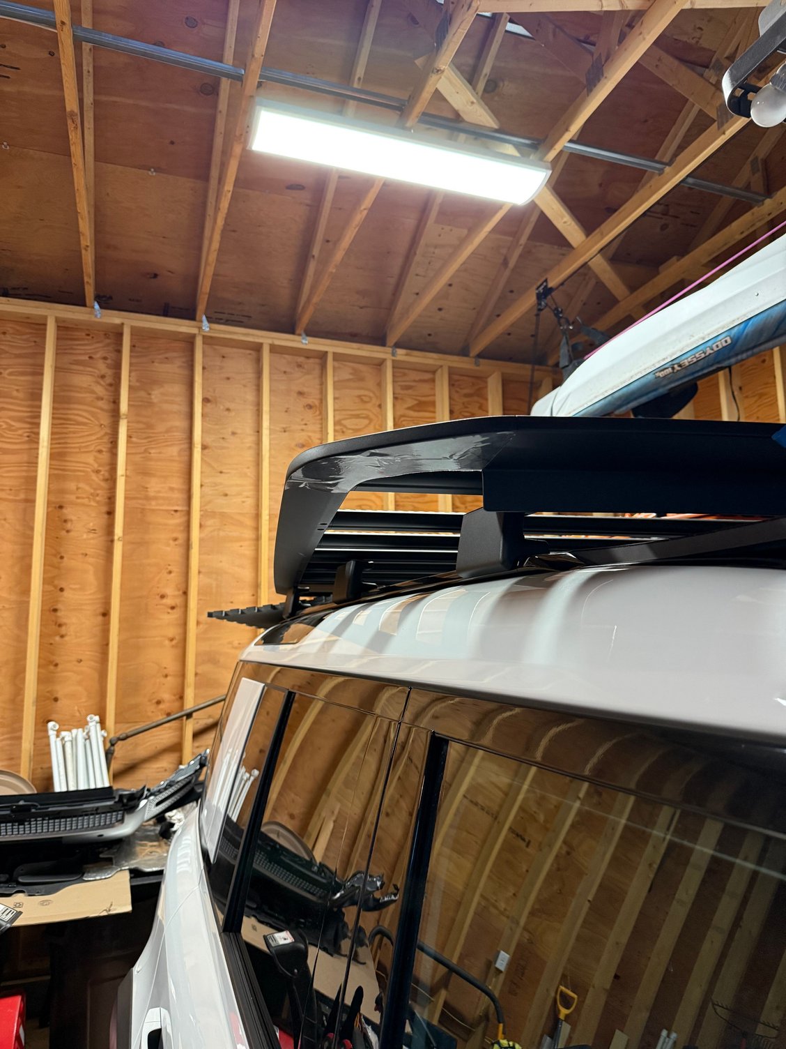

Added a lucky8 wind fairing this weekend. I had been looking at the Colorado Wind Fairing ones but have a TG road trip planned and the lead times were much longer. Not yet sold on it but seems like wind noise is down a bit. Its also not going to do anything to solve the crosswind problem or when i really load the rack up, which actually seemed to help the noise pre fairing,
I replaced some of the hardware so that the fairing is attached with black button heads vs silver zinc? bolts. Think it looks a little cleaner. I also took the 30 minutes to unbolt the rack and shift it to drill up from the bottom as the instructions / video have you drilling down from the top but then just leaving a hole on top because the bolts don't go all the way through. This would make more sense if they at least included a plug for that top hole but whatever. We'll see on Tuesday if it actually helps at all with gas milage.

It would be interesting to know, indeed. I've been getting 16 some MPG at best, and still wondering if this is due to short trips, or HVAC consuming a truckload because of extreme heat, or the roof rack and the ladder.
Side note - I'd be concerned about the wear the front edge (even with a rubber shim) impacts on the paint on the roof; no matter how rigid the whole structure is there will be micro-movement caused by wind and overall vibration, and together with dust inevitably accumulating between the rubber and the paint it will start eating a groove sooner or later, depending on your climate.
I'd love if someone with this fairing chipped in and confirmed or disproved this speculation.

I hadn't thought about the wear on the front edge but will be on the lookout. As for the MPGs I really am not expecting much. Even with the rack / winch / sliders i was still getting 19-20 on the highway. (P400) but yeah around town maybe I'll see an increase... the daily school run is pretty abysmal.
