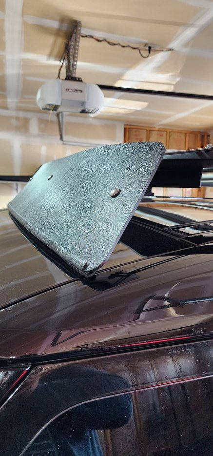

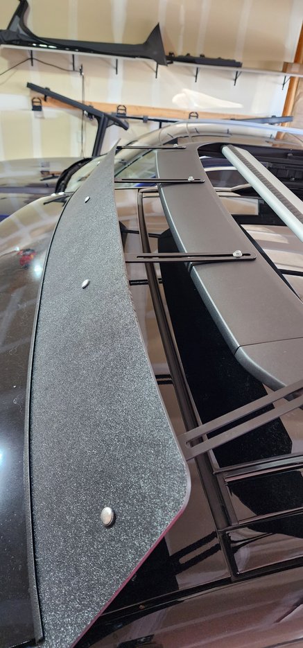

Here are some pics. You can see the big difference vs previous installs. The brackets are attached to the top of the rack vs through it. Not as aesthetically pleasing, but not noticeable to most I'm thinking.
