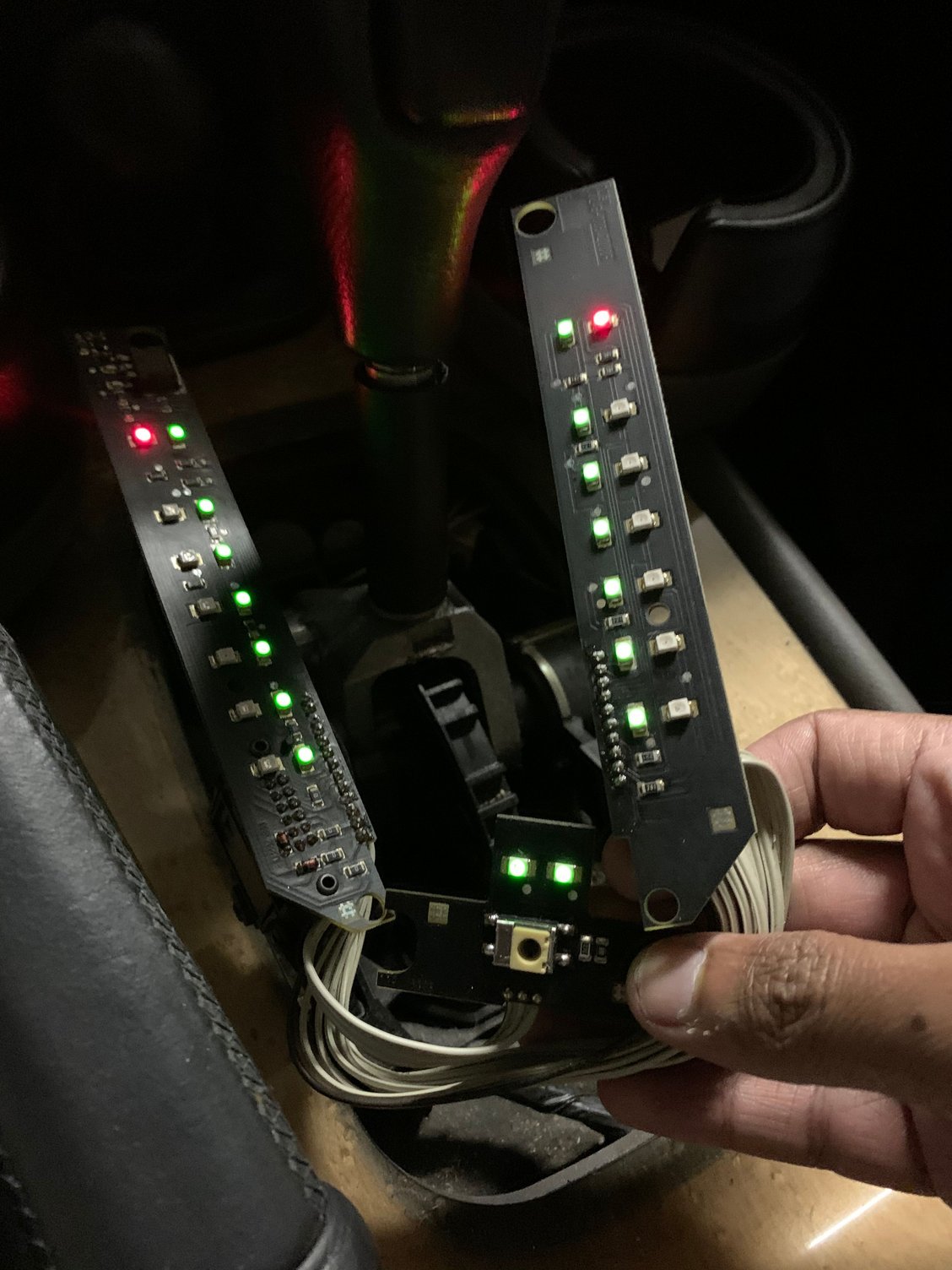

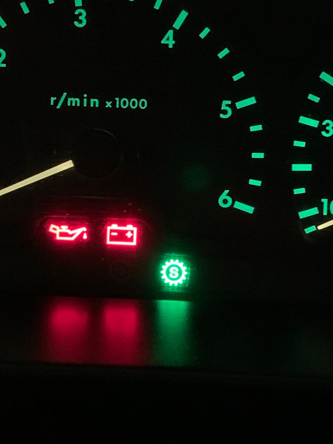

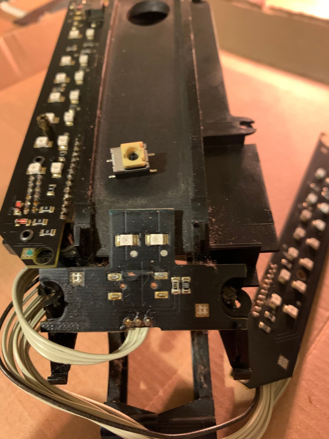

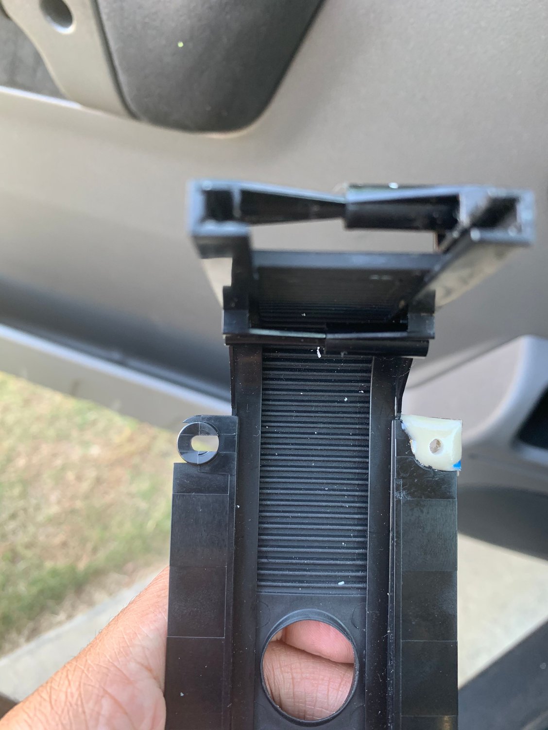

Fixed my broken sport mode button today. It felt like it wasn’t clicking so I thought maybe something was misaligned. The button fell off at some point - glad it was still there. Some soldering & jb weld later, we have sport mode back. Doubt I’ll ever use this, but nice knowing it works.
Jb weld is great, but need to find some replacement center console parts. My button still doesn’t click great due to some plastic tabs.

You can usually find the shifter bezels online for a decent price off of Ebay. Paul Grant, and Will Tillery are also great sources for used parts.

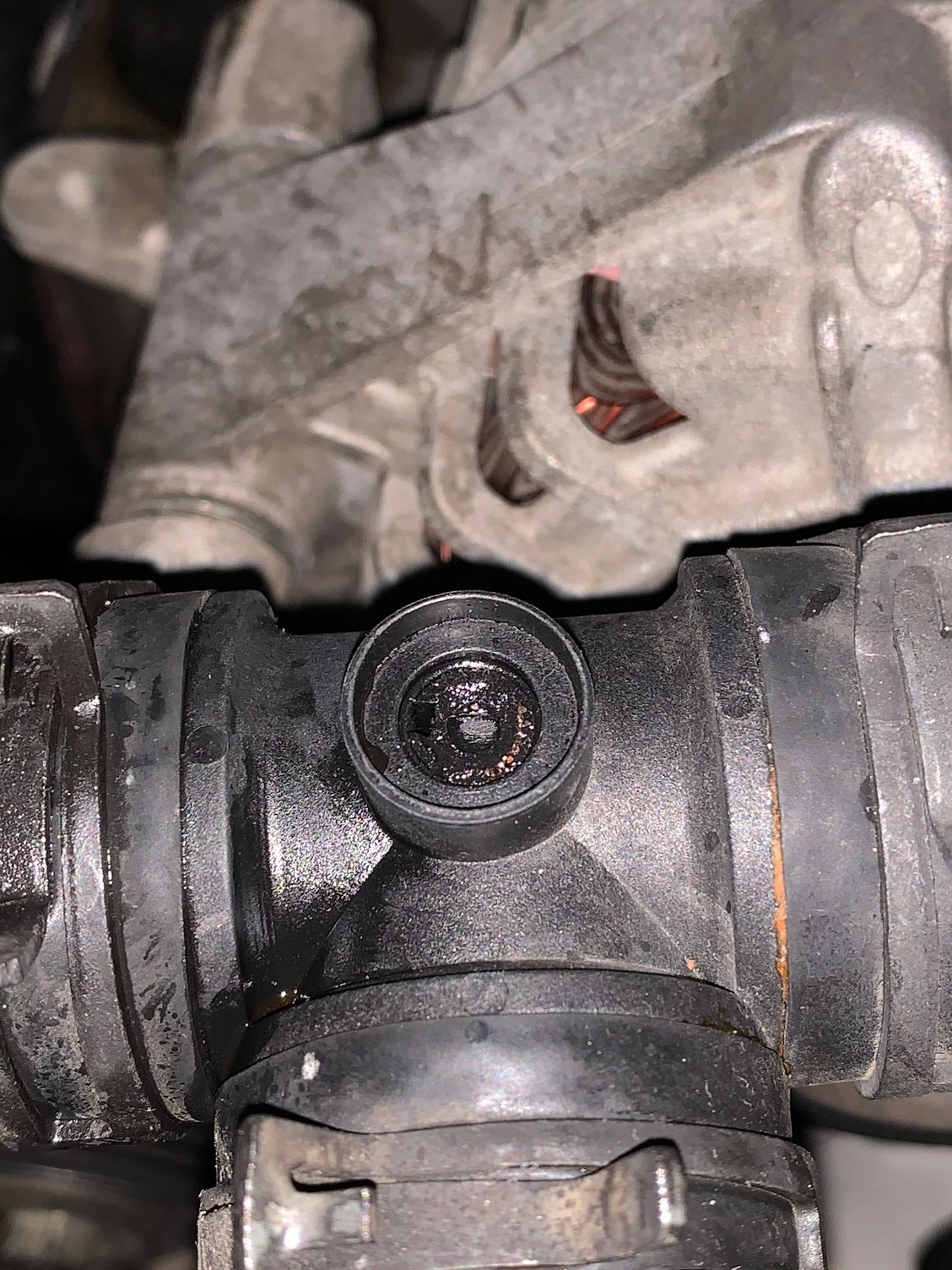

Took a little joy ride and stepped out of the car to realize I’d left a trail of coolant...
was watching my UltraGauge so no harm done - it was a short drive.

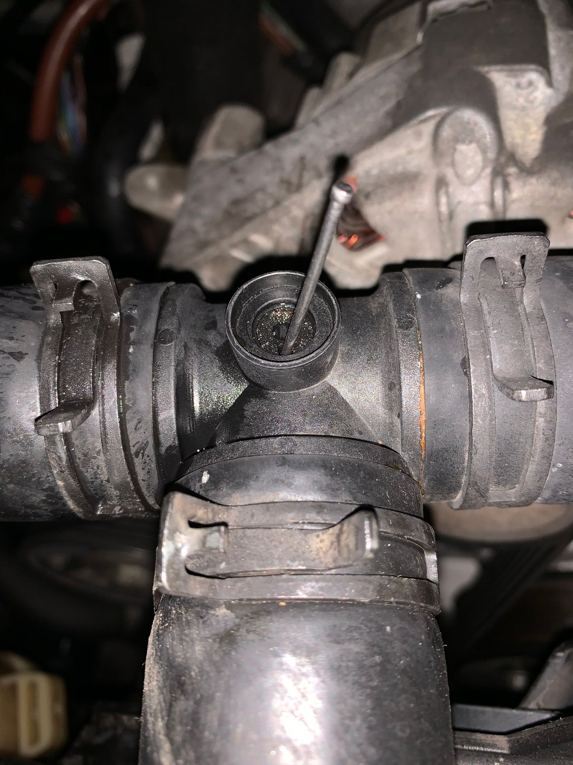

I’m not sure if I overtightened the bleeder screw, if it was just old or both, but it looked like the spray was coming from there. I tried removing it and see this.

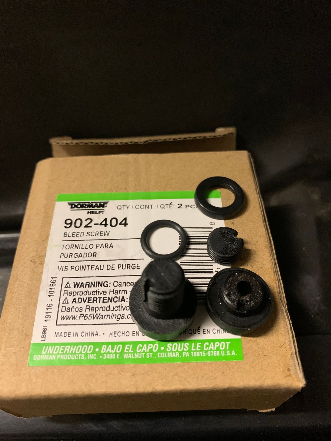

I thought this was the end, but thankfully these screws have a small channel that just about fits a small nail. I found a bmw part listed on the forum and autozone had their dorman version.
Anyone know if this is a bad idea? I swapped out the rubber oring for the original larger one. The only other difference is the length of the screw but hardly noticeable.
Now I just need to figure out what coolant was previously in here. I bought some peak pink, but don’t want to risk mixing something with dexcool.
Part: left bmw bleeder screw vs right lr broken screw.
