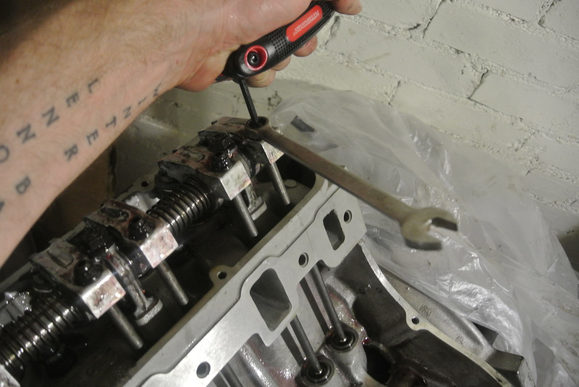

i did have a chance to adjust the rockers. easy enough in this set up. didn't really take long
- @tdc, tighten rocker adjustment while spinning pushrod.
-when it becomes difficult to spin, tighten 1/4-1/2 a turn more.
-tighten down the lock nut @25ftlbs

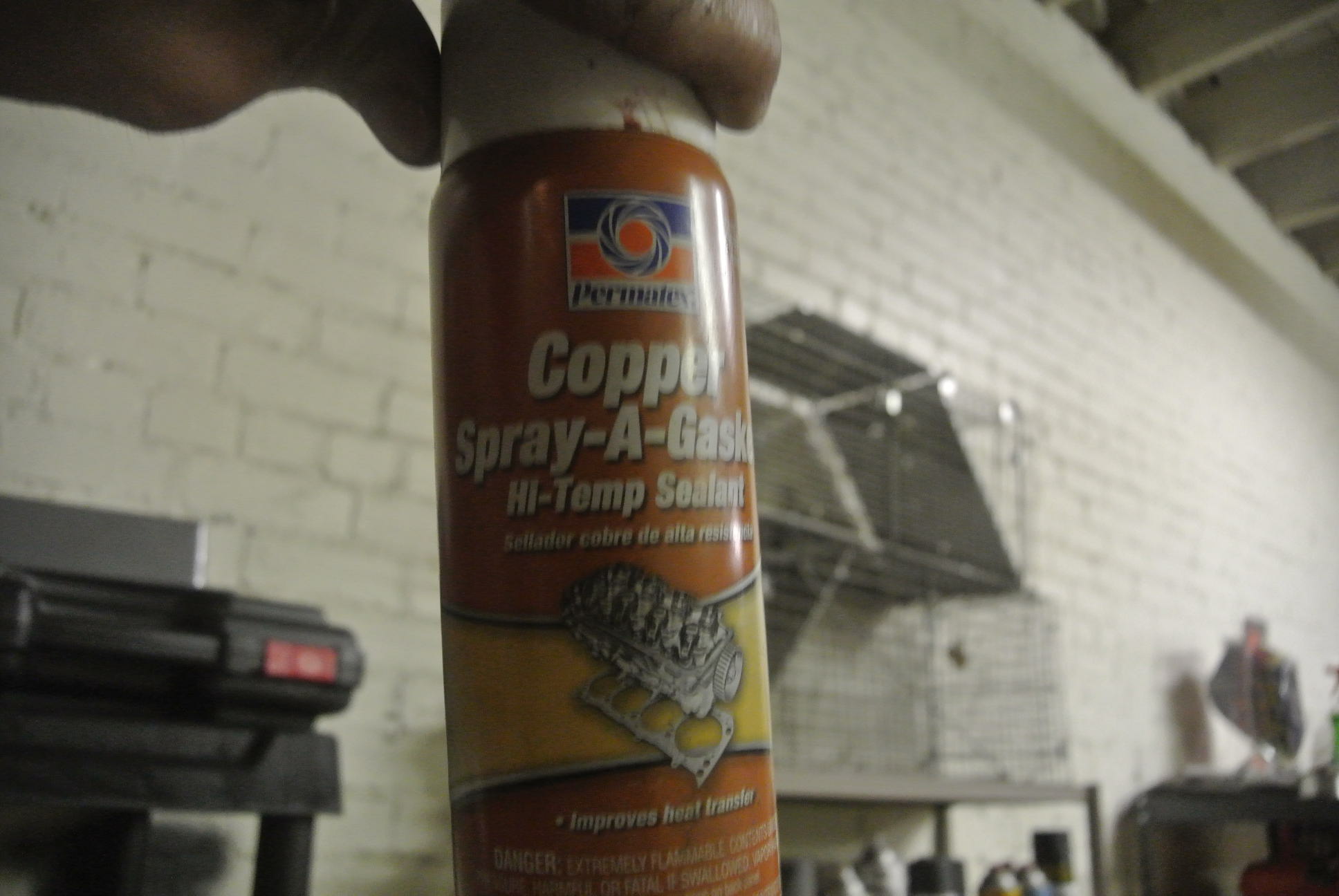

also finished gasket matching. using a copper cote covering, on gasket and test assembly leaves a perfect outline of the mounting faces. the copper spray leaves a clear edge imprint.

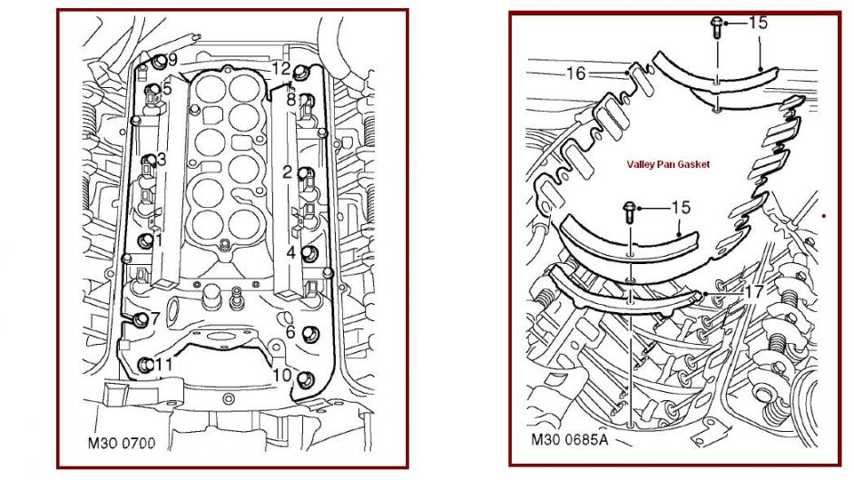

Default this look right?
had trouble accessing the proper location in rave, for torque of the lower....dunno what i did with my cd, so i am web pdfing and still no luck.
web search turned up this. look right?
picture of sequence and
intake bolts @7lbs
end clamps @13lbs
final intake bolts @ 38lbs
intake bolts @7lbs
end clamps @13lbs
its how i did mine, though on the ends i did 15 lbs as thats the lowes my torque wrench went.

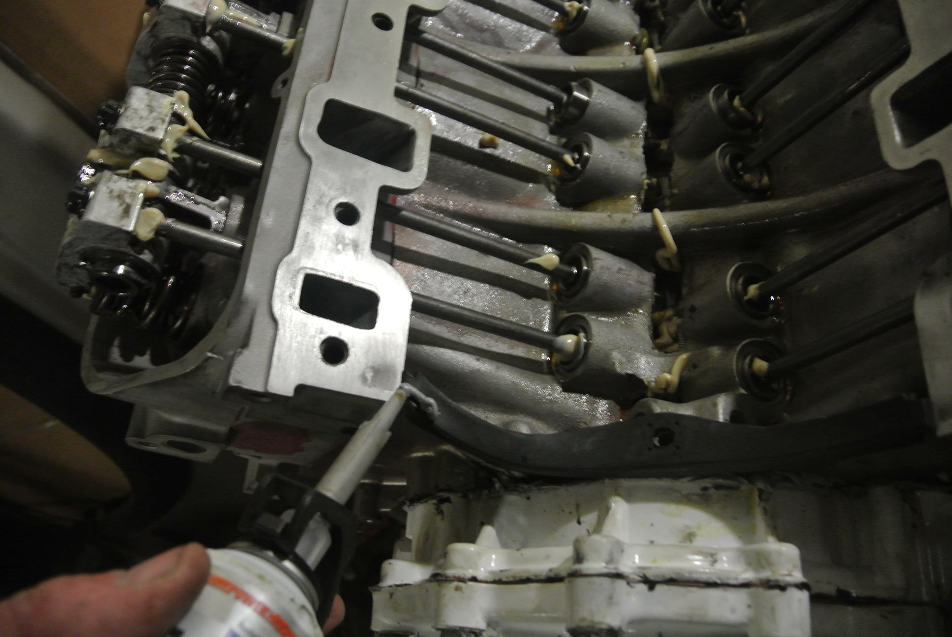

dropped the lower im
goo in the rubber gasket , for any head gasketeers.
