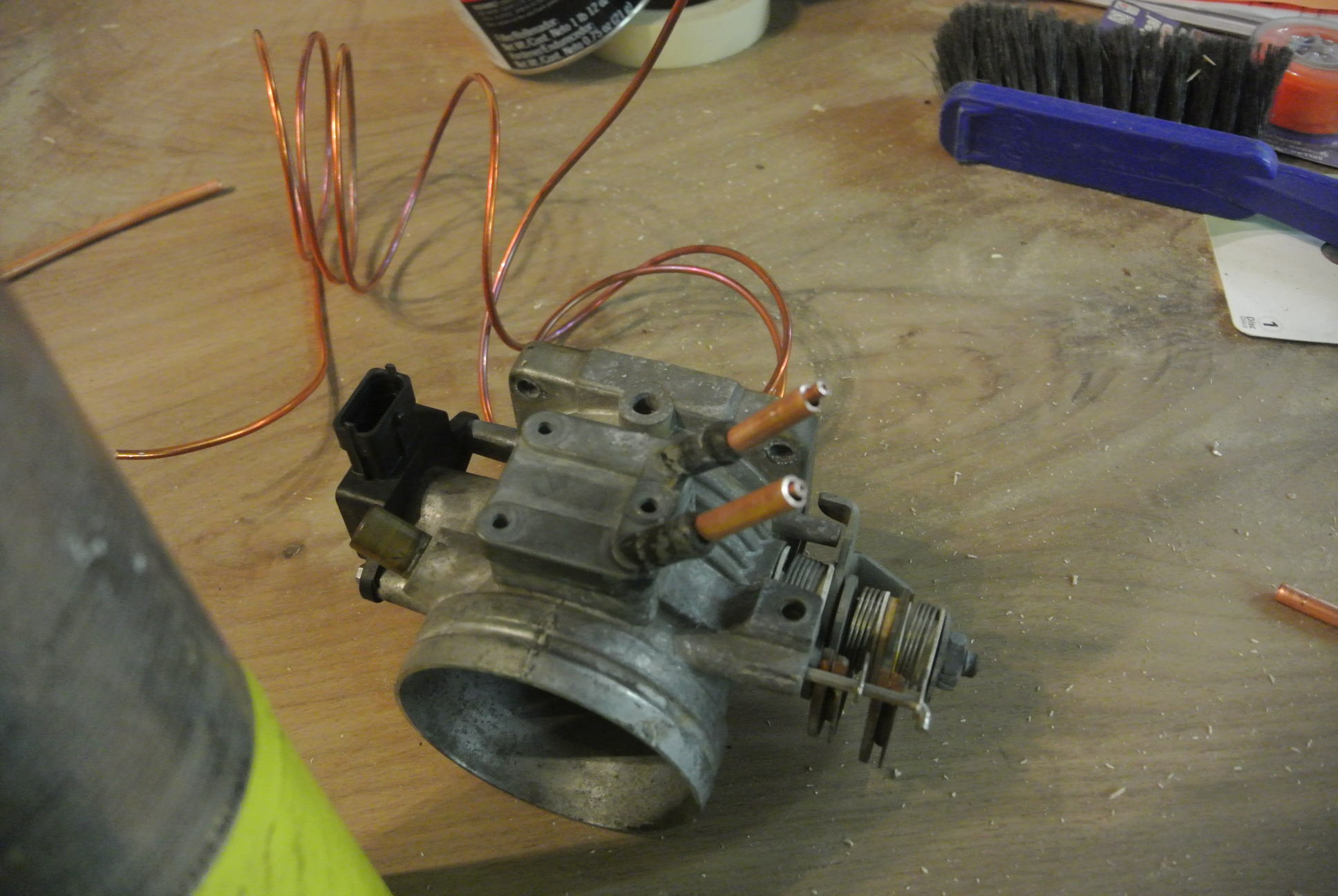

Default throttle body heater ......my solution!
so i have a 1/8 " copper line, fitted to the heater. it goes through the input / output. then i have soldered some small 1/4 pieces on. now i can double clamp the tbh and new 1/4". this excludes the gasket and tbh, all together......but still produces heat for the throttle body..

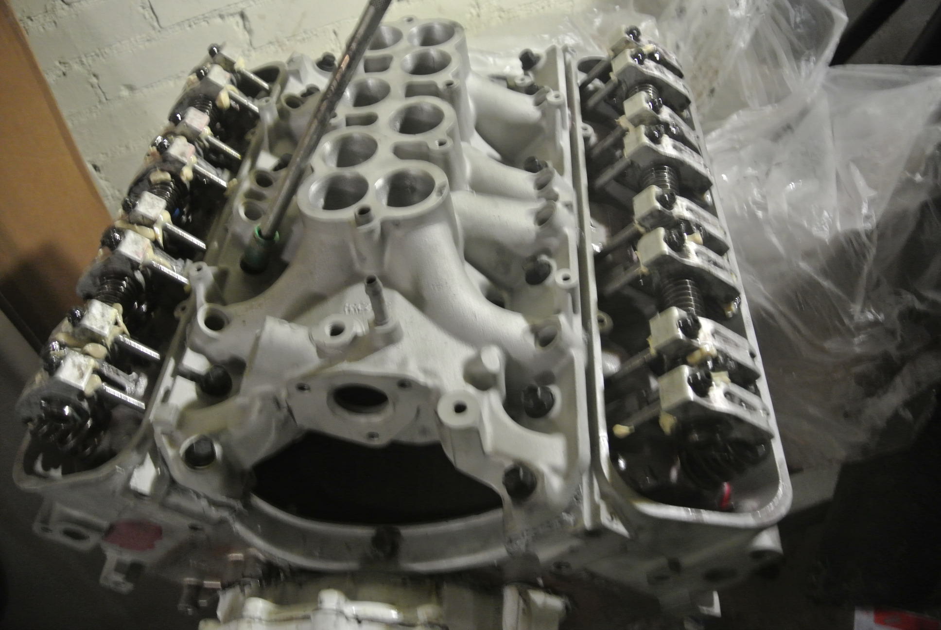

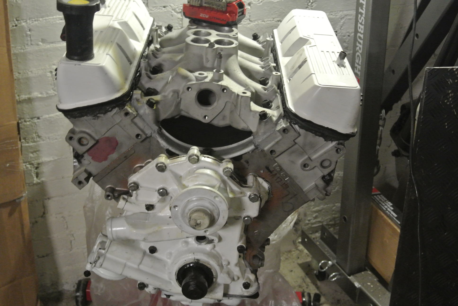

had to use spacers for the rockers.

get closer,
I had a lot of problem with the TBH until i dress the bottom with a file, so far so good.

also should have mentioned that i purchased spacers and rockers from v8tuner. (good folks, very helpful)....they supplied longer valve cover bolts. they are stainless and i now get to use a 3/16 hex to tighten.
for standard size they also had an option of a thumb screw.
Old Mar 27, 2015 | 10:31 AM

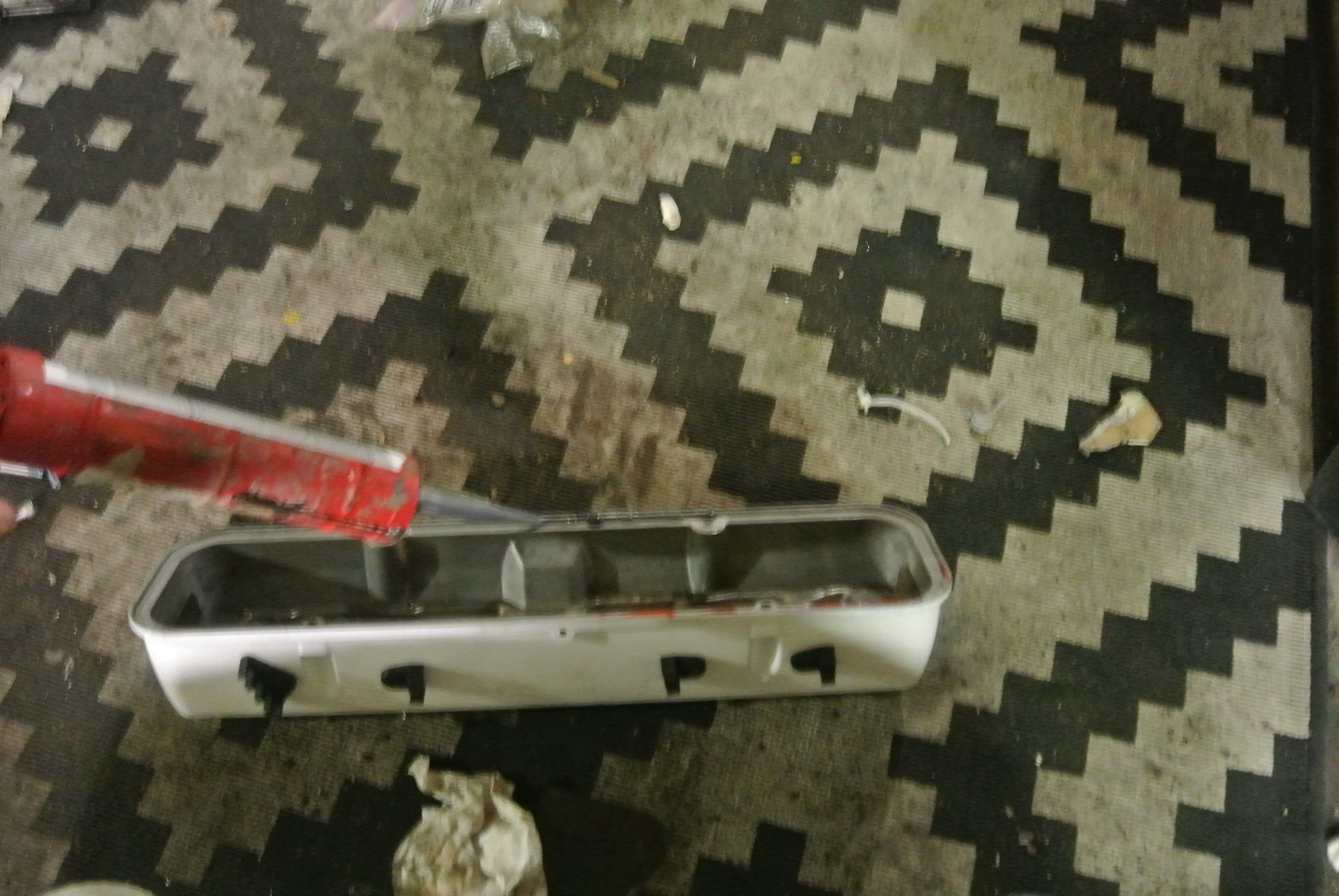

if you look at the valve cover finished, it looks like a brick mason set them with $9 worth of rtv........
so, they will not leak. i just hope i don't need to adjust the rockers after i get it going
