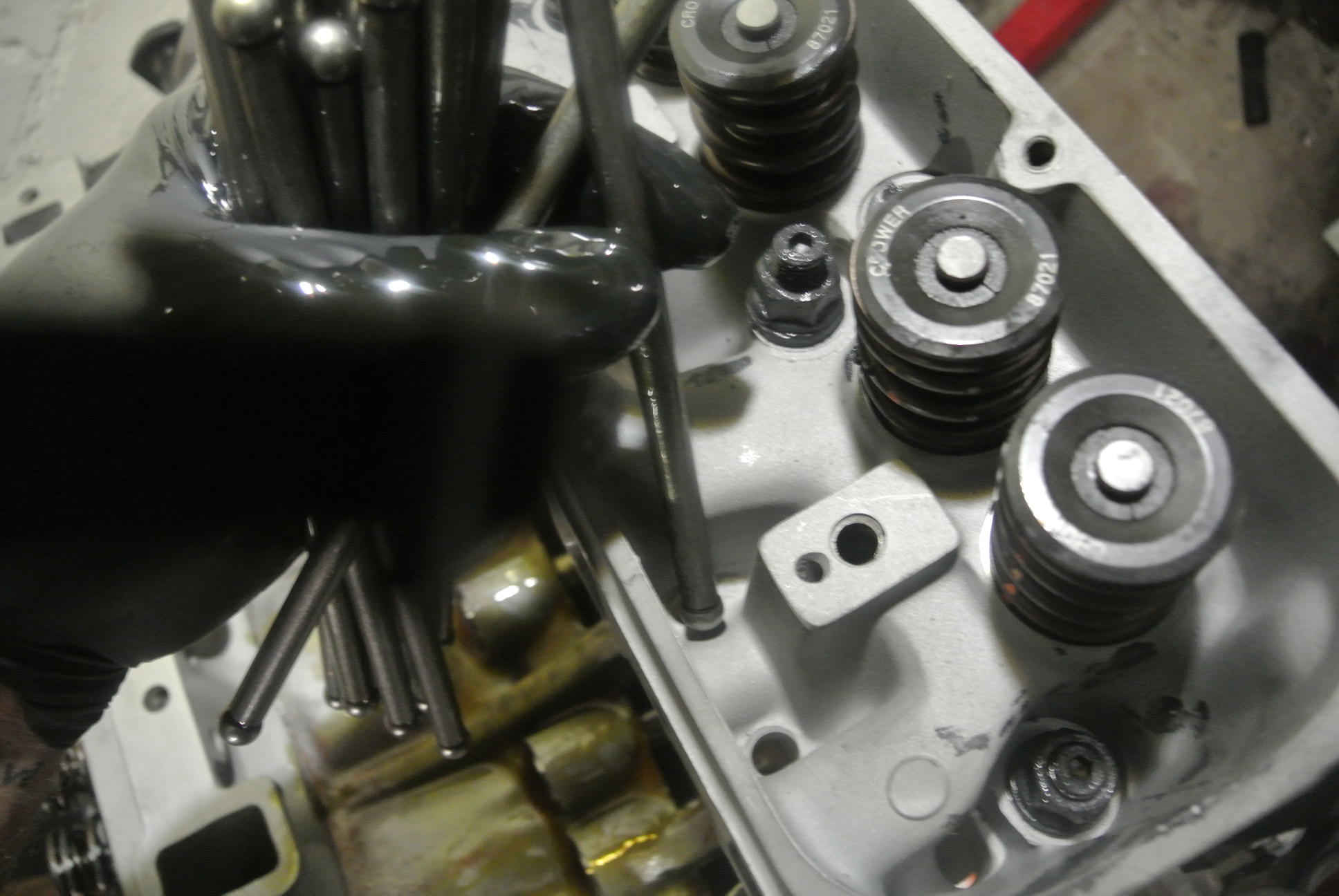

dropped in the rhoads bleed down lifters. interested to know if these actually do anything.
5/16 chrome molly push rods. I had to clearance the passage a bit.

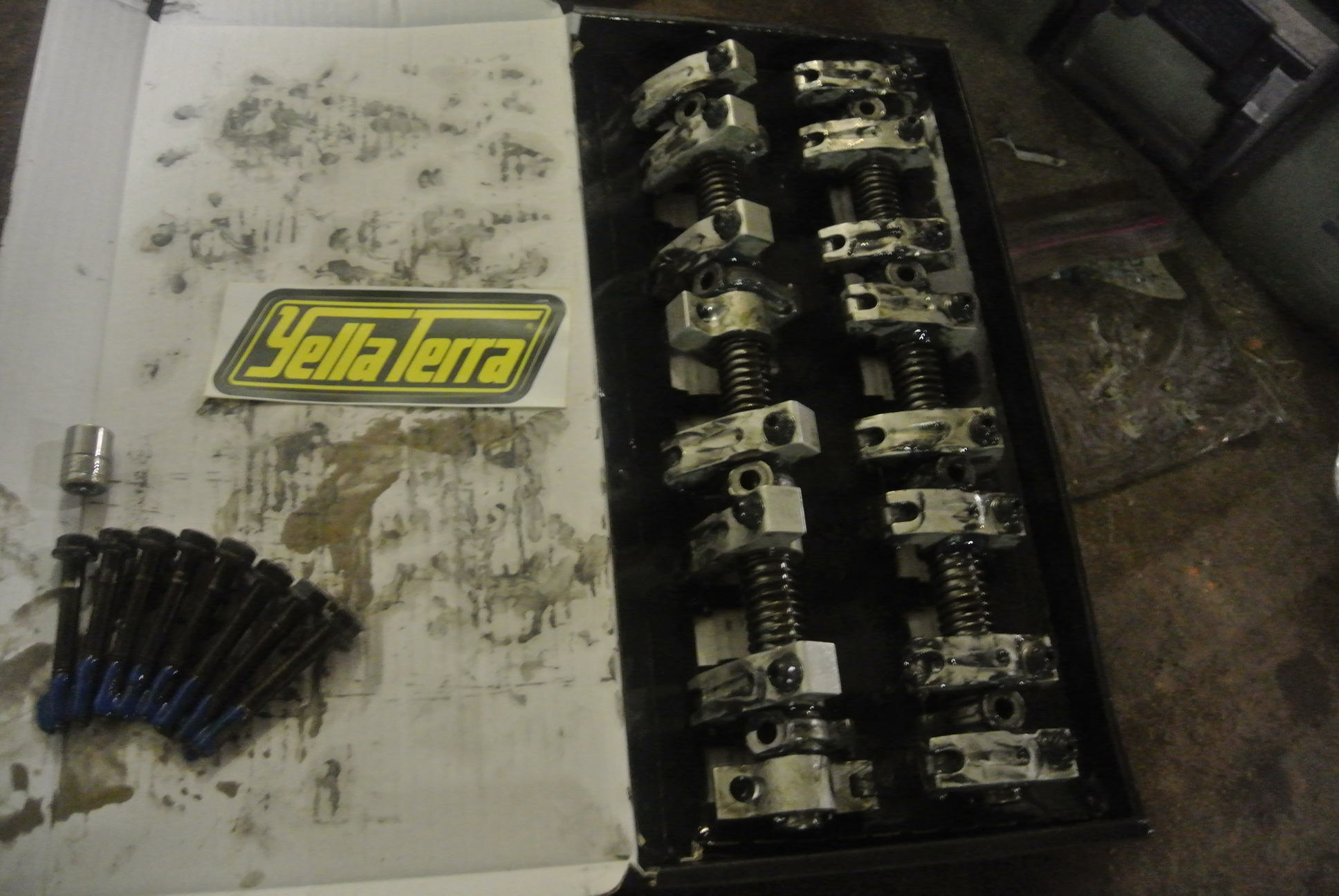

installed my yella terra roller rocker assemblies. this I am excited about because less friction always makes more power. still have to adjust them

rhoads anti pump-up lifter are usually use with a somewhat radical cam, so you can don't have to worry about valve-train float they are help you maintain vacuum need for accessory.
But the last set i put in was in HS in 1977 they may have change since then, btw those lifters are still in an engine being used now.
I see you went with roller rockers why? doesnt the ECU have like a 5800 rev limiter? or was it just for noise?

Noise and friction reduction on rockers. Friction reduction being the main goal.

i originally planned to do stud mounts, but after research i had a change of heart. the stud mounting allows for the use of any sbc roller rocker and is super cheap in comparison to the yella terra.
my problem was with the oiling through the push rod. while it is a great technique and very efficient..... with the spring rates and changes, i wanted the strength of a solid push rod more. so I coughed up the cash for the only shaft mount roller rockers that are made for these.
