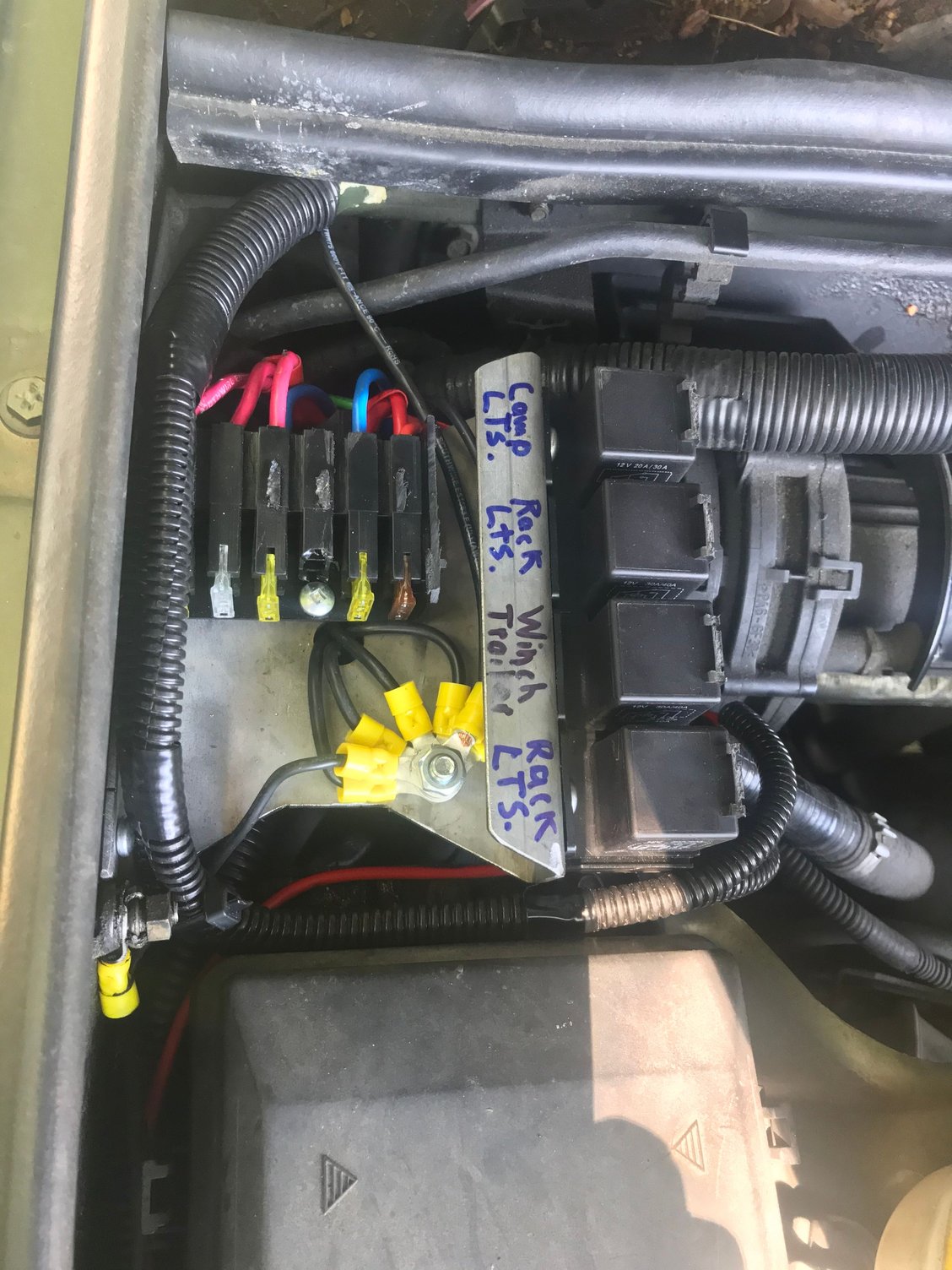

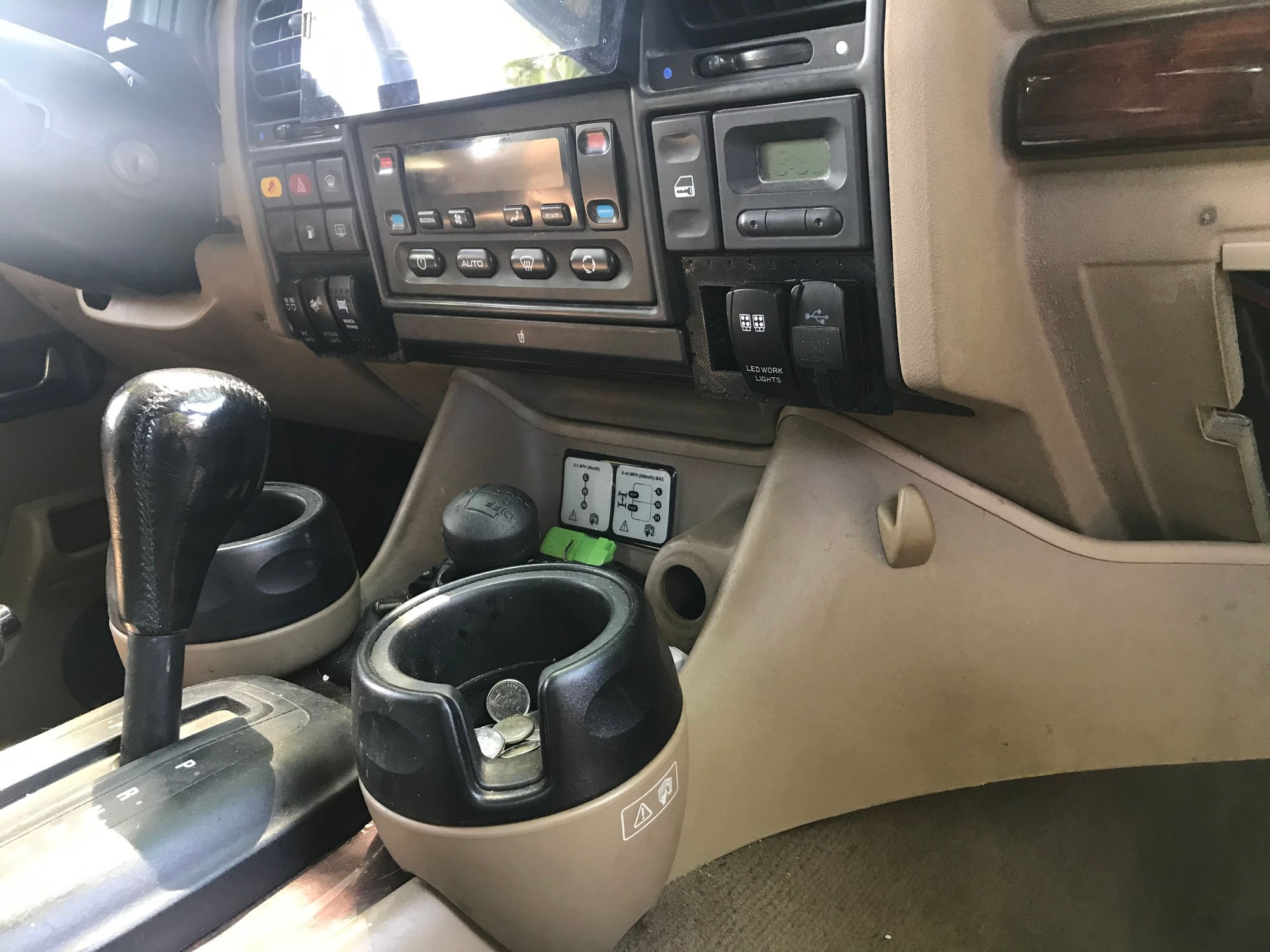

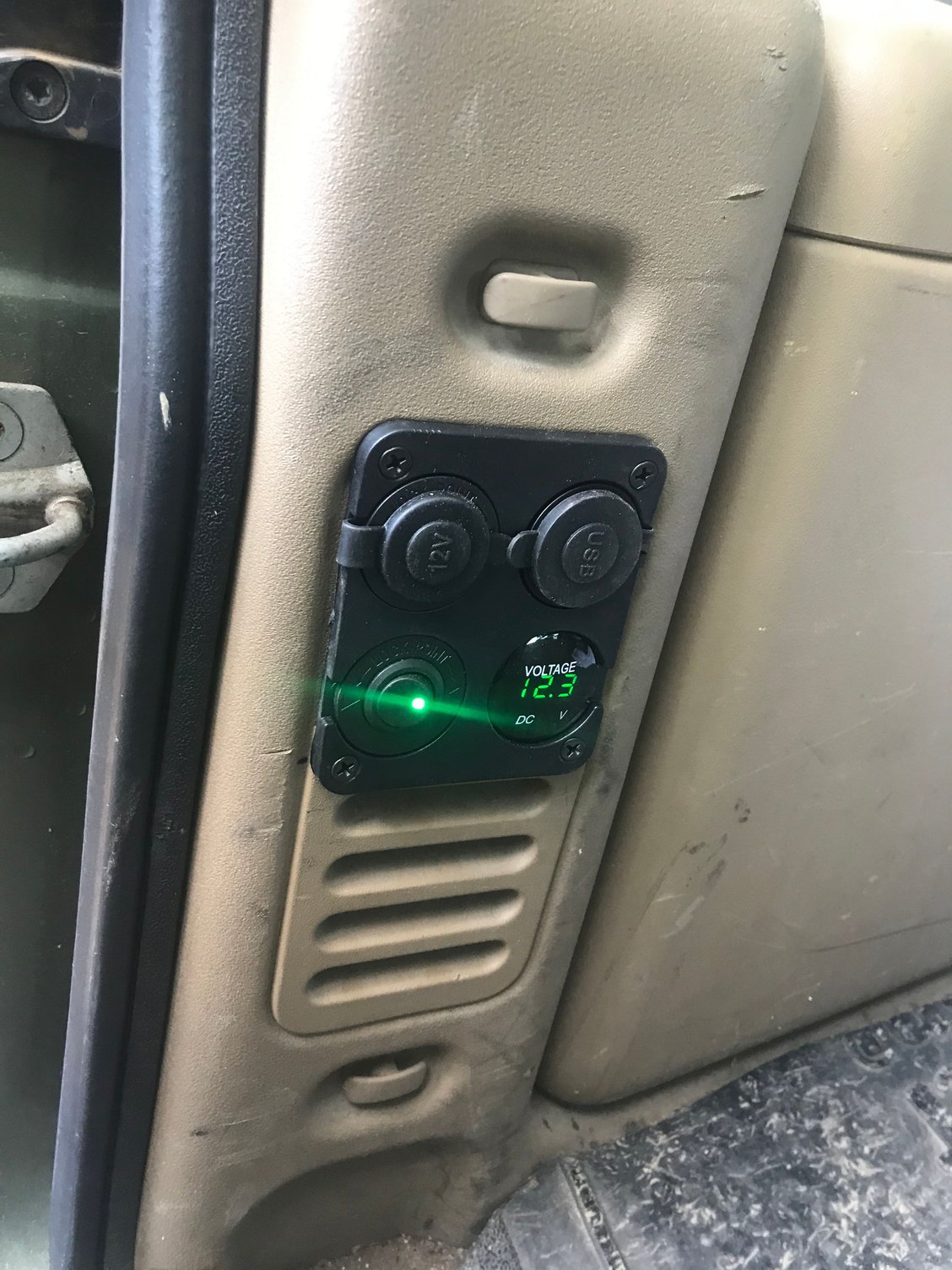

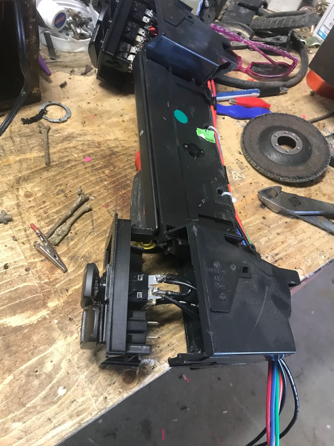

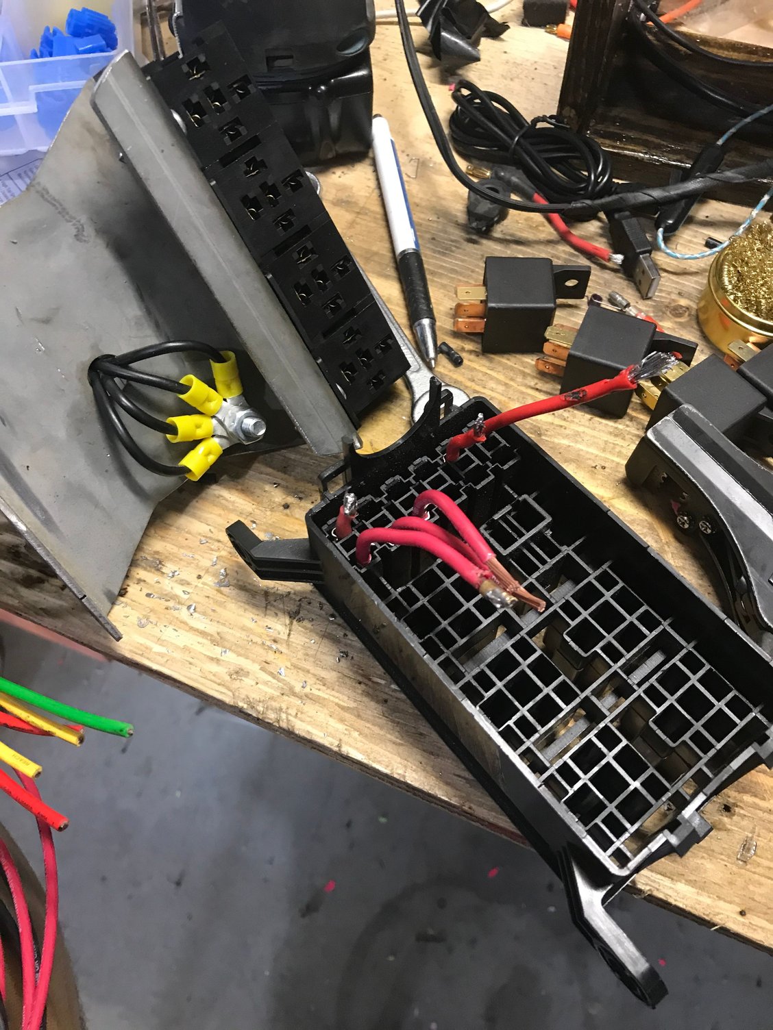

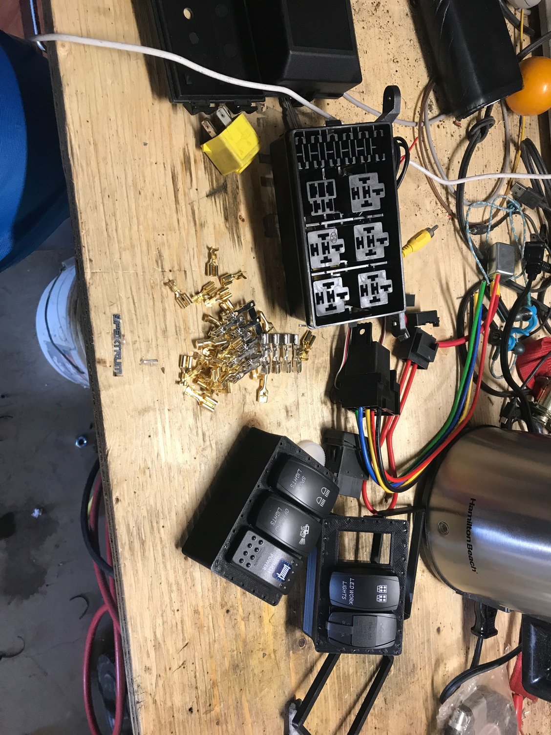

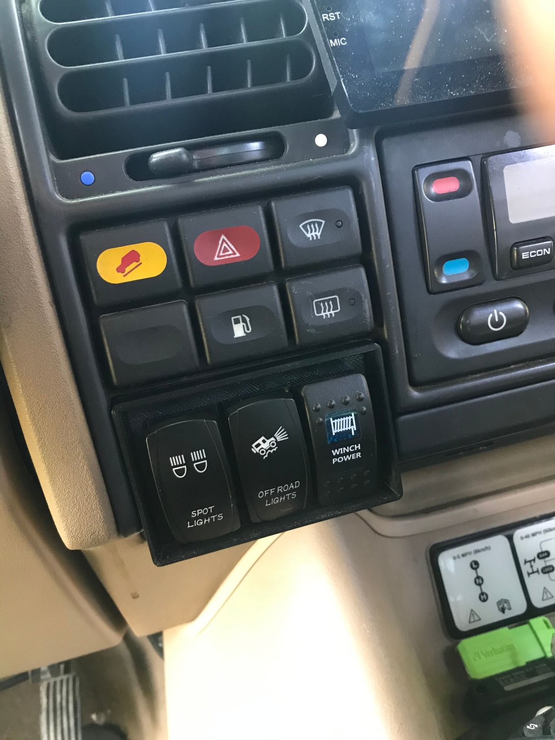

Thanks. I’m on vacation for 2 weeks so I’m getting some projects done. I’ll post some pics tomorrow, I finished the switches and new wiring harness. I had originally bought a diy fuse and relay box that I had started to build but it was ****ty quality so I made up my own with relay pigtails mounted to a steel plate, I salvaged the fuse holder portion and attached that. Soldered and heat shrimped all the joints except the ground eyelets. Those I’ll coat in worm wool oil.
I pulled that eBay head unit and reinstalled the factory stereo for now. I think I need to change the wiring for it, it would not shut off for the last few weeks. Finally killed my battery. I had forgot to pull the fuse last weekend.
Plastic junk from eBay on the right.

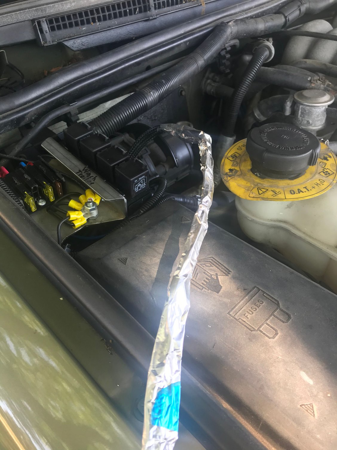

Installed reflective tape to protect against the header heat
My homemade fuse/relay panel

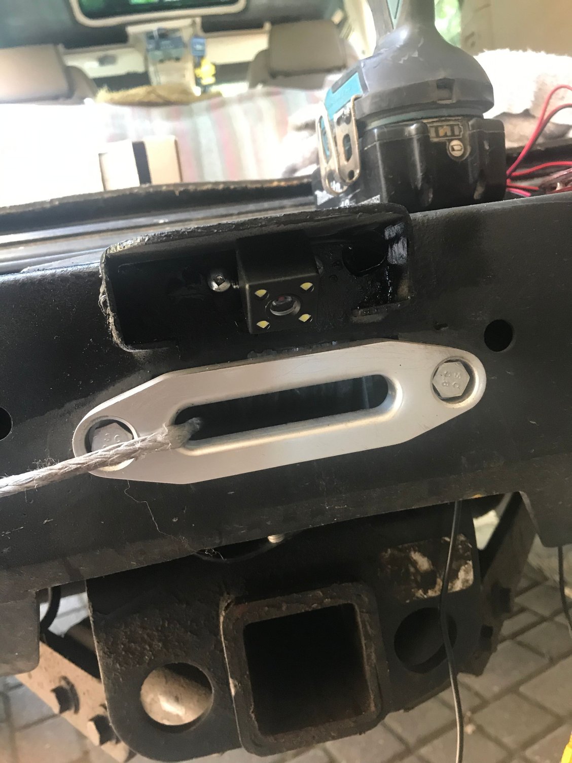

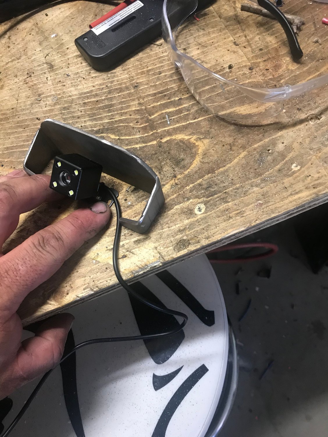

Making up a guard for a rear view camera
Installed the guard

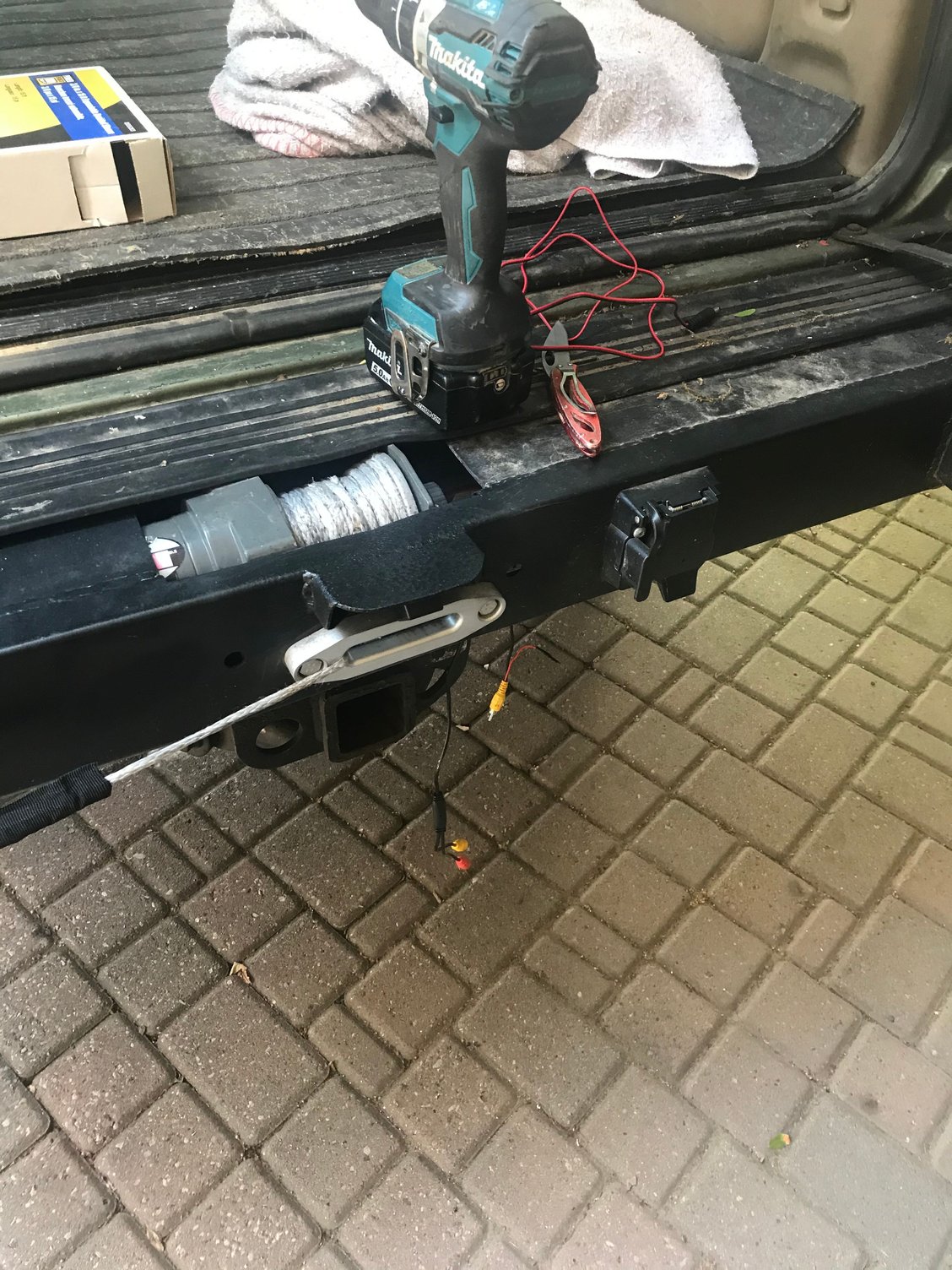

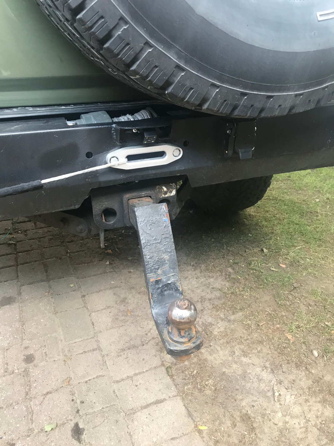

Rear camera mounted under guard
Close up of camera
Finished view of camera , should make 1 man trailer hookups a little easier I hope
Moved their power panel to the rear cargo area

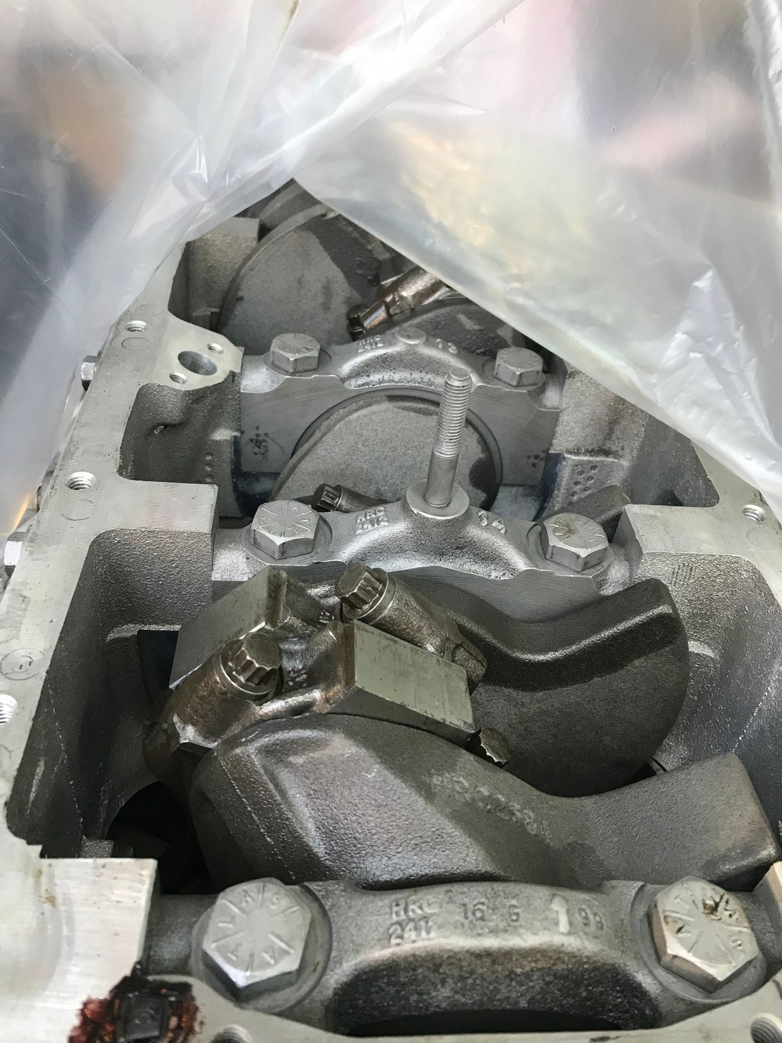

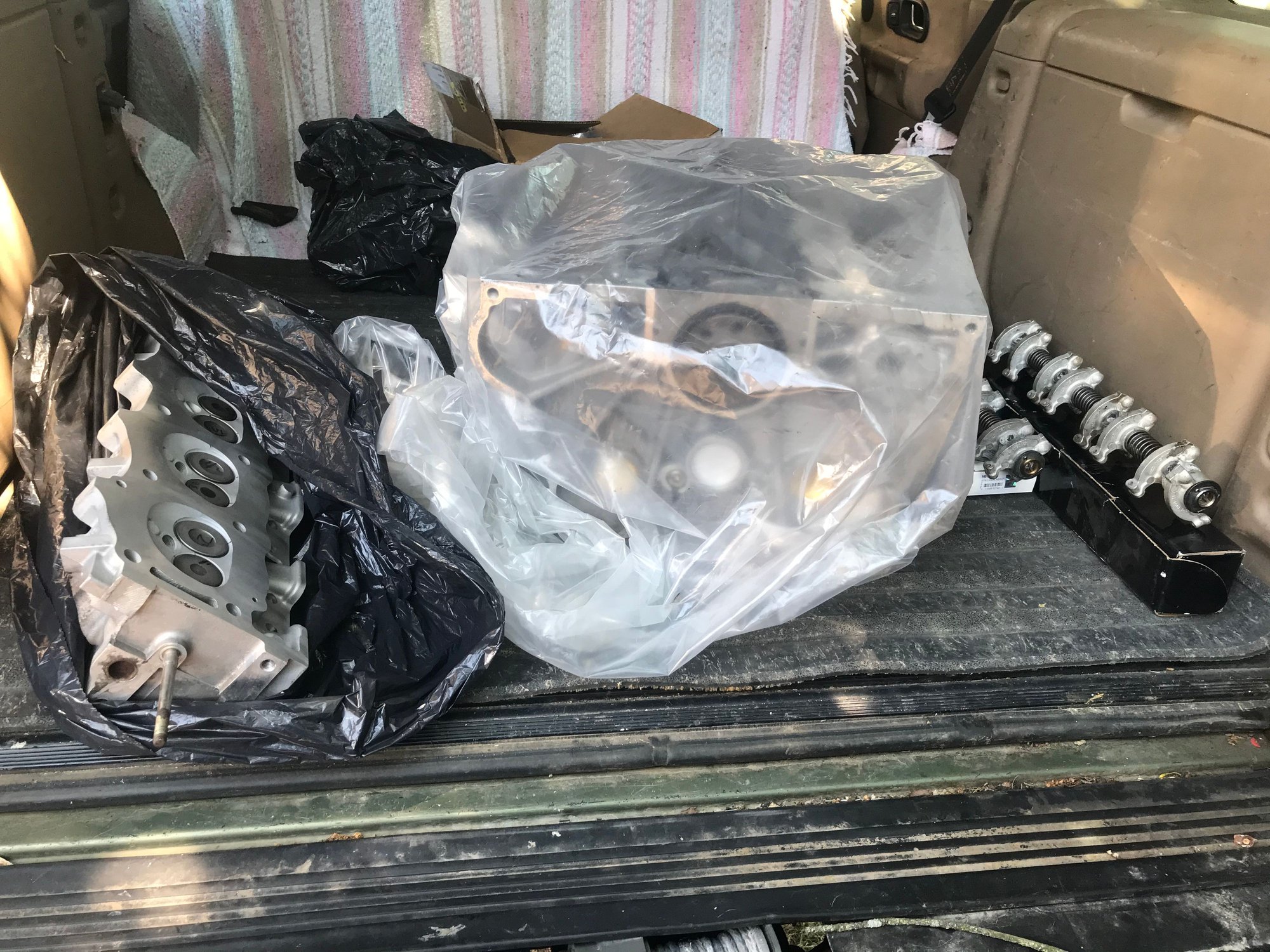

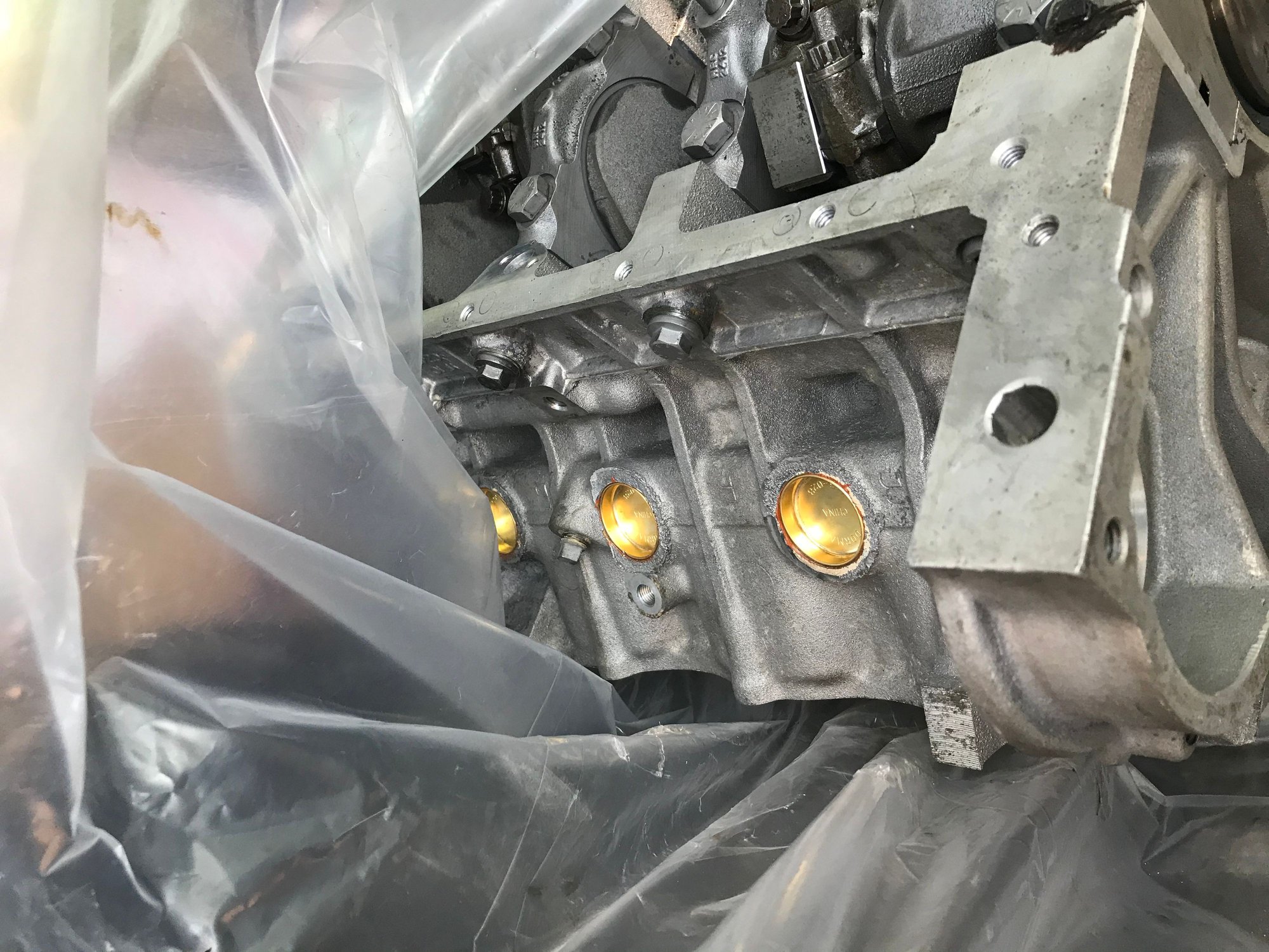

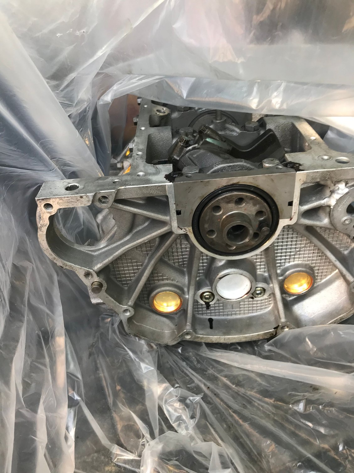

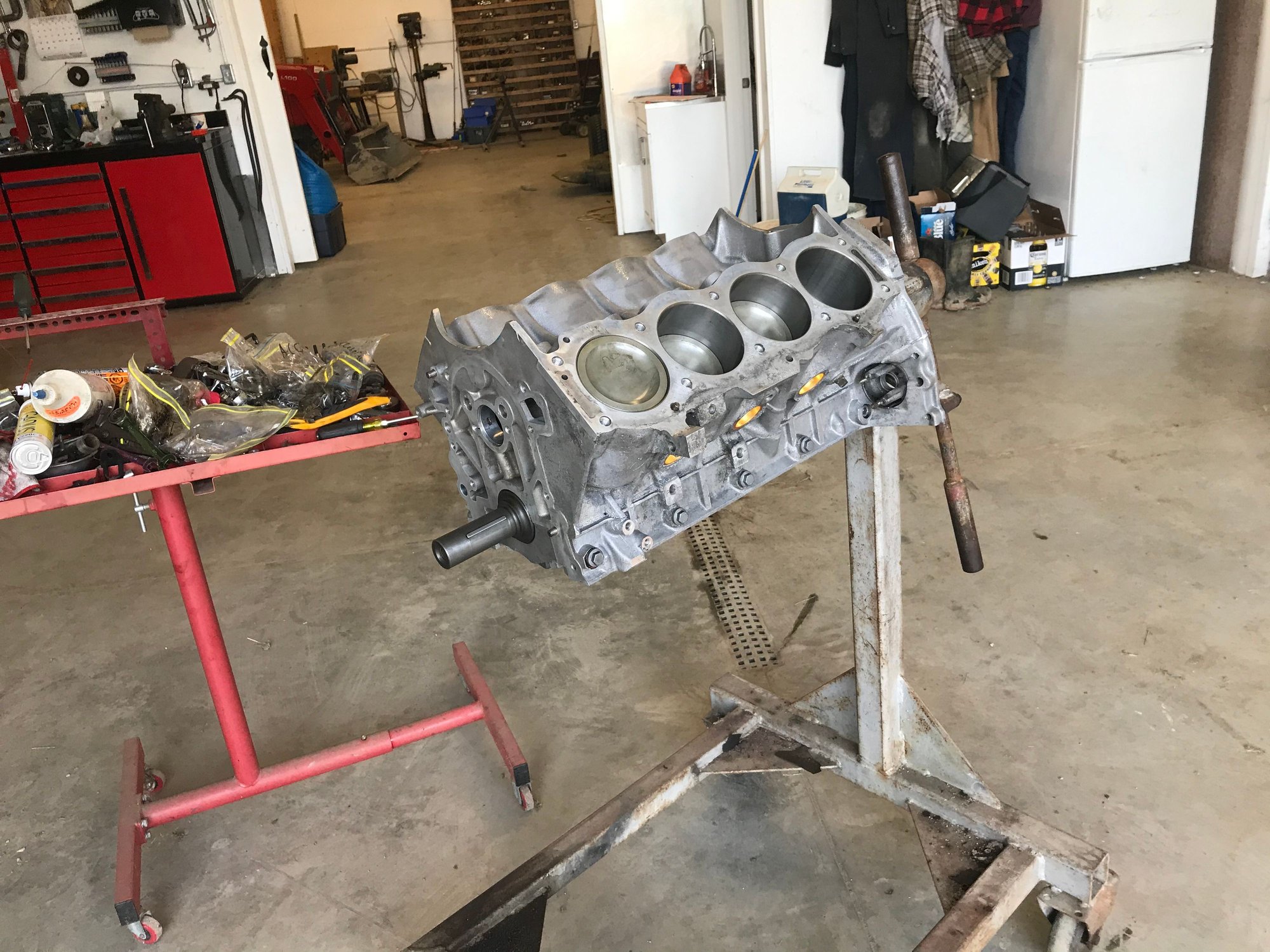

Well it’s been almost a year since I dropped this motor off at the machinists. I finally got it back today. I still have to go through the rocker shafts, install the cam, heads, timing chain, pump, etc. But at least it’s back and looks pretty good.

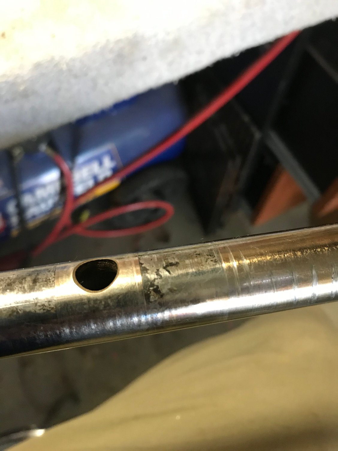

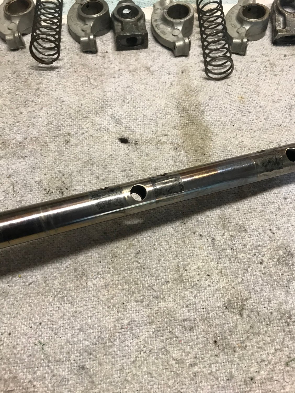

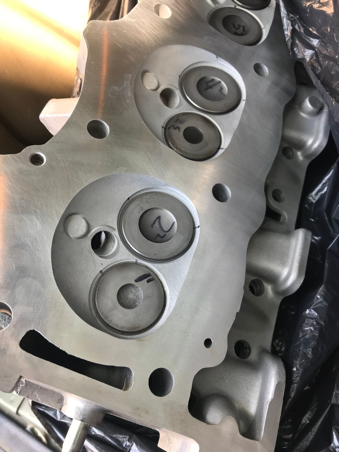

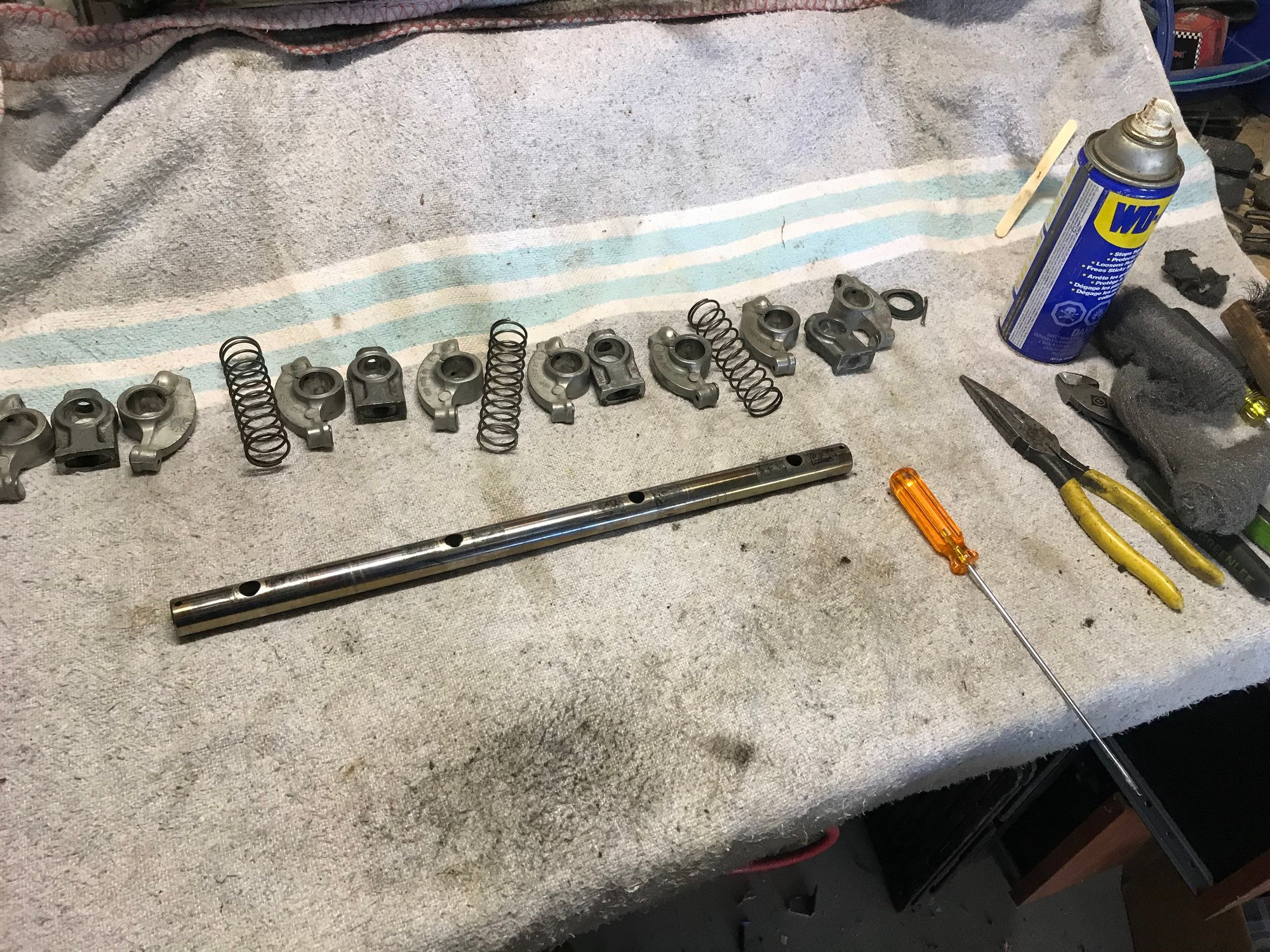

Well the rocker shafts look like they’re done.
I don’t think I’ll reuse these. I’ll check the ones out from 4L when I pull it. Hopefully they’re in good shape

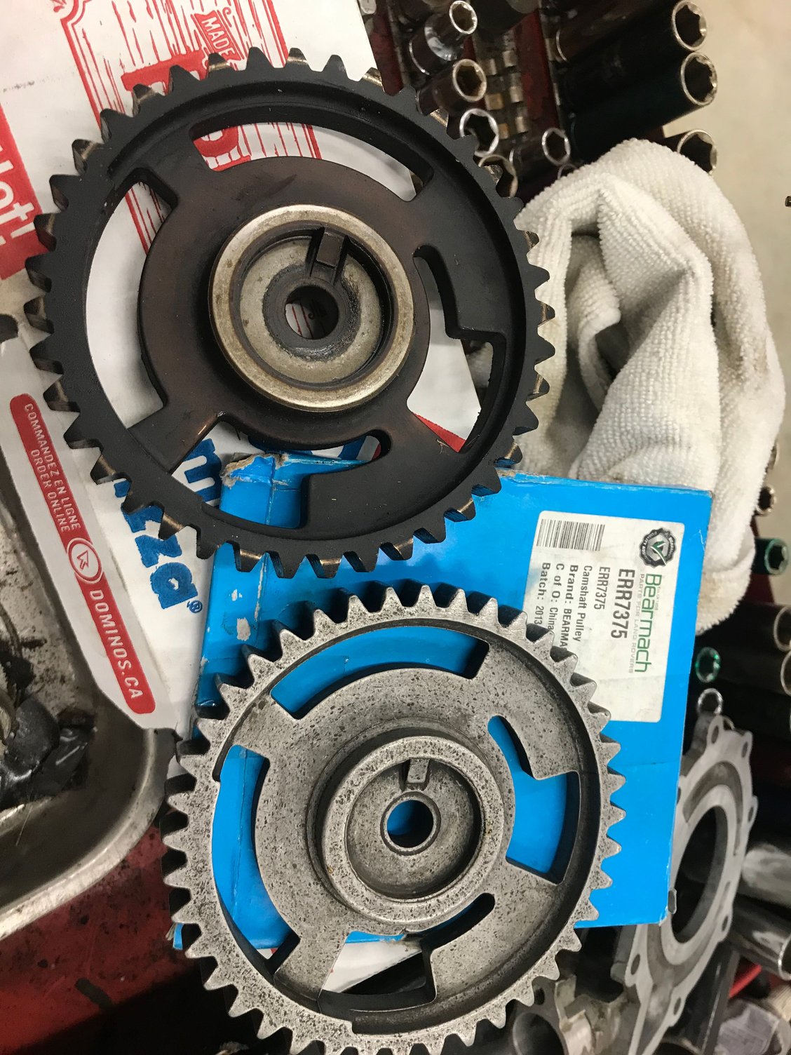

I’m now also leary about these bearmach timing wheels. They are not machined where they bolt up to the cam. Anyone have experience with these?
