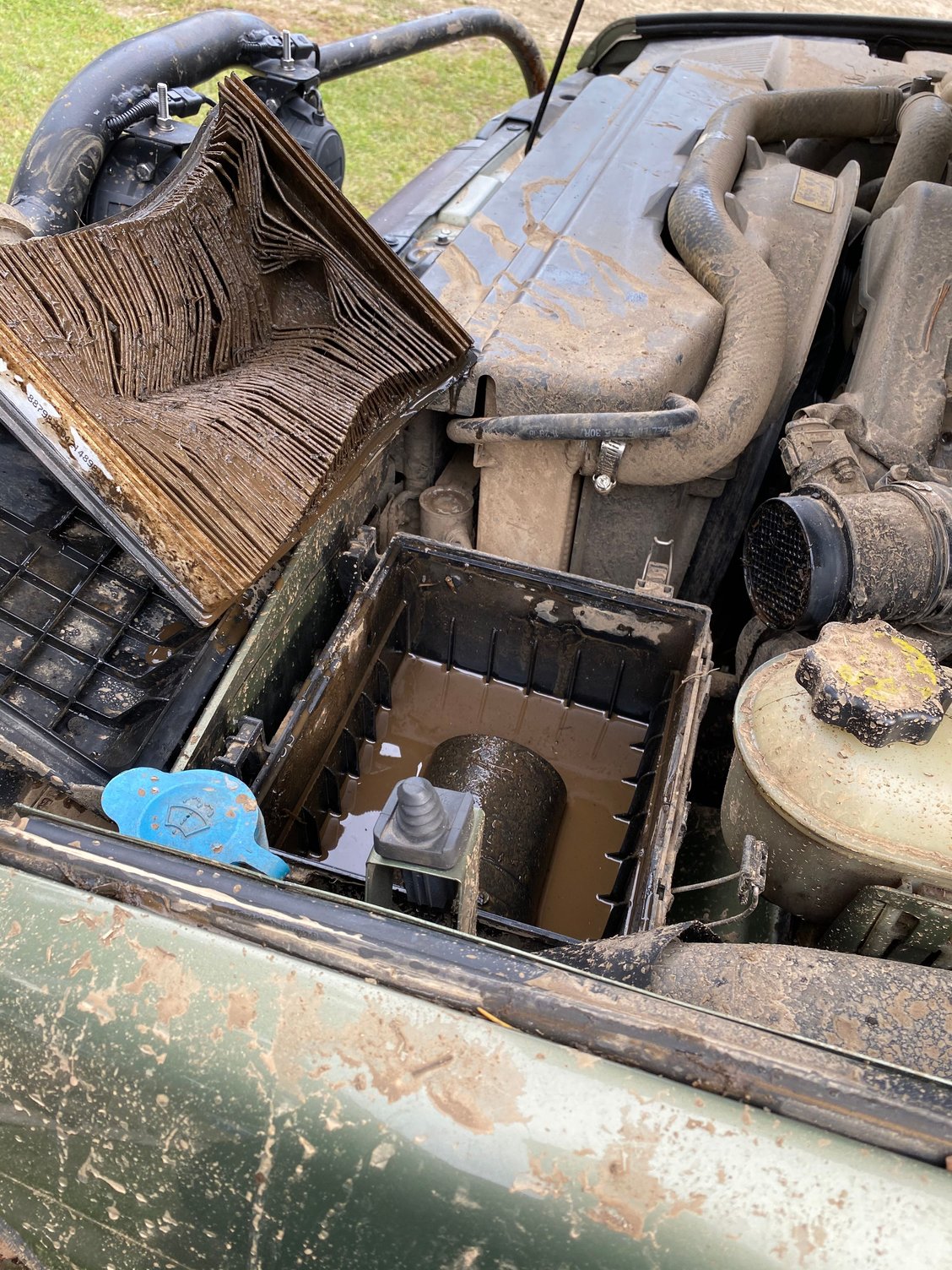

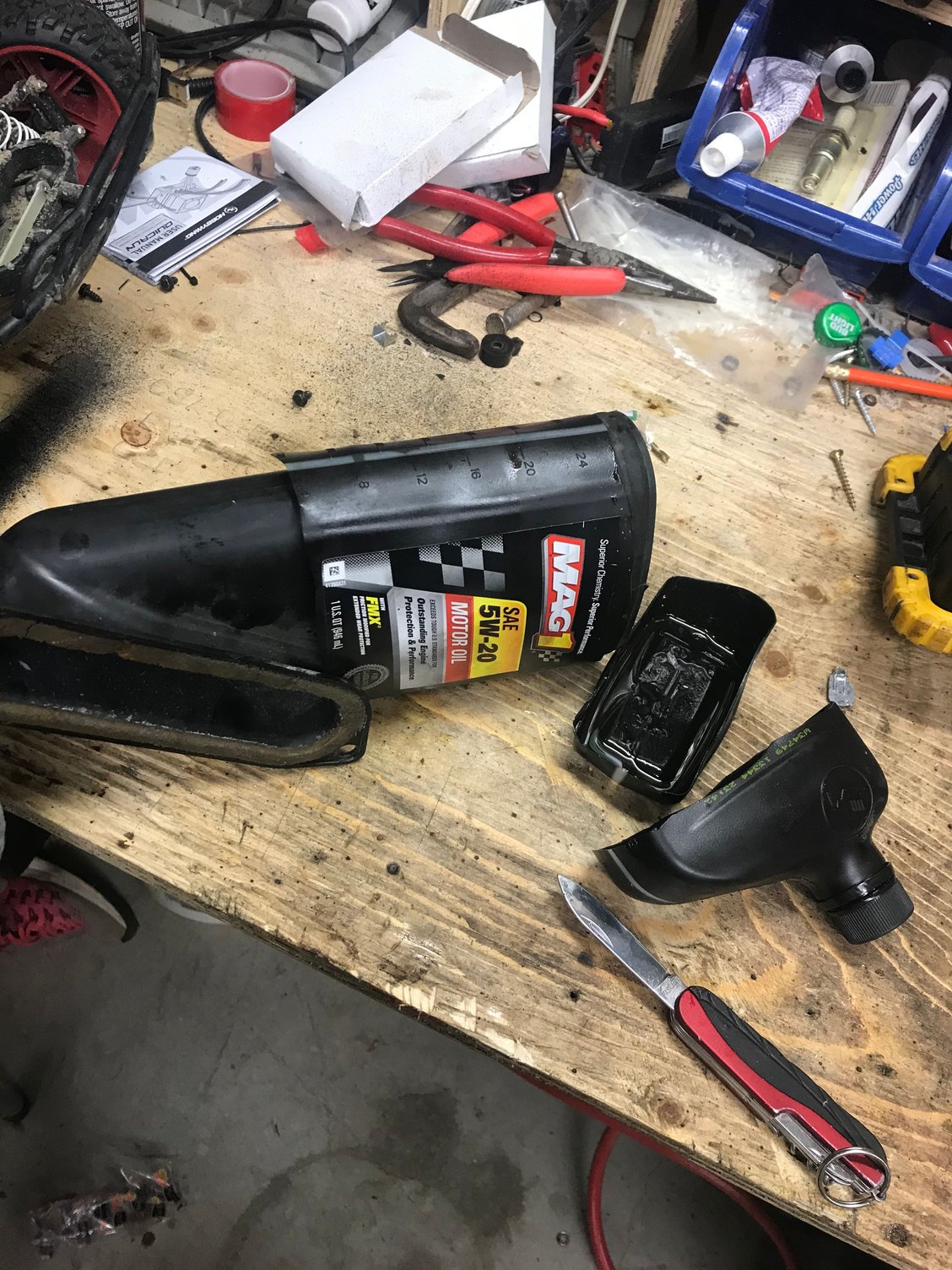

I temporarily used an oil bottle to repair the rotted out air intake flex. I’m thinking of making my own snorkel setup. Or I’ll get 1 of abrans kits if not

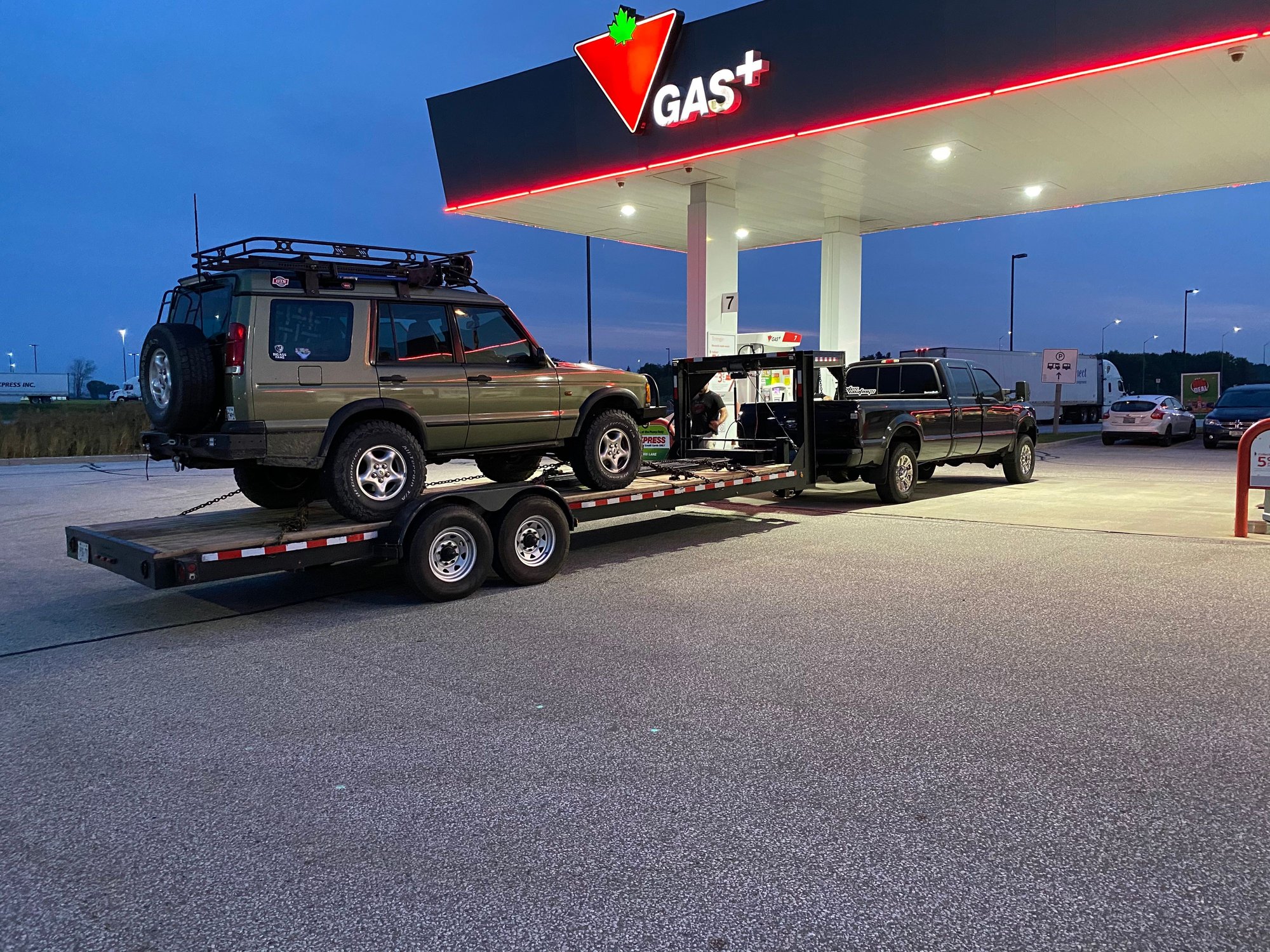

Trailered her up this morning
Arrived in minden around 2, should be hitting the trails shortly

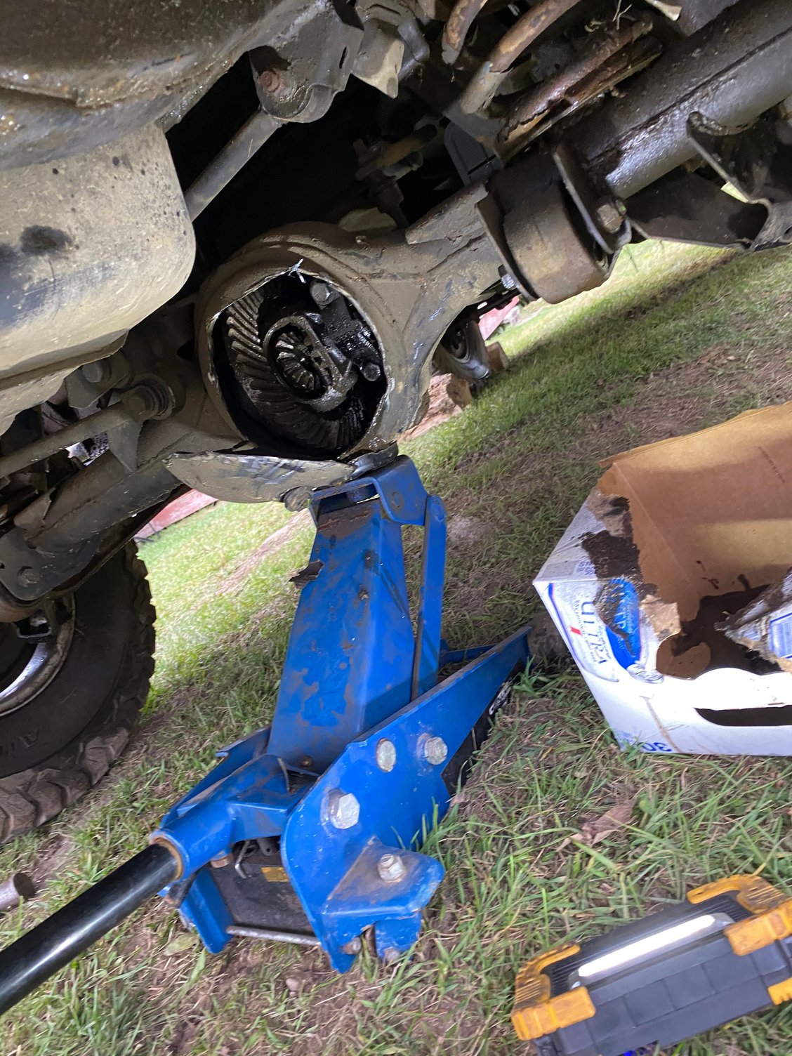

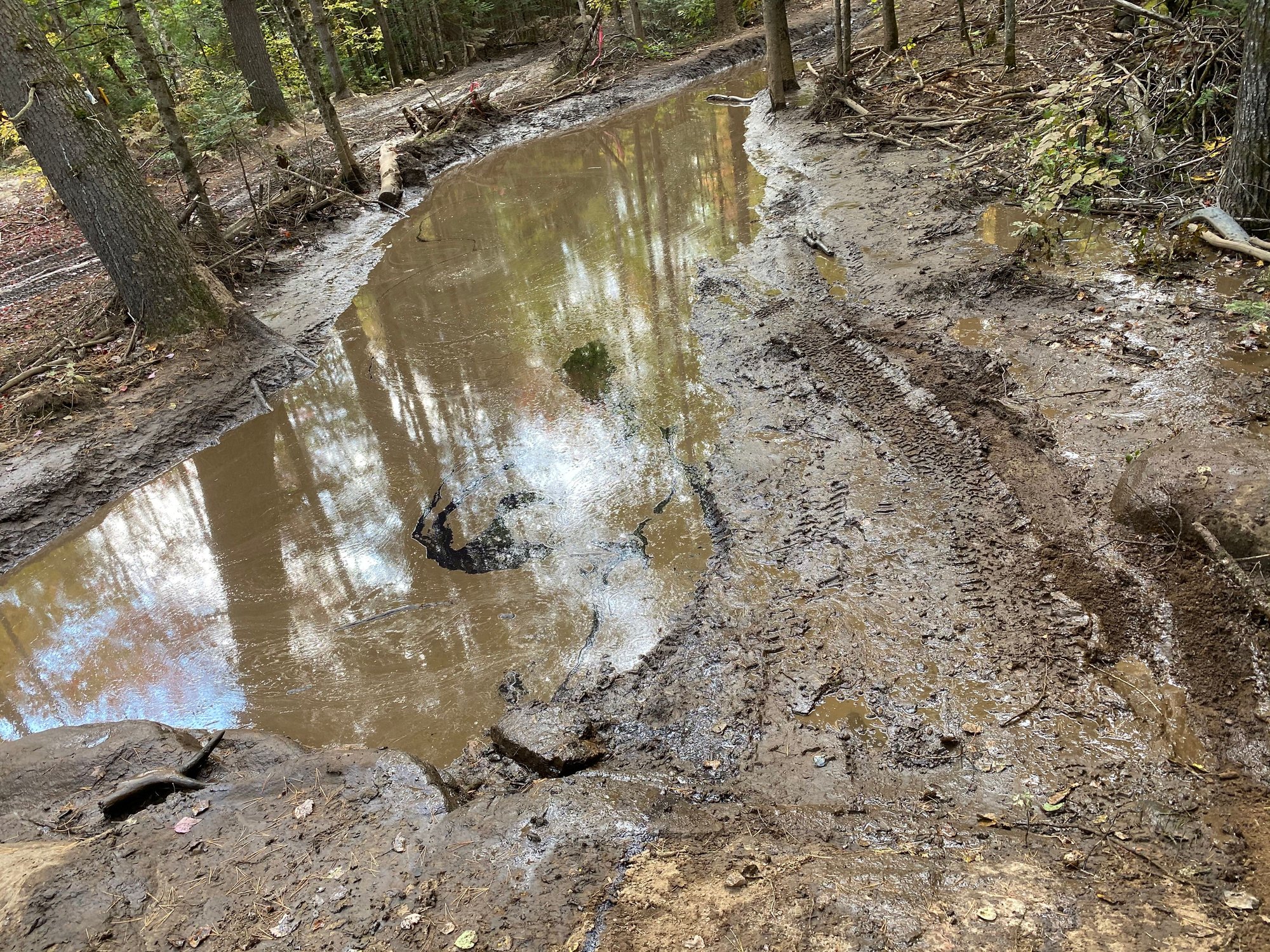

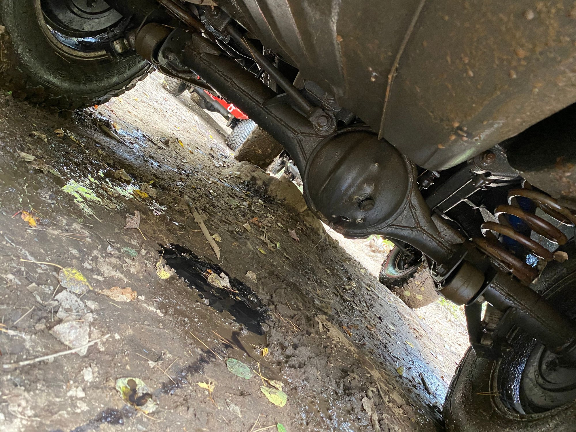

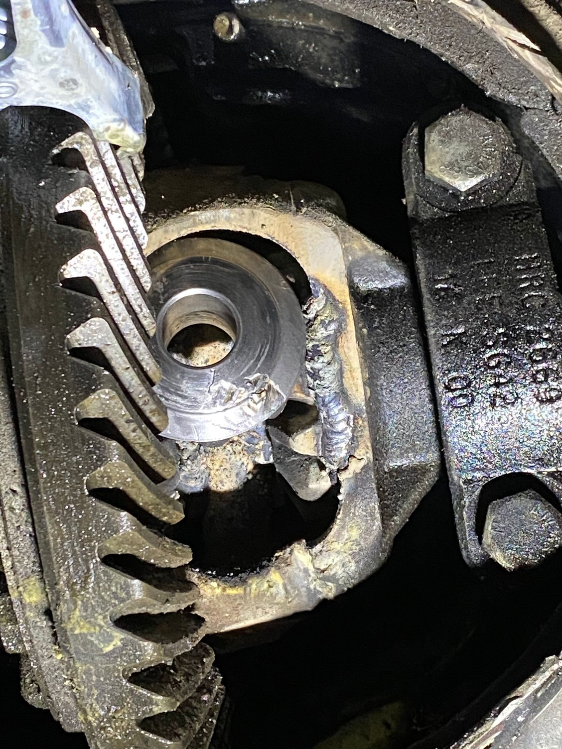

Broke the rear diff first water hole,
It’s an outy diff
80/90
Water in the box. Definitely need a snorkel

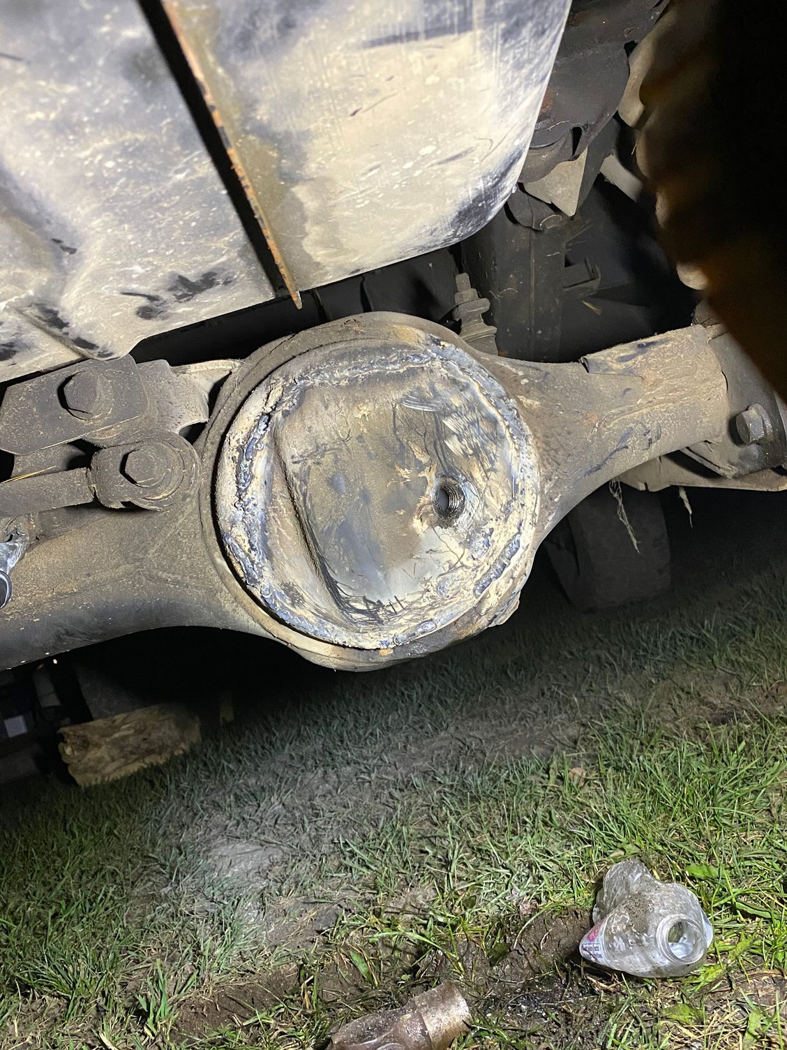

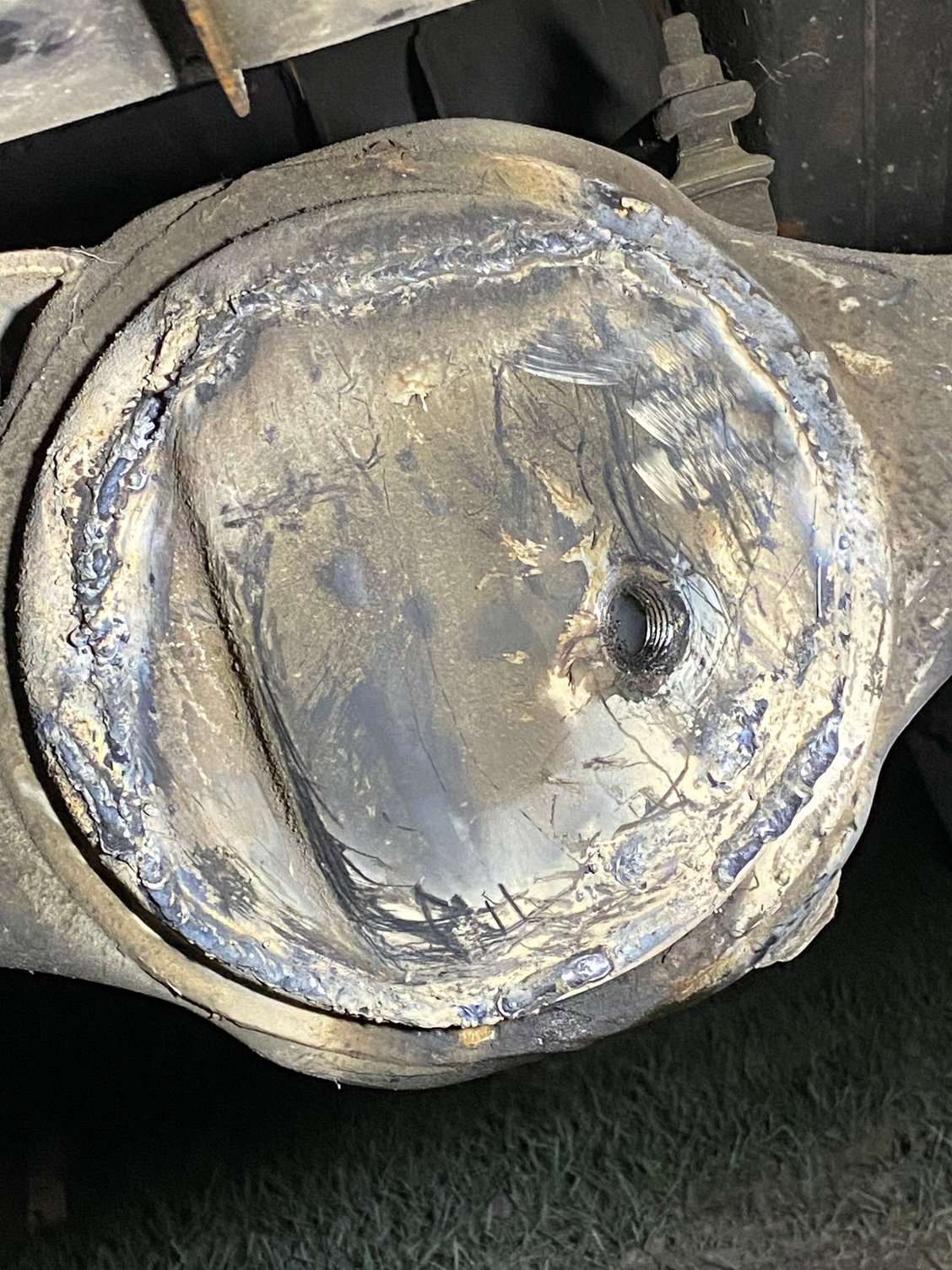

Cut open the rear diff with a cordless grinder
Bought a cheap 120v mig at the local hardware store, started welding the cross pin back in, welded the shaft gears to the carrier, stuck some small wrenches in side and welded it up solid
Made a spool with the left over parts and a 1lb spool of wire
Welded the cut off plate back on, filled it up with 80/90 and ready for tomorrow
I should’ve welded my initials on there

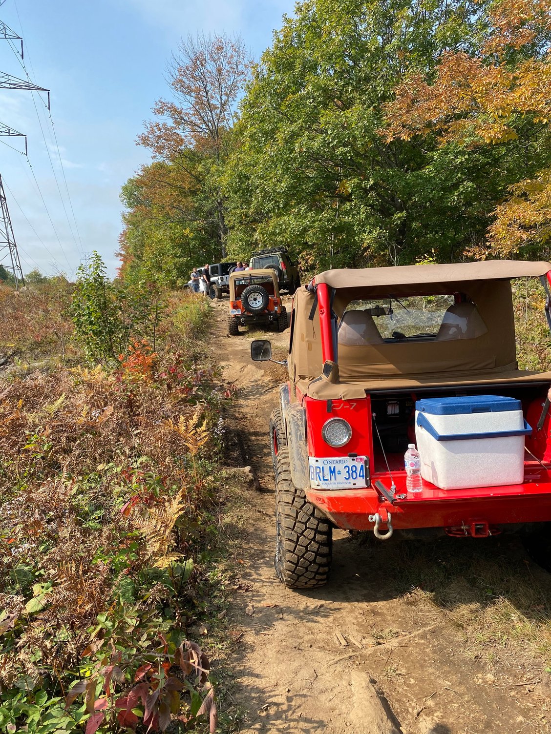

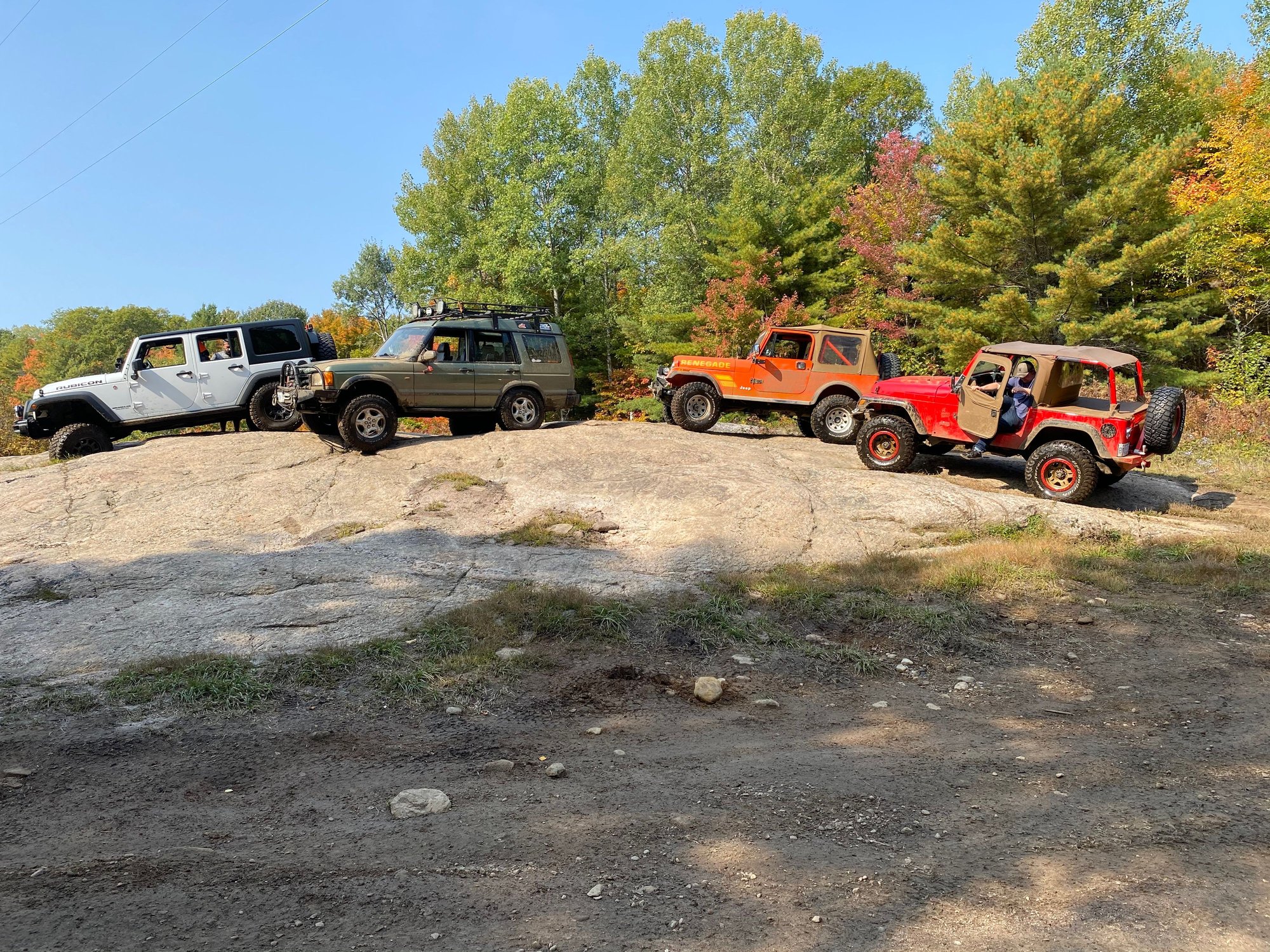

Group for the day, the older rigs are my buddies, the new rubicon guy we just met
That Lincoln locker is working a chime

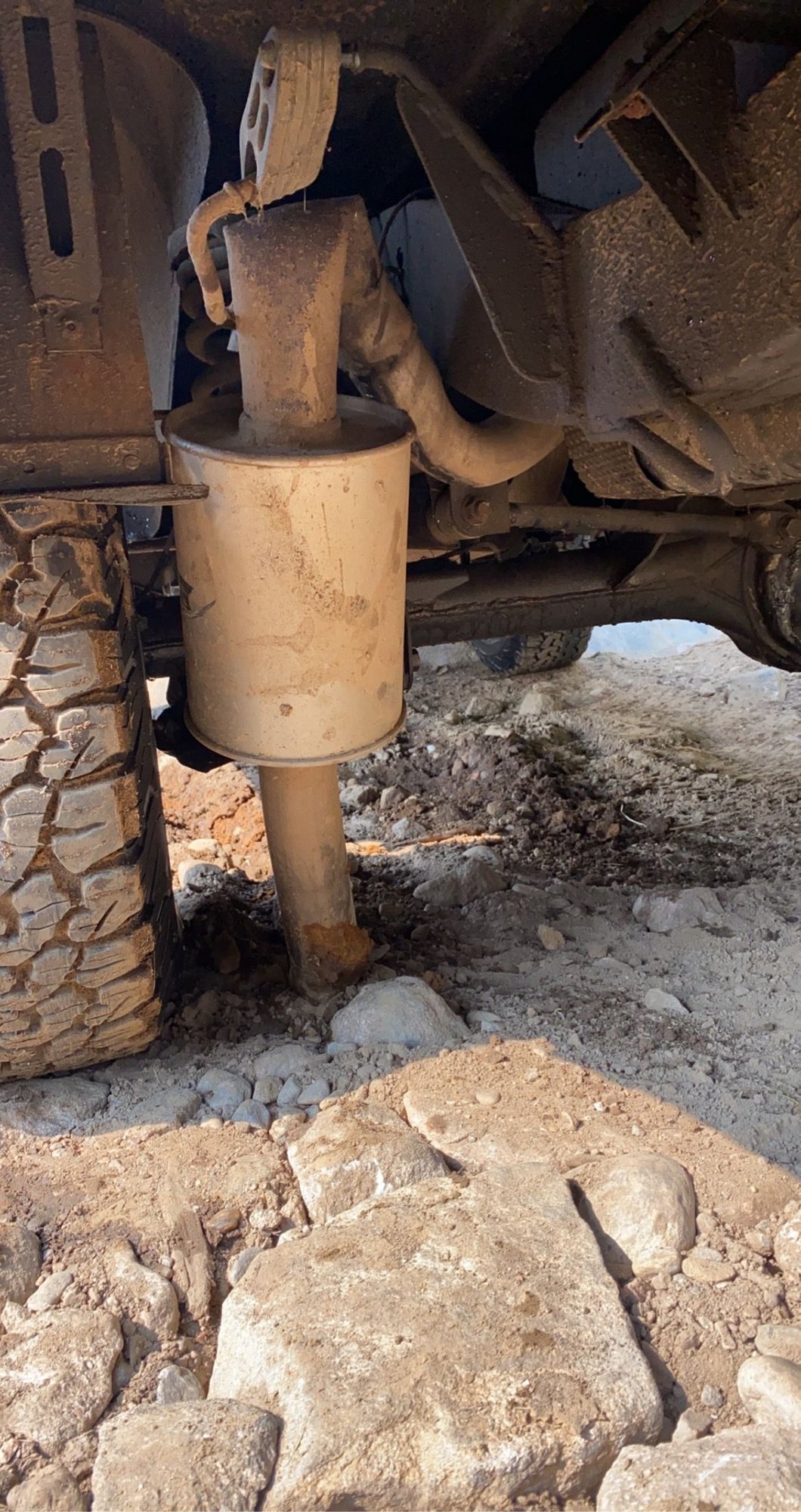

Ripped the resonator off backing down

Man I thought my exhaust had taken a beating lol no resonator on mine and the pipe just ends at that last hanger with it crunched real bad at the bend going up.
