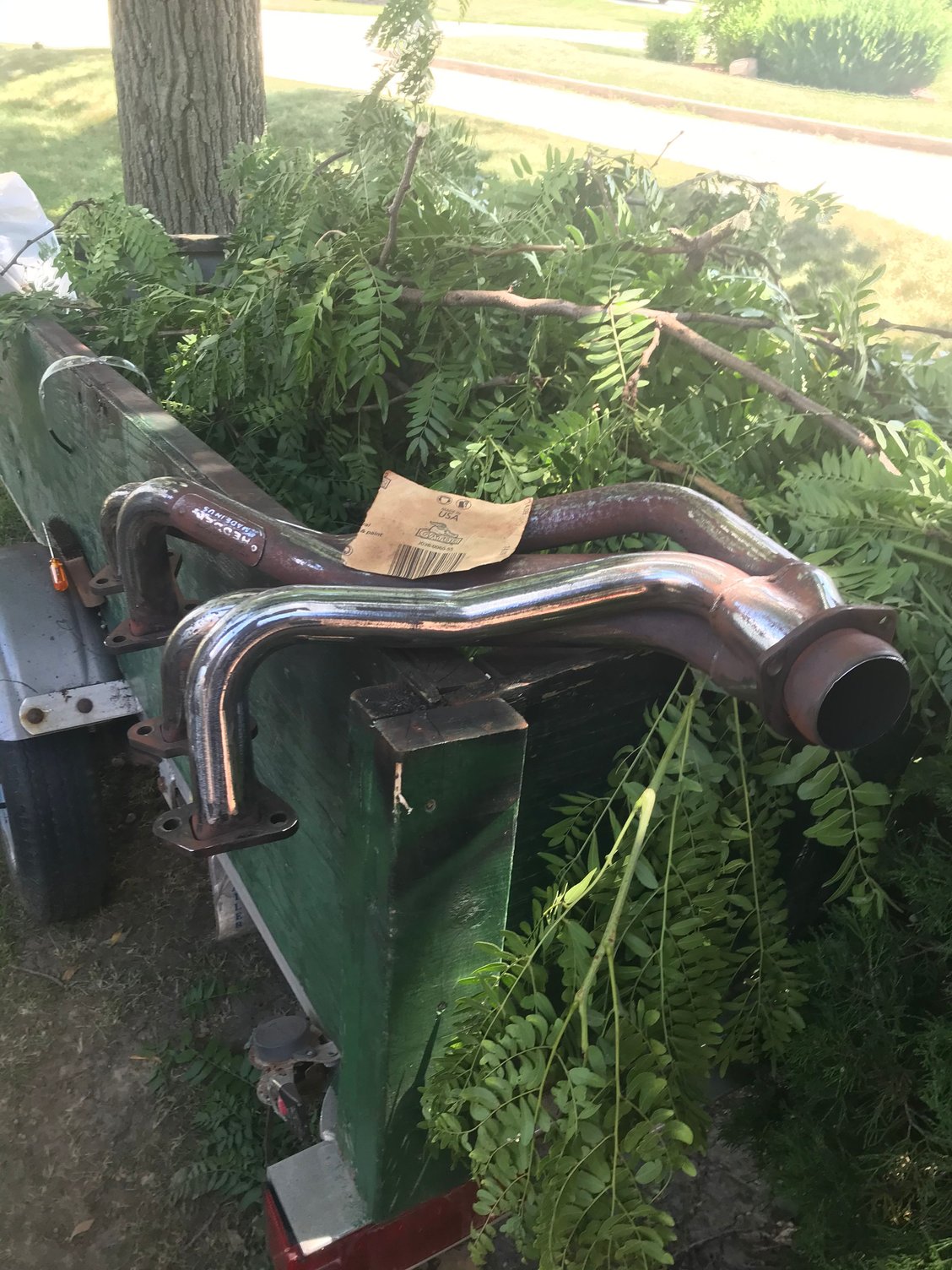

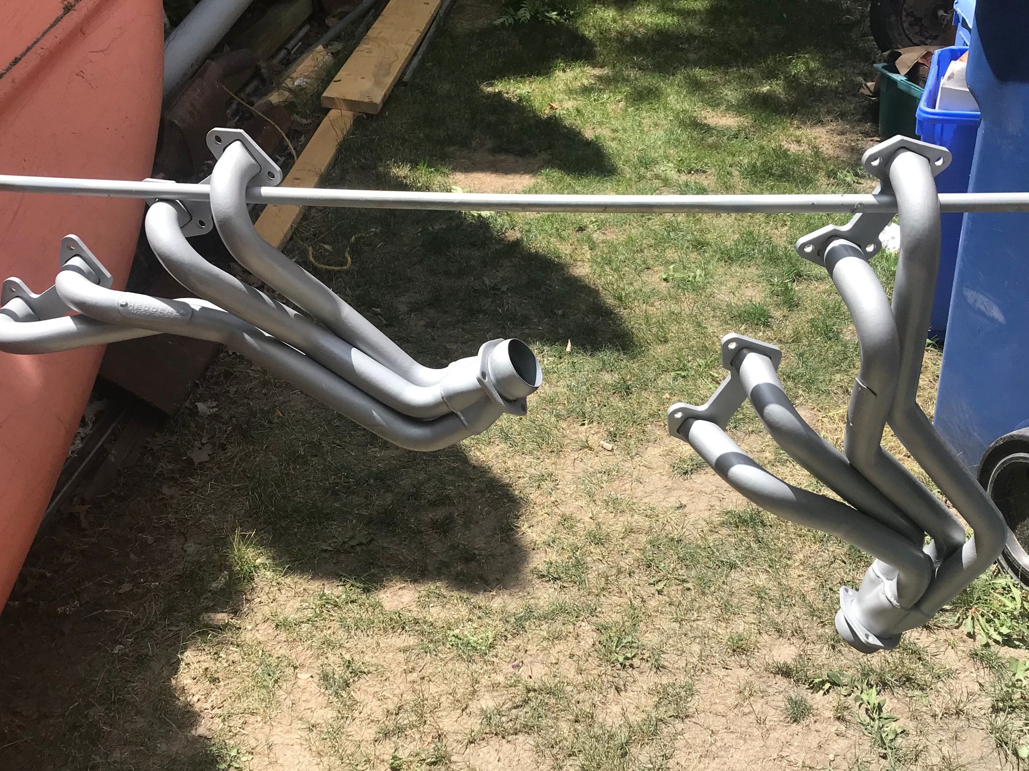

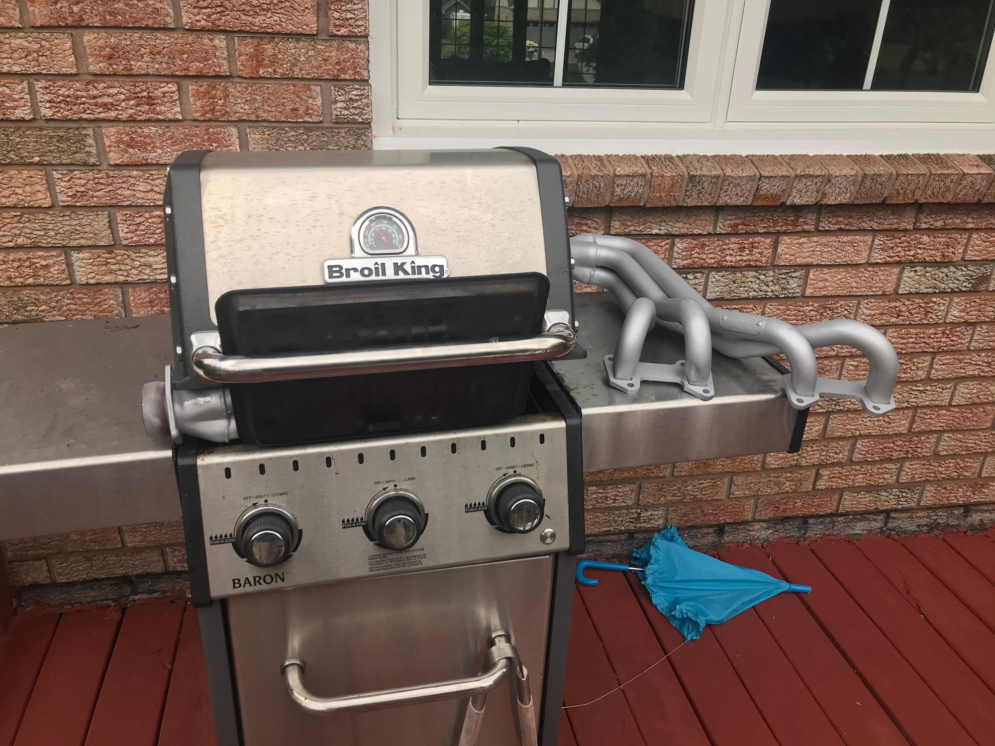

Cleaned up the headers
Shot them with ceramic flameproof paint, I still need to bake them now

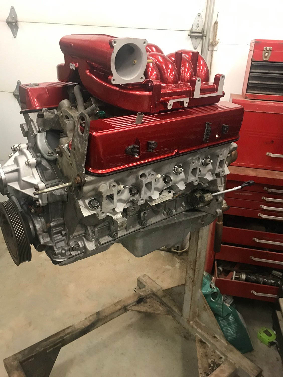

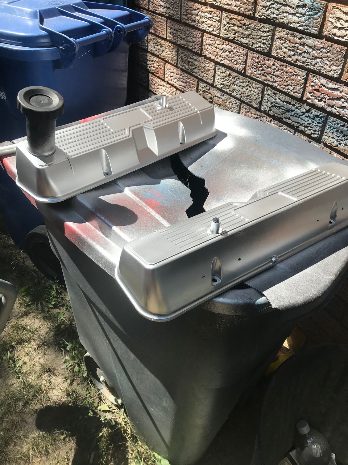

Shot the valve covers silver for now

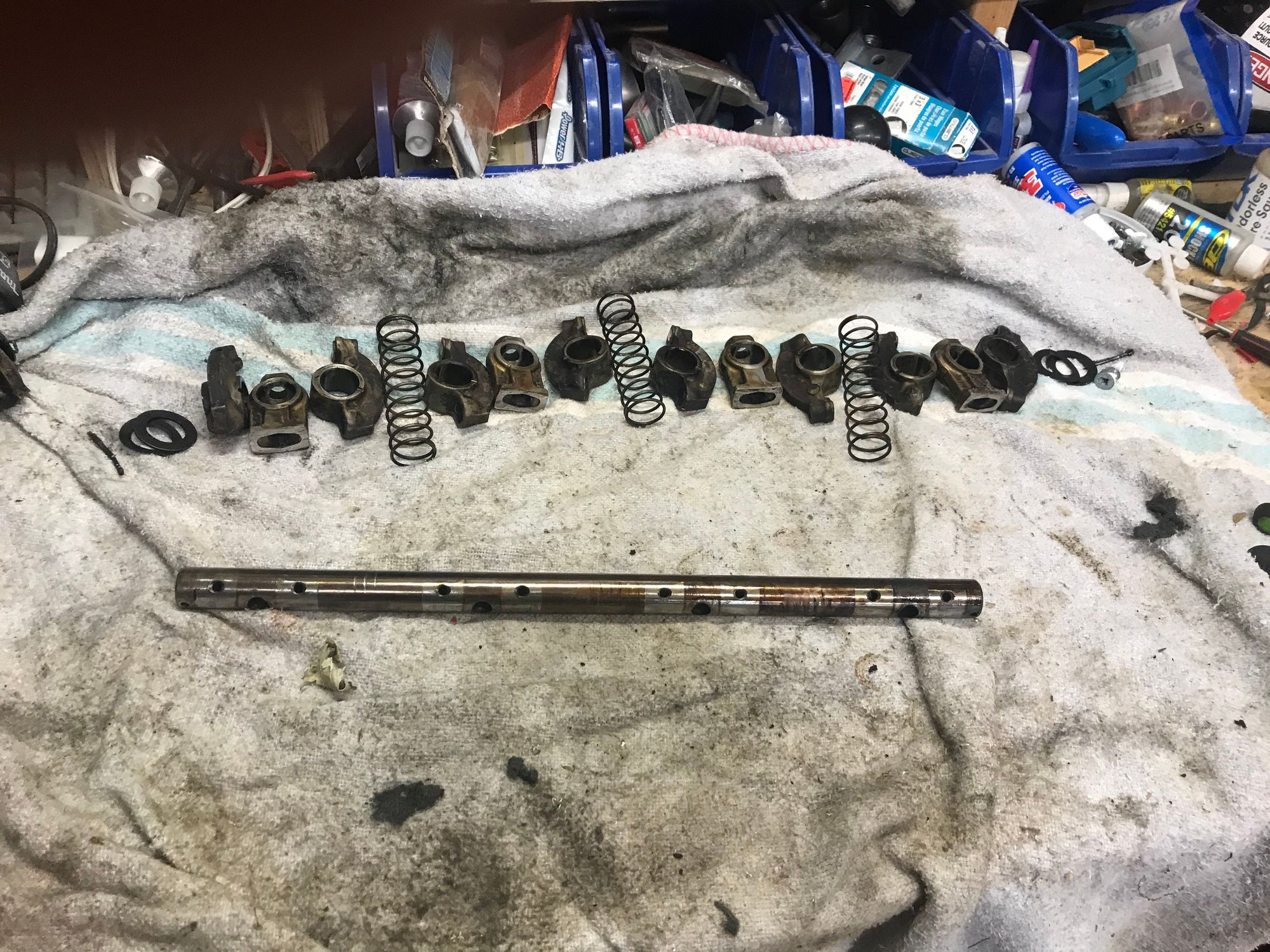

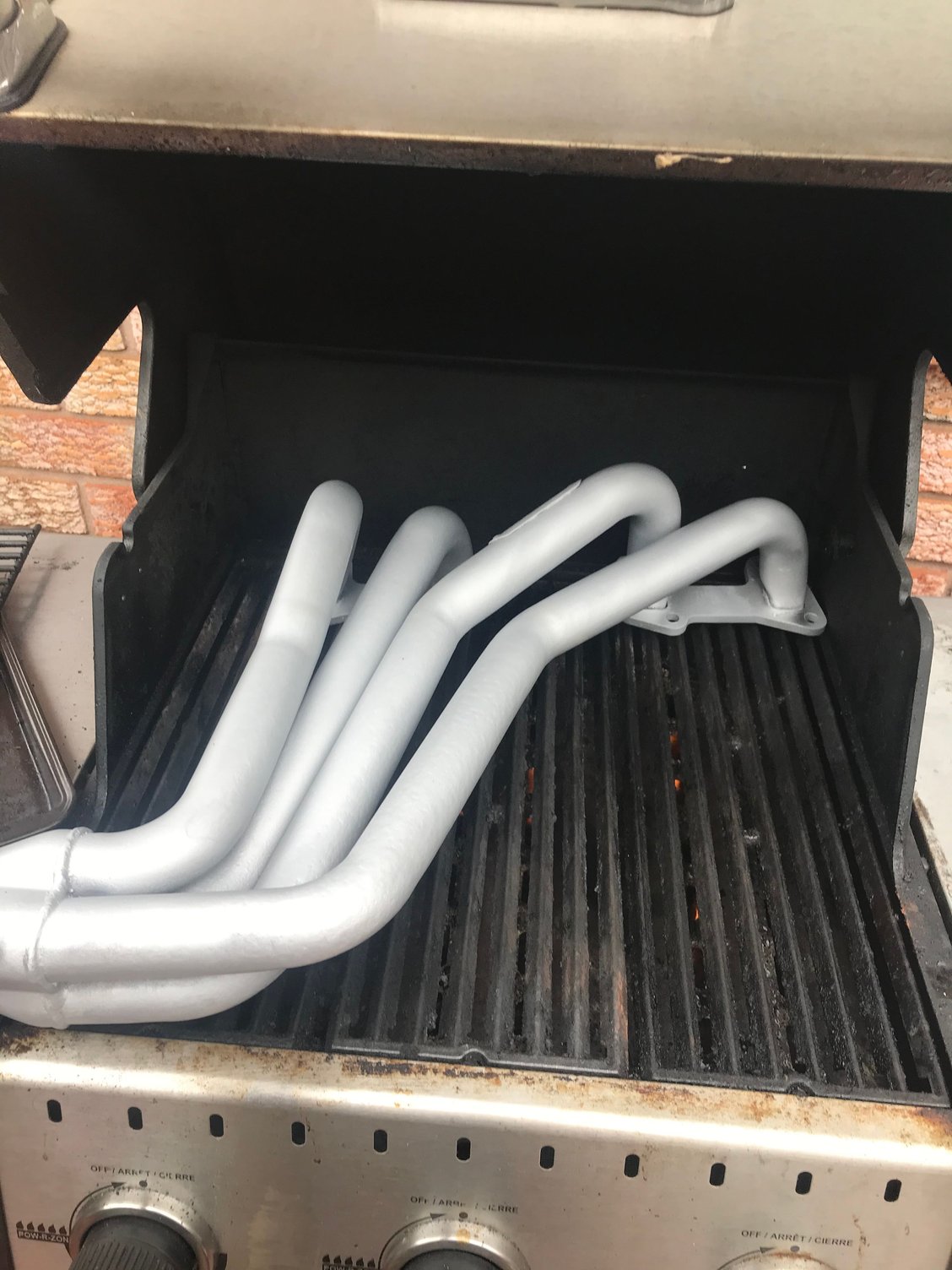

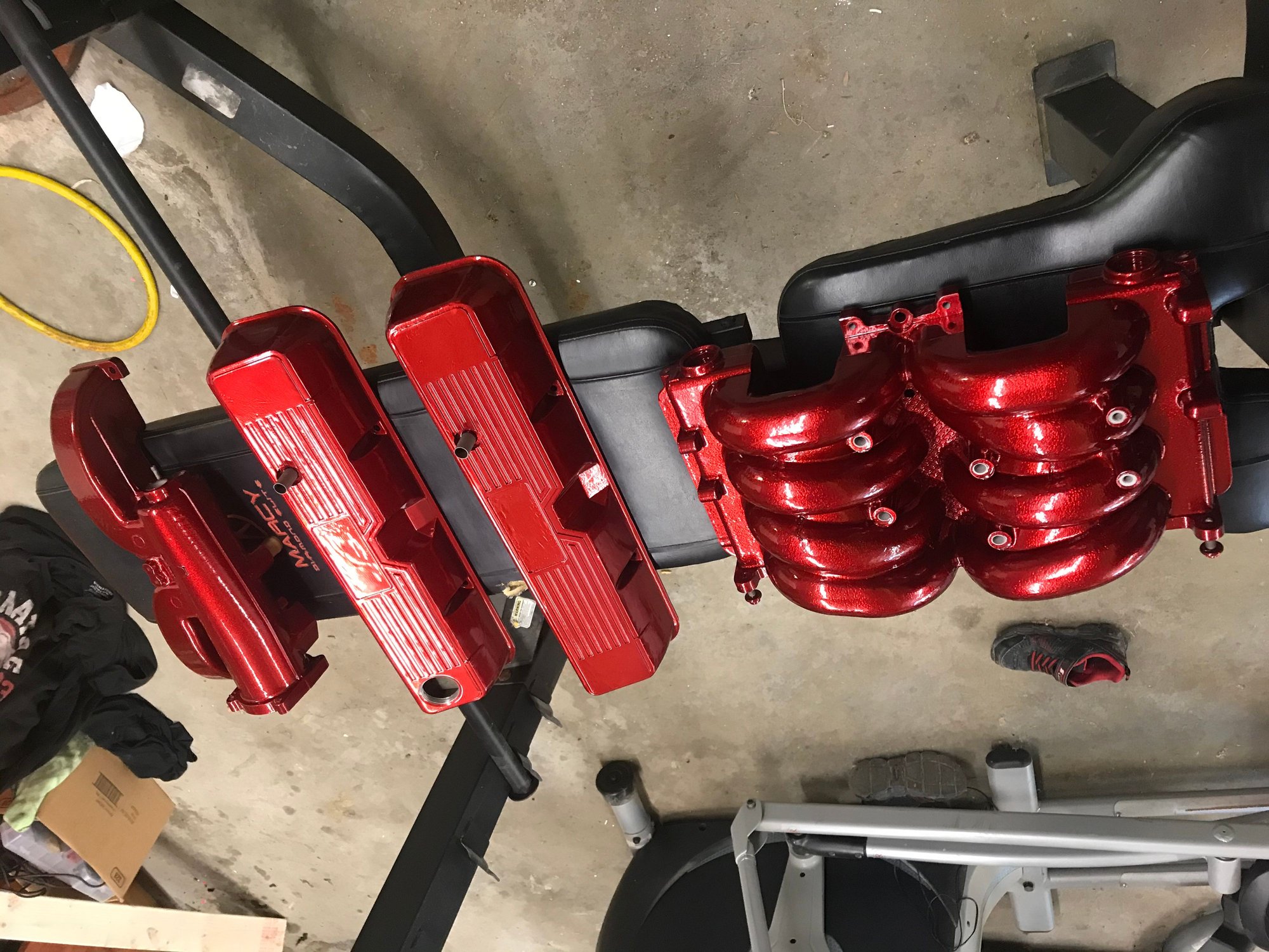

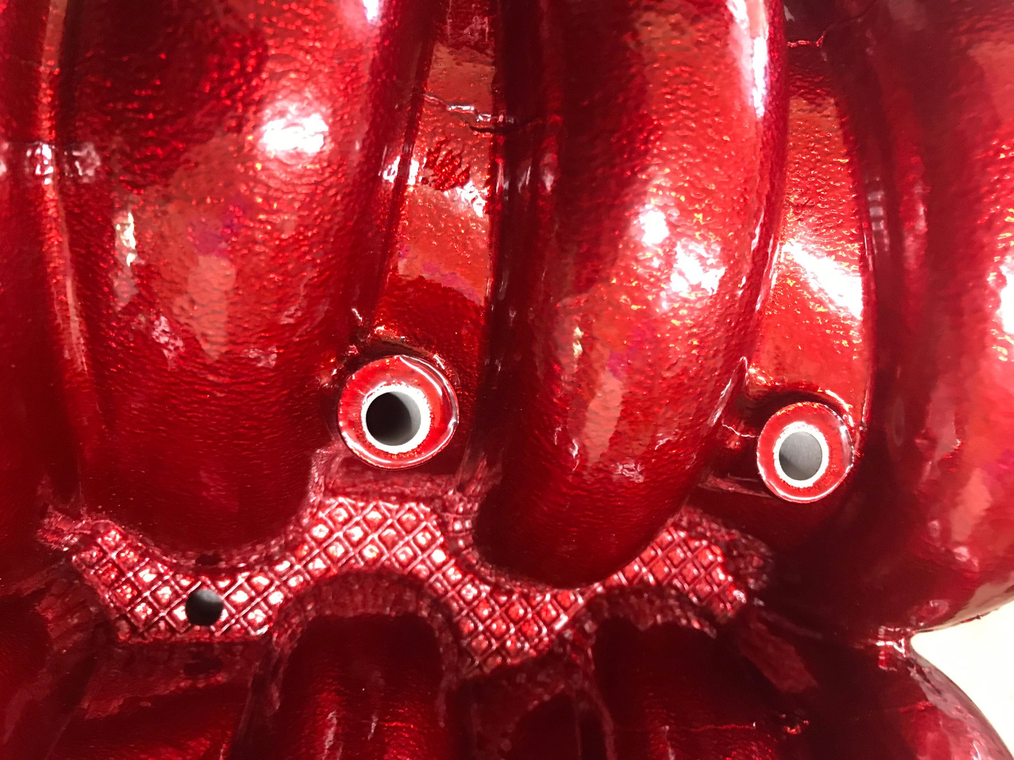

I painted my headers with ceramic high heat and treated them to harden the paint
It may not be as good as a professional but way cheaper
Last rocker shaft to clean up
The powder coater finally came through
Almost going to be too pretty to get dirty. Almost lol

Thanks for the advice deputy, I did a thorough cleaning of the parts, they actually weren’t bad, at least I couldn’t see anything come off in the wash sink. As for the heat dissipation I think I’ll take the chance, I’ve had other motors that were full aluminum with powder coated intakes and cam covers from the factory ( 4.6l 32v Ford v8 in my 96svt cobra) I think it’ll be ok. I’m also upgraded to a custom 4core heavy duty rad at the same time so that should help.
last night I got the intake and rocker shafts valve covers on. Slow process cleaning and double checking everything as I go.

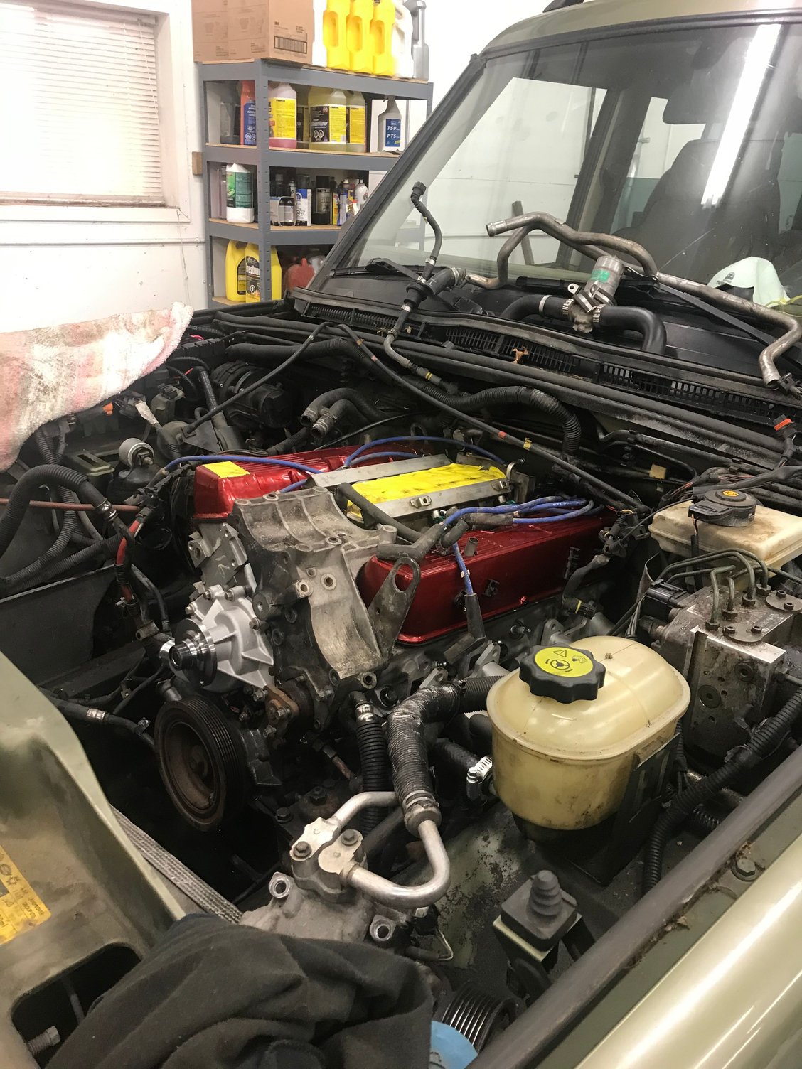

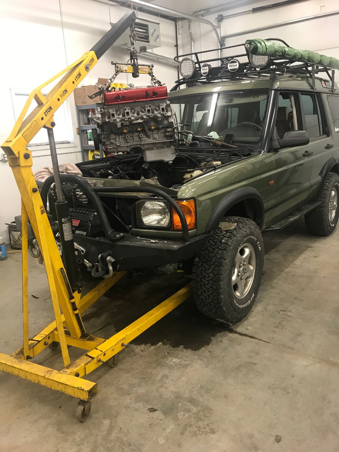

Finally got some free time to work on my truck
Just wanted a couple pics while it was still clean. Lol
Got it all bolted up. Still lots to do. Definitely need to go through the wiring harness. The plastic covering is terrible decayed
