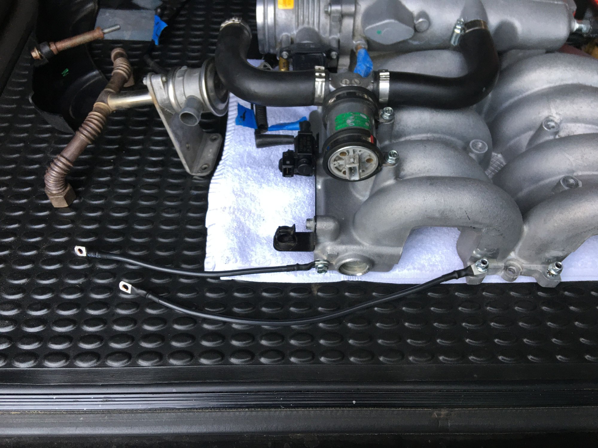

It was too muggy today to fully work on Myrtle. I crimped and heat shrunk 2 each 10AWG grounding cables from the intake manifold and coil pack mount to the 10mm firewall ground bolt.

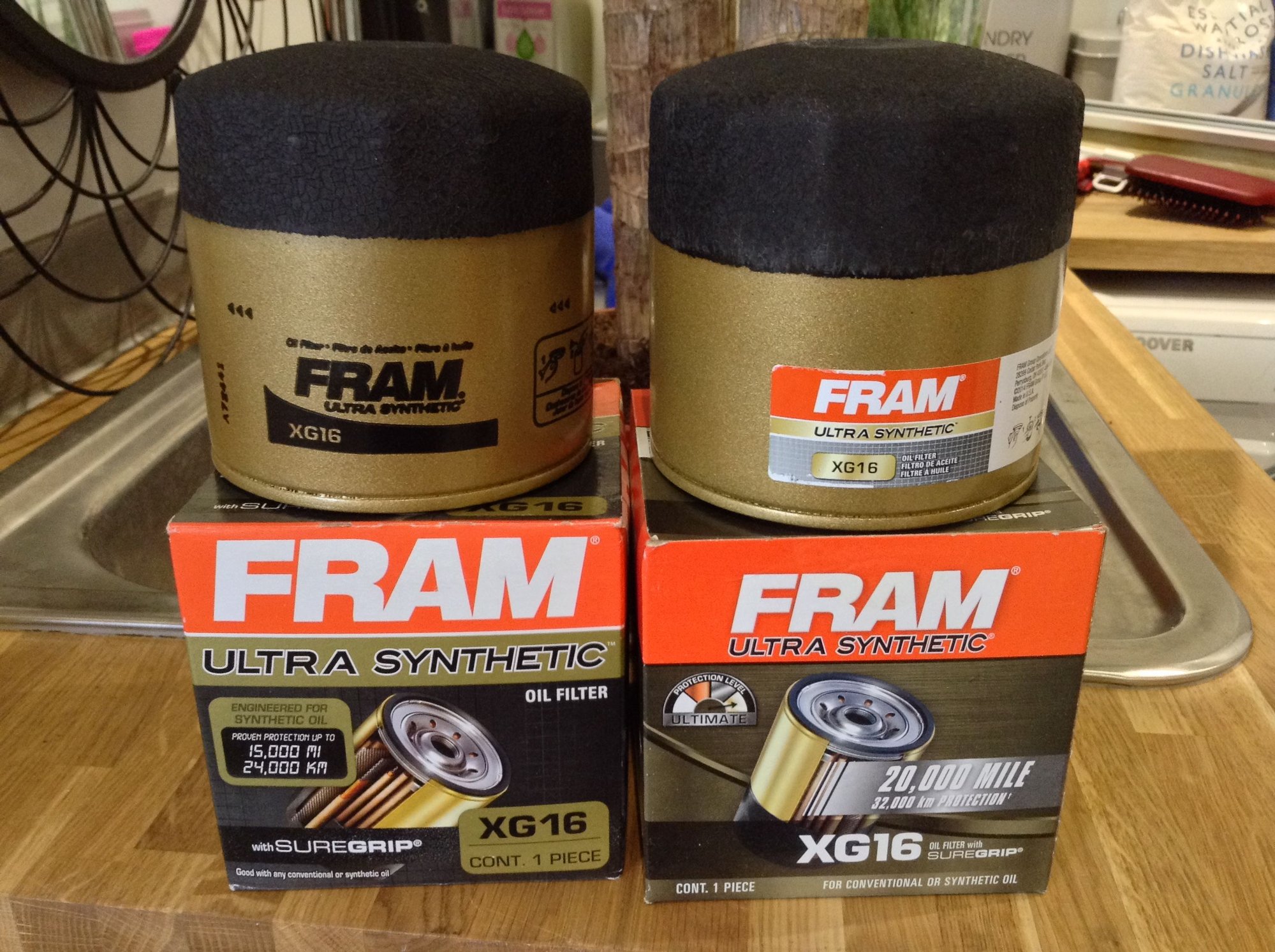

As much as I don't like Fram filters I couldn't pass up buying two Fram XG16 oil filters for $1.87 a piece! I bought them at The Exchange on the RAF military base.
They were cheap but the boxes and filters each look dodgy af...

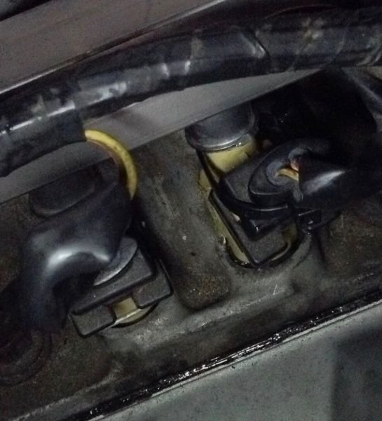

I installed the reconditioned Bosch 0280155705 injectors. It was a fairly simple job following the RAVE manual but I found some takeaways to make it easier…
  • Have plenty of rags ready. The fuel rail holds quite a bit of fuel that needs to be drained from the schrader valve and rear fuel rail connector.
  • Uncap the test port on the fuel rail and press the schrader valve inward to release the fuel pressure. Have a rag ready.
  • When removing the old fuel injectors, check the inside of the injector ports for o-rings and the plastic bits from the old injectors.
  • Apply Vaseline to all the fuel injector ports that the injector fits into on the engine and the fuel rail. Also add Vaseline to all the new fuel injector o-rings. This helps inserting the new injectors into place without pinching the o-rings.
  • After inserting the fuel injectors, fuel rail, tightening the 4 fuel rail mount bolts and connecting the rear fuel rail connector, pressurize the fuel rail to check for leaks. I used my Nanocom to turn on and off the fuel pump to pressurize it.***Be mindful of fuel and electrics***.
  • Make sure all of the top engine wire assemblies are zip tied/secured out of the way so nothing is pinched when installing the intake manifold.

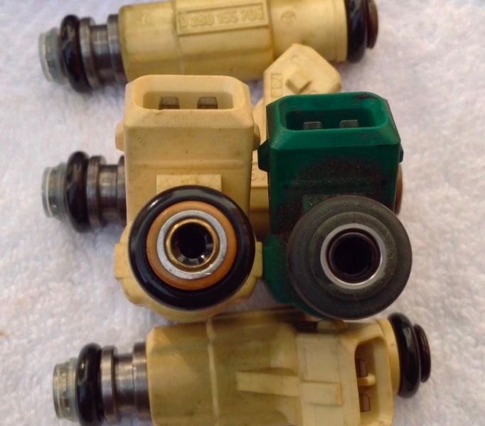

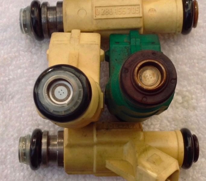

Old green Bosch 0280155787 vs. reconditioned tan Bosch 0280155705 injectors...
The new tan injectors didn't have a groove for the metal injector mount clip so I didn't install the clip...
I noticed while removing the injectors that I was missing the metal clip for #4 injector so I zip tied it to the new injector when I installed it...
