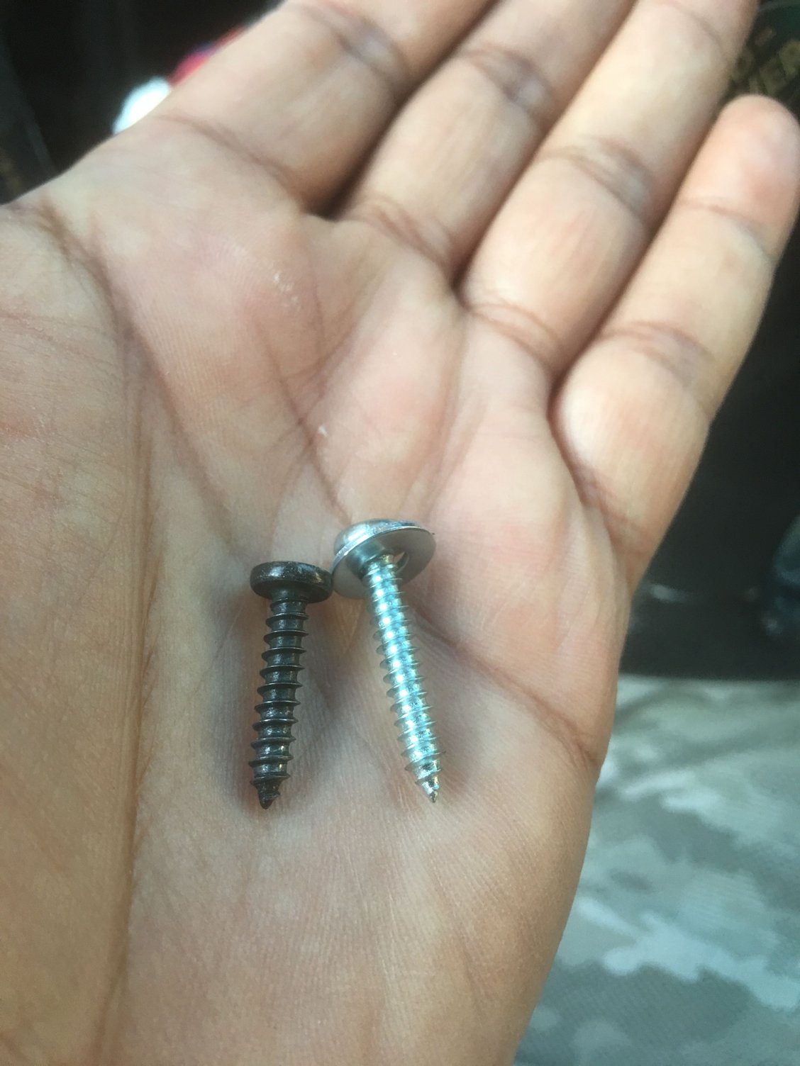

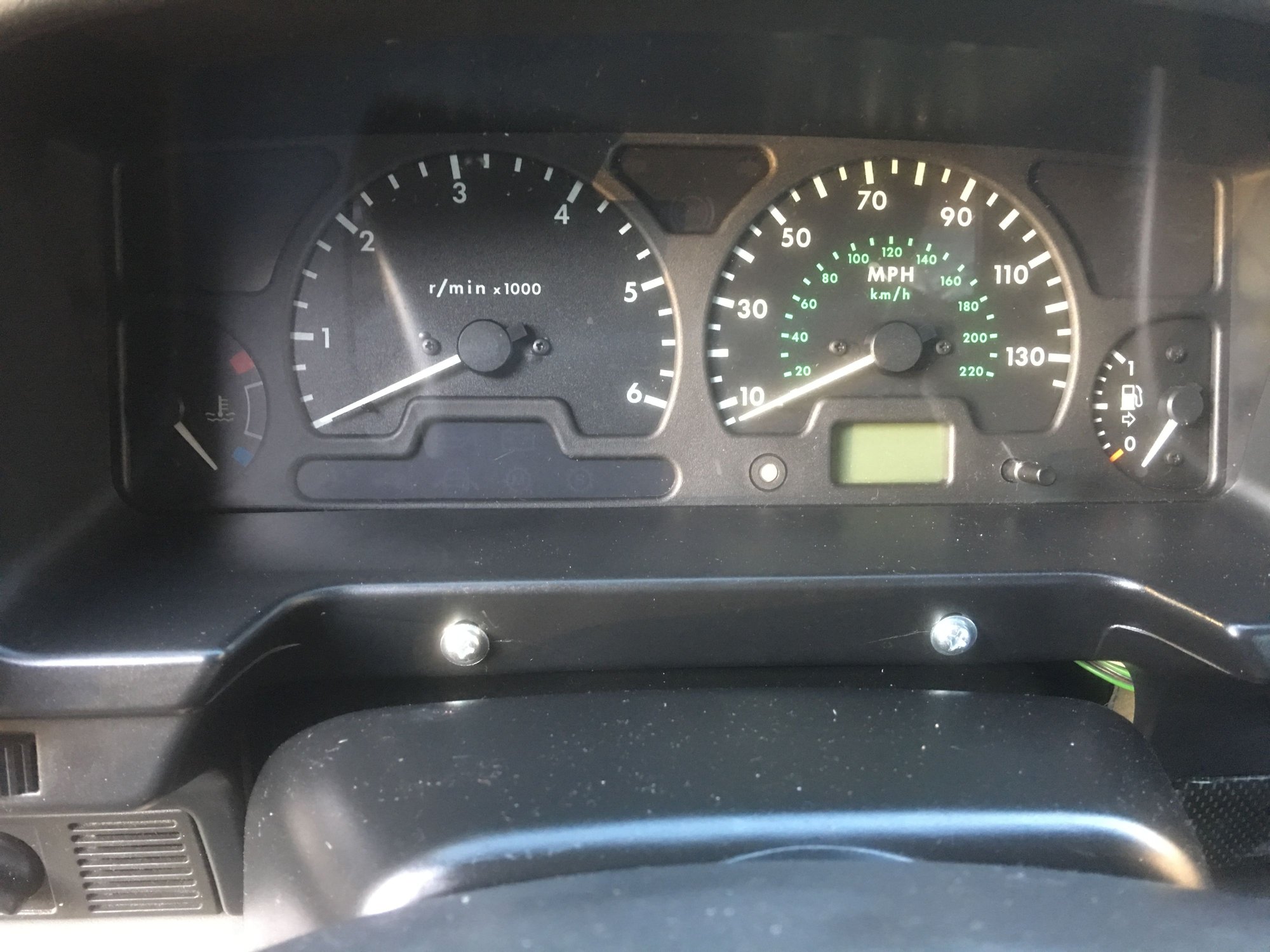

Added washers and longer sheet metal screws to the instrument cluster to hold it in place better. Not pretty but no more loose and creaking cluster when driving.

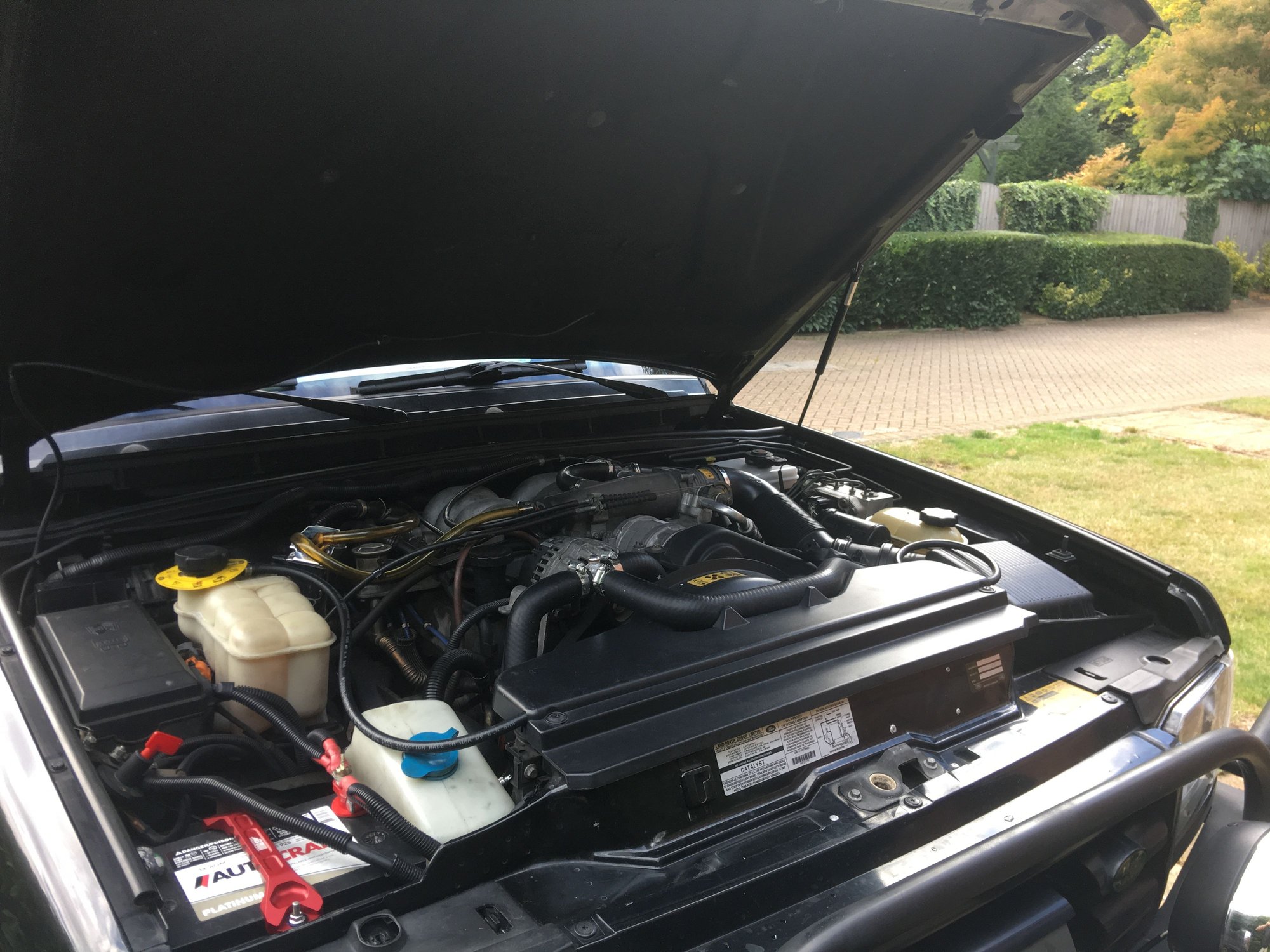

I did a smoke test on the V8 engine. The parts I used were:
  • 1 rubber glove
  • 1 rubber hose
  • any kind of roll of tape
  • a 99¢ Black and Mild mini cigar... wine flavored... if that even matters...
First remove the air filter cover and MAF sensor. Then slip the opening end of the glove onto the lip of the inlet opening where the MAF sensor connected. Tighten hose clamp onto rubber glove. Cut a smal slit in one of the glove’s fingers. Feed the hose through the slit. Tape the hose well to the slit to make a good seal. Fire up the cigar, take a toke then blow the smoke into the tube a couple of times while holding the throttle linkage open. Cap off the rubber hose with your fingers or bend the hose to hold the pressure. Watch for smoke.
And for the love of God... DON’T TOTALLY INHALE THE CIGAR SMOKE! Lol
Surprisingly this smoke test worked very well. The first leak I found was at the intake manifold hose clamp. It was smoking like a pack of Winston’s coming out from the bottom of the hose. I found the clamp wasn’t fully around the intake hose and it left a small air gap.
I correctly tightened that clamp, smoke tested again and found smoke billowing out the brake booster vacuum hose fitting (#LZN100220L) at the back side of the intake manifold. I grabbed the vacuum hose and gave it a good shake in and out and found it was very sloppy in the connection fitting near the red ring.
Now I’m either going to A) replace the vacuum fitting or B) find some 9mm pneumatic hose and connect with the old vacuum hose to keep the vacuum fitting in place.
** I forgot to remove the Best4x4 PCV Mod and add a straight through barb fitting. I’ll do that and try the smoke test again this weekend.
***Edit*** my friend told me he added some shirink tubbing to the end of the vacuum hose to make up for the slop inside the brake booster fitting. Hmmmmmm... very interesting...

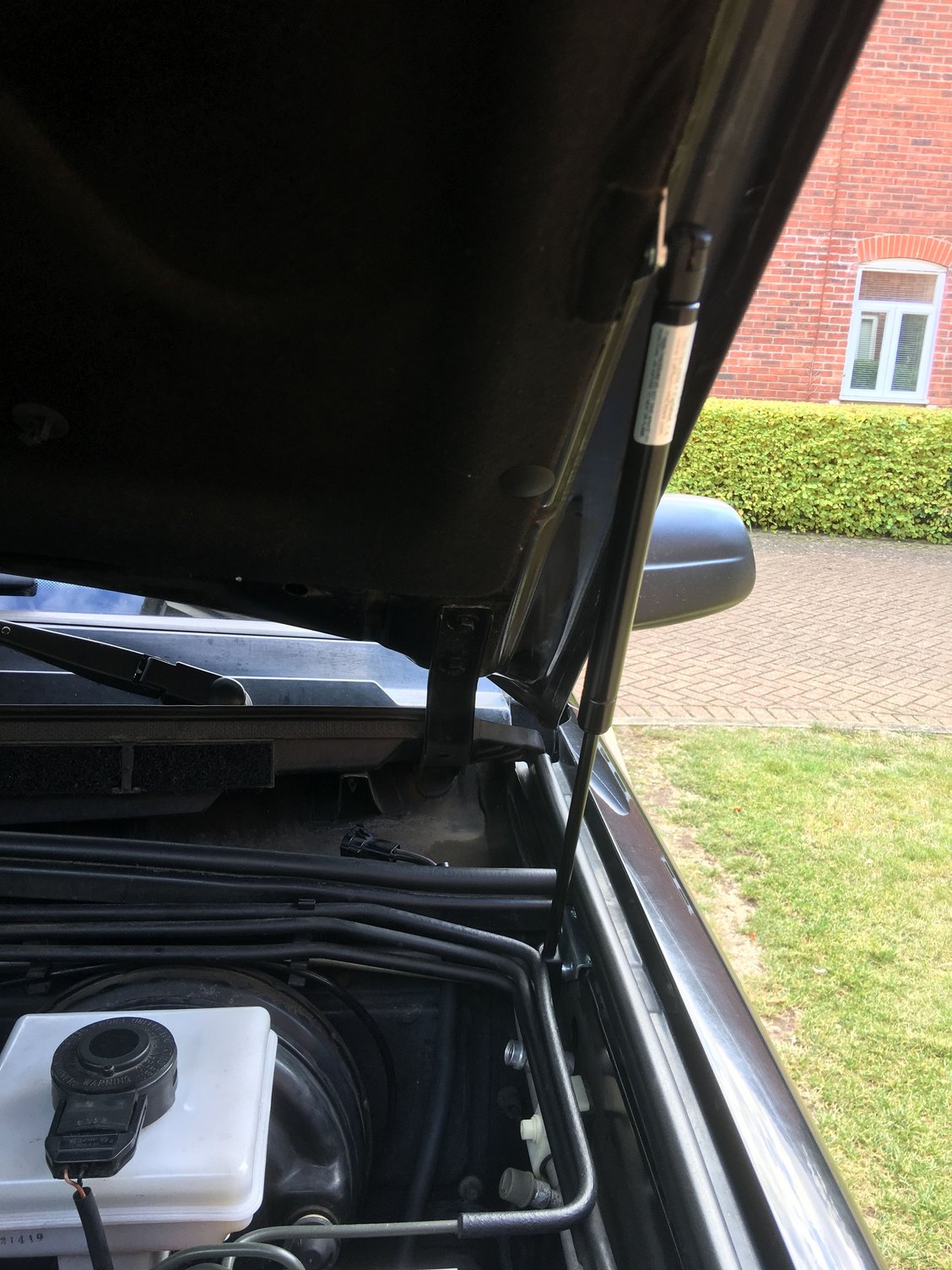

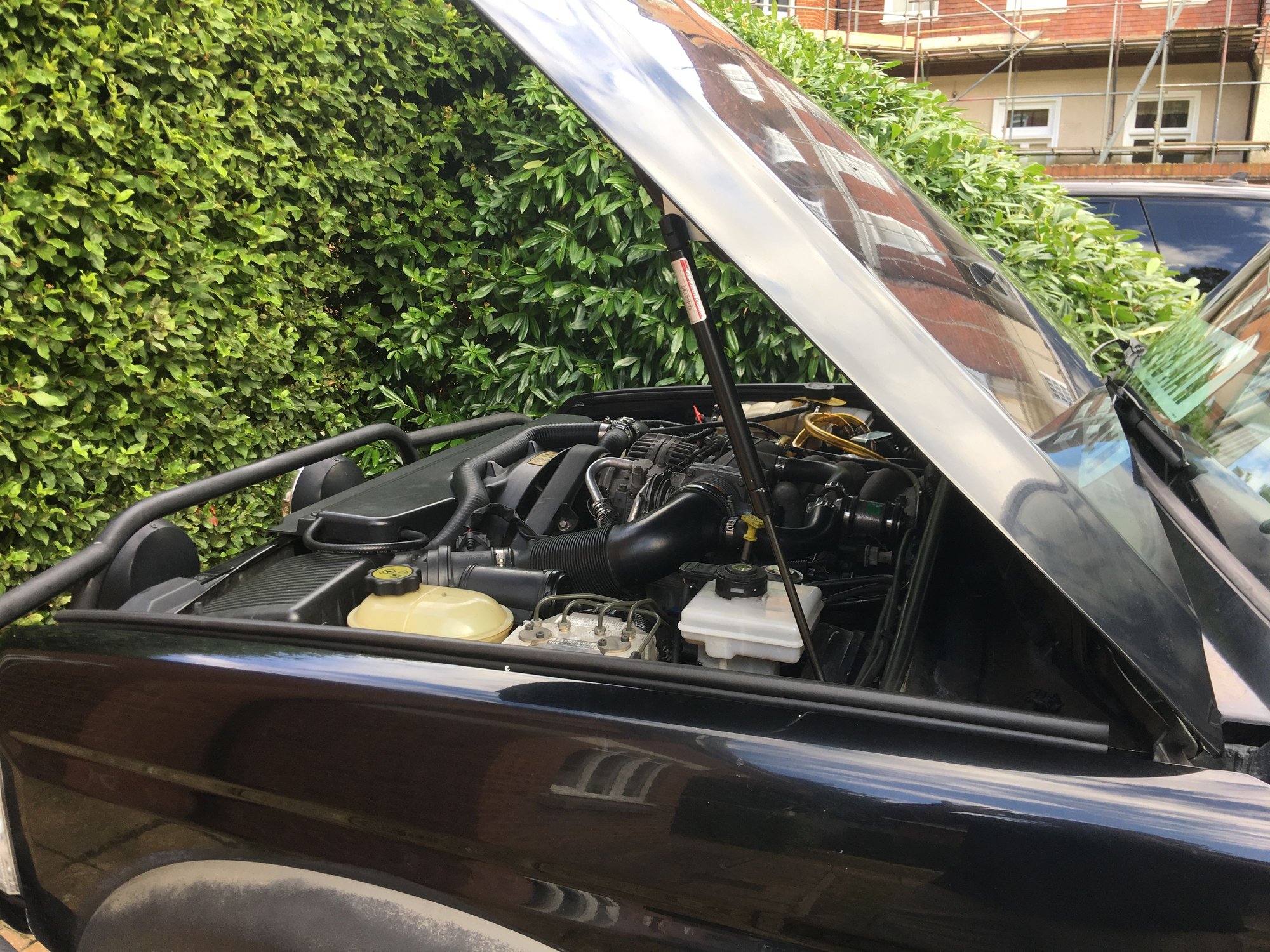

On a good note... I finally drilled and added the 17 inch 75lbs prop shaft to the hood/bonnet which holds very well. I might add the second prop shaft to the opposite side for more stability.
