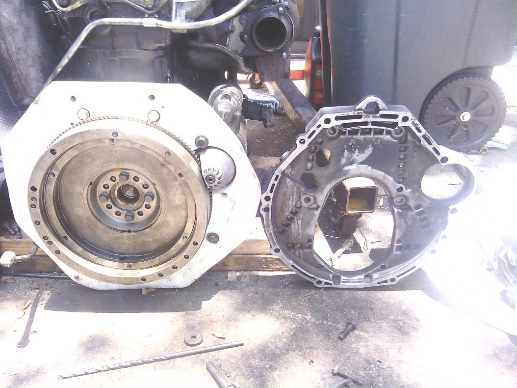

My starter is mounted through the back of my adapter plate with enough clearance negating any interference betwixt the ring gear of my 240D flywheel and the Bendix drive gear.
To the right is the Benz adapter. notice orientation. I think all is centered properly. Next week I will be ripping out the R380 from my 95 Disco I

I get he made a kit but what about the sump clearance of the front diff? To ultimately escape that, a 4 - 6 inch spring lift is an additional cost plus mod of suspension / steering components to keep alignment and there is the consideration for the prop shaft angle. you can get away with 3" lift but stops are necessary for off road full rebound.
Yes I am going to have to mill out the area about 30* counter-clockwise from the Rover starter position to accommodate the position of the benz starter. That will be the last thing I do after motor mount fabrication.
What components for sump protection with out modification and lift?
What other mods aside from mount fabrication and placement is afforded in this kit?
I am going to finish this conversion in less than a few weeks at under 1000 with no suspension modifications save MAYBE a body lift so I can avoid cutting my cowl lip so I have access to the valve cover for future valve adjustments?
The bore for the starter is complete and tight. There was a bit of walking and egging in the process of driling my HDPE plate to accommodate the starter cone. I used a cheap 9.99 hole saw kit from harbor freight and got exactly 2 holes before the counter hold pin's shot off and were no where to be found. I got my money back... in hindsight, I would have prefered to get an IRWIN kit for 65.00 but in the end I wasn't working with a lot of money.The only issue I have right now is egging out my bolt / mounting hole so I can get my other bolt to thread straight into the starter. The starter is threaded for those who don't know BTW.
