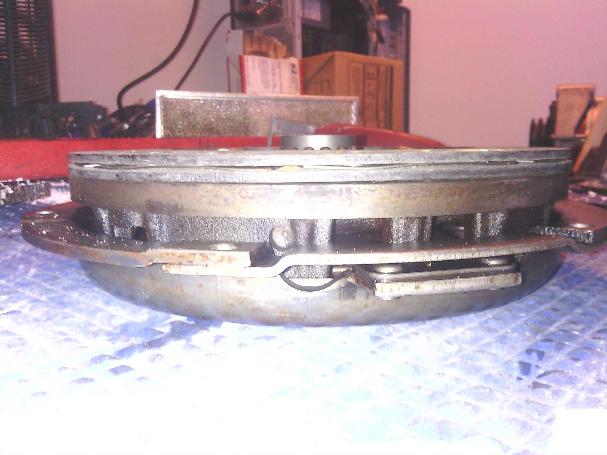

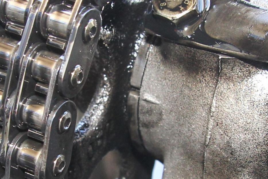

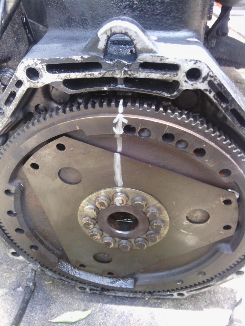

Prior to removing the flywheel, using the notch on the back of the cam gear and the 0I T scribing on the counter balance disk on crank pulley, I rotated the motor to TDC to mark the bolt, flange washer and the flywheel AS WELL as the single tooth on the ring grear in case of need to re fit it. See last photos.
Flywheels are married to the crank and balanced at the factory and it only goes on 1 of 12 positions without vibration issues. Removal of Benz flywheel requires a 12pt 12mm socket. Preferably new as you may be grinding off a flange bolt after rounding it. Don't ask me how I know.

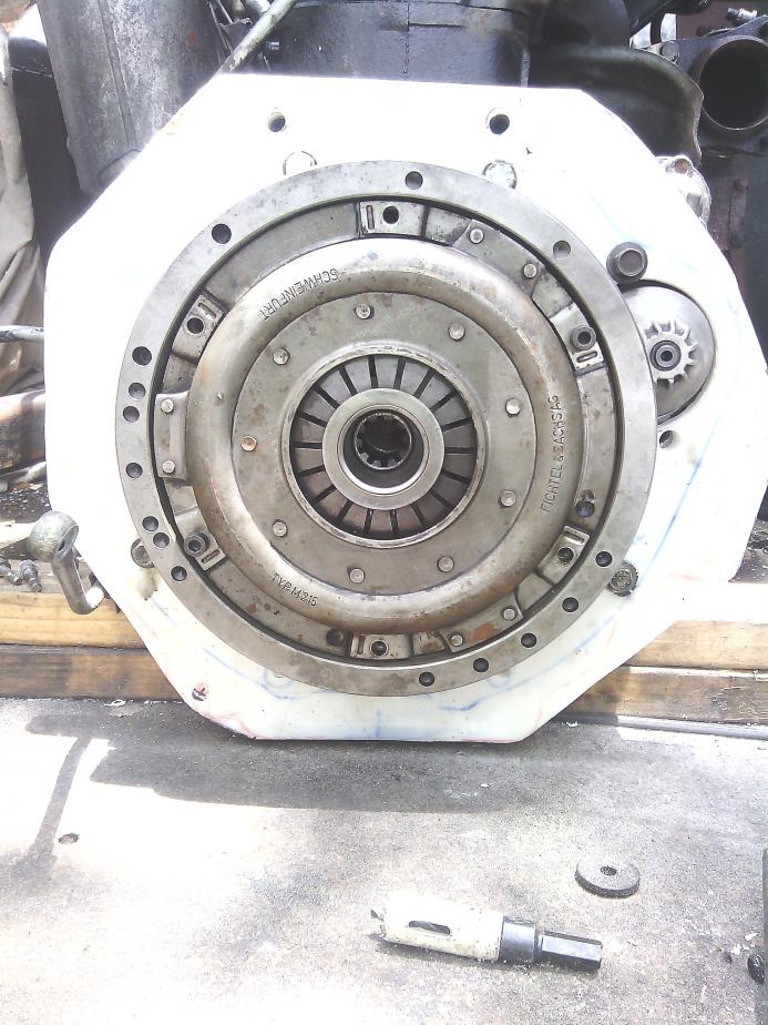

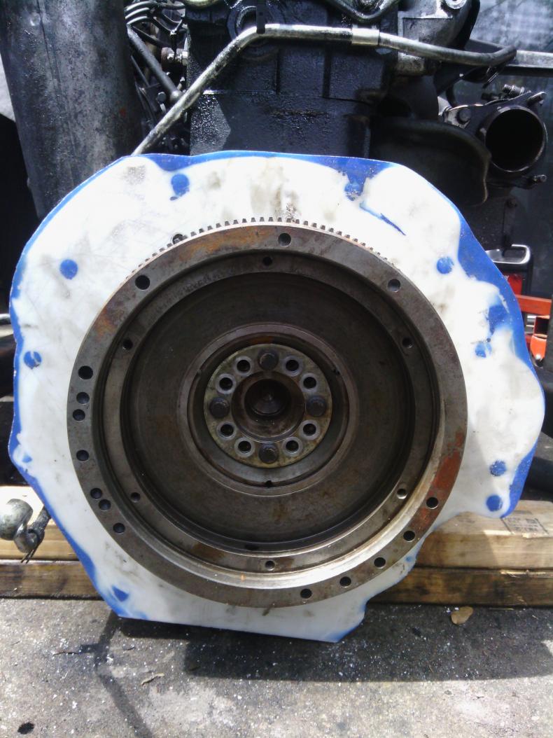

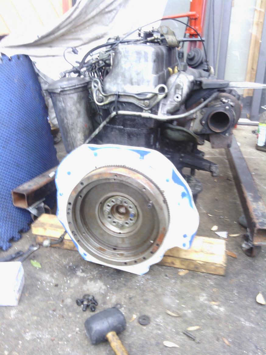

Using the native Benz adapter, I traced the dowel pin bore and got that to mount properly.

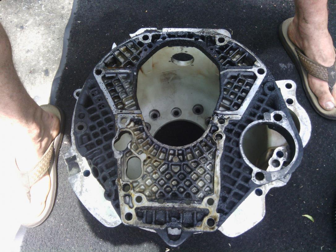

The one issue I noticed is the rotation of the starter orientation on the R380 Bell Housing diferent by about 30 deg counter clockwise. Jerek notched his bell housing to accomidate this difference and Marco in CA cut and tig welded his bell housing.
I toyed with the idea of rotating my engine orientation 30 dec as other folks have done and suggested as well as sell a mount kit for. Effectiveness of the sump pickup may be compromised to a degree by rotation is my speculation. I very well may be wrong. I often am being human and all. In the images posted in order of my discovery, you will see what I am talking about. If not.....look closer or forget it.

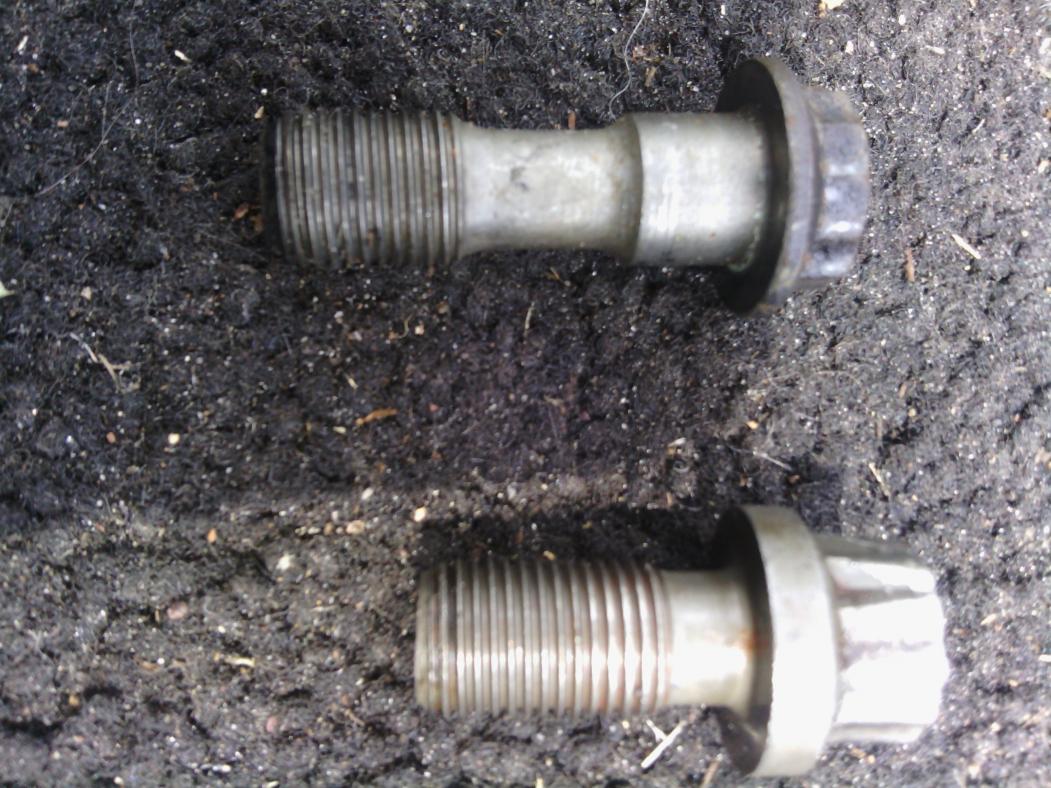

The crank flange bolts used on the auto flywheel vs. the manual are considerable longer than the later. See image. To give visual mass to those whom haven't seen it in person and have touched it I am posting an image of the bell housing under the benz adapter plate.

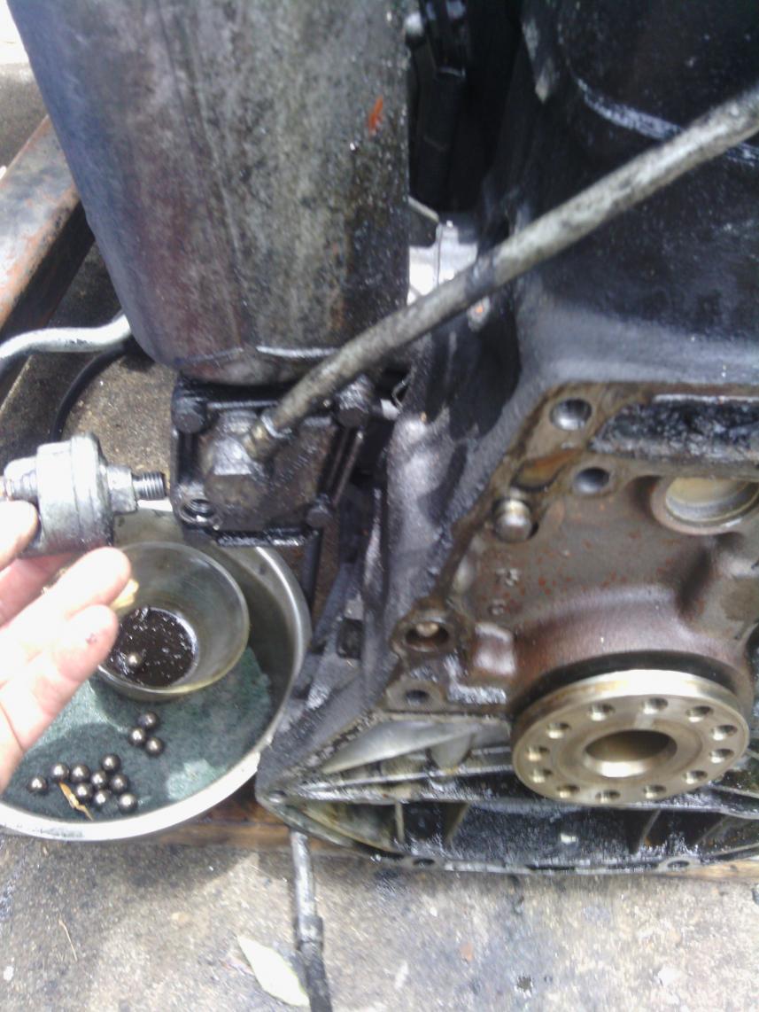

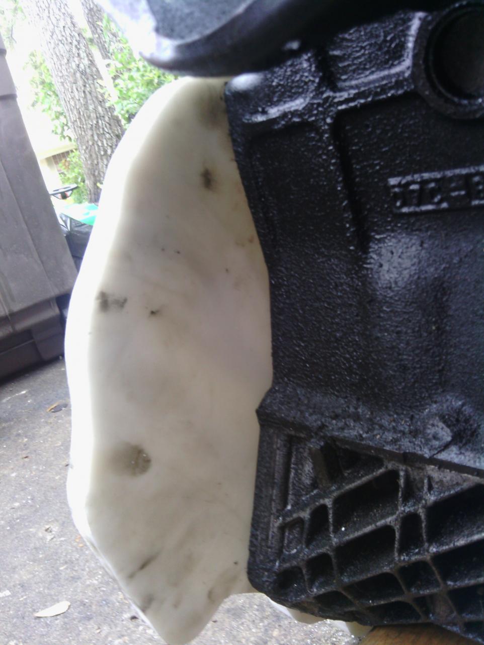

Prior to fitting the adapter, I had to remove the oil pressure sending unit from the base of the oil filter housing. Older om617's will have a traditional tube feed to the gauge in the instrument cluster of the W123
I have to say again that HDPE is super dense and tough. No wonder they use it for high friction applications as well as bushings, bearing shells and they make nuts and bolts out of it. I may use it for my pilot or spiggot bushing. Properly lubed, it may last longer than my truck.
Touching on the last image, you will notice that there are no other penetrations into my adapter material. This is simply because I have yet to pull and place my R380 trans complete with bushing appropriate for the primary input shaft to trans. The thing to the thing to the thing... Motor / crank inner bore to bushing to trans outer diameter of primary input shaft to trans....for those that require granular detail.

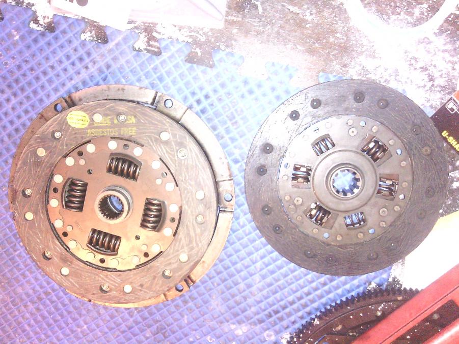

The native rover disk is 10.5 1x23 spline and I was considering getting one for the conversion and lathing down to 8.5". However, I found a clutch disk on ebay Hastings part no.CD1009 applied fitment in 87 Ford Aerostar. 8.5 1x23 for 25 + shipping. It only has 4 springs but they are heavy so we will see what happens. I also plan to fit a damper inline between clutch master and slave cyl's hoping to get the most time out of the clutch disk.
Does anyone have any input on the effectiveness of a damper?

I just received my clutch disk today. It is an absolute PERFECT fit and has .83 more friction surface that of the Benz disk.
I also since last pic post to this thread have mounted my starter with what seems to be enough clearance negating any interfere with the flywheel and bendix engagement should be smooth. I only have one bolt holding the starter in right now as I have to re drill the bottom hole before I apply voltage to turn the flywheel.
