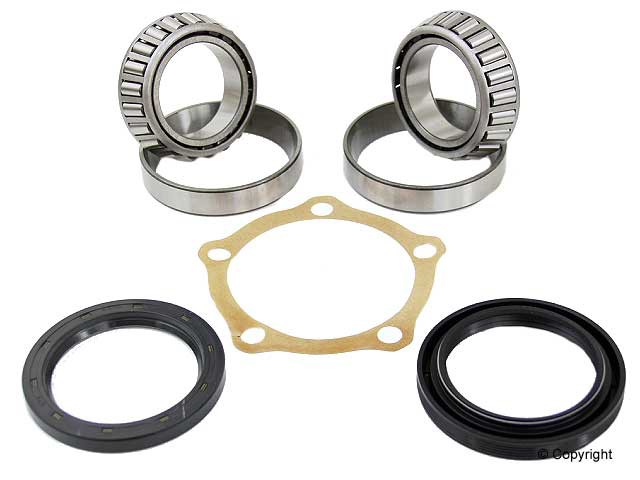

I bought this kit:
SKF Wheel bearing kit.
Anything else I will need or any helpful hints? The repair manuals I have say it needs to be shimmed and such but a Land Rover tech told me not to worry about it and it's pretty straight forward to just replace the bearing??
Thanks guys!

No shims in the D1 hub, though there is one in the front under the axle circlip but I never change them.
If you off-road I wouldn't use that seal on the right, they suck for keeping crap out of the hubs. RTC3511 is the way to go.
