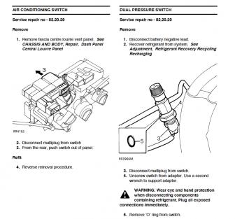

Default Got the switches out!
I just pulled some switches form a parts car. You need to take off the center louvre panel, then the switches can be pushed out form the back of the AC/Heater assembly.
Super easy once you dig in.
Attached Thumbnails Disco 1 AC issue-screen-shot-2013-09-29-11.15.35-am.jpg   Disco 1 AC issue-screen-shot-2013-09-30-8.46.43-am.jpg
