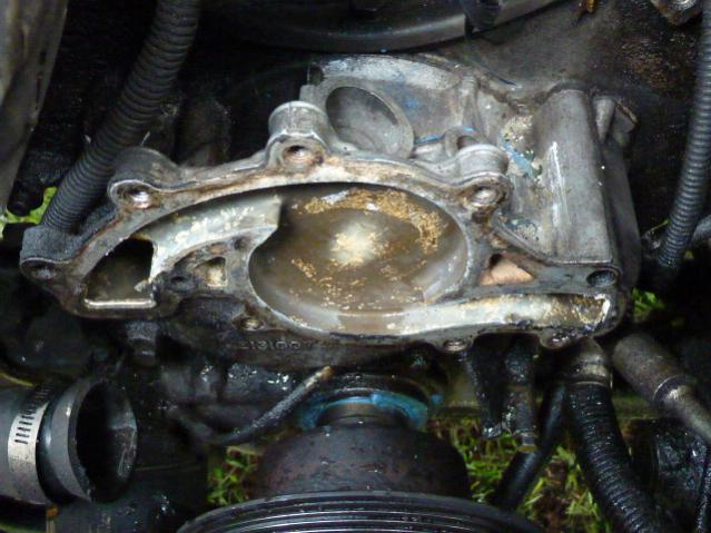

Here's link to thread that contains tool drawing and specs from Boris, also pix of RTV applied to crank seal area for testing purposes. Clean oil off first, a little alcohol or brake parts cleaner helps.
https://landroverforums.com/forum/di...nk+pulley+tool
