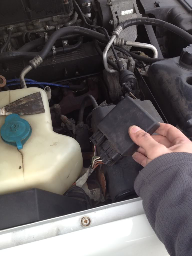

Old Dec 4, 2011 | 08:59 PM
jsingle3's Avatar
Joined: Dec 2011
Old Dec 4, 2011 | 09:18 PM
Spike555's Avatar
Team Owner
Joined: Jun 2007
Posts: 26,212
Likes: 98
From: Grand Rapids MI
Yup, thats it, replace it.
Old Dec 4, 2011 | 09:22 PM
Posts: 16,322
From: Savannah Georgia
That be it. BTW, see that black coolant container? They have a bad habit of cracking at the seam, major coolant loss, steam, etc. Worth your while for Santa to bring you a new white one.
Here's correct page from RAVE, you should already have it.
Check fuses 3 and 6 in underhood box.
Should be able to jump pin 4 and pin 7 (purple & white, white & purple) to make power hot thru inertia switch (worth a poke to reset) to the pump.
Don't leave pump running for more than a second or two if engine is not running, I believe the ECU turns off the pump if engine does not crank.
File Type: pdf
Old Dec 4, 2011 | 09:24 PM
JCSNGL10's Avatar
7th Gear
Joined: Dec 2011
Posts: 7
From: Kentucky
I had my brother post the picture after I found it. My relay has been extremely hot. The plastic housing was discolored with shiny purple/blue/yellowish coloring due to high heat. I sure hope it helps the next person with relay questions. It is definitely larger than any relay I've searched for. Google immediately had me going down the wrong path. I'm absolutely sold on the fact that "RAVE" should be every new owners first step after purchase. Second step LandRoverforum.com. You guys are great. Thanks again.
I will pickup a relay tomorrow. I believe the pump and relay were worked to death trying to push fuel through the clogged filter. I will let you all know my results.
Old Dec 4, 2011 | 09:32 PM
Posts: 16,322
re: I believe the pump and relay were worked to death trying to push fuel through the clogged filter.
IMHO your diagnosis is spot on.
Old Dec 6, 2011 | 12:20 AM
JCSNGL10's Avatar
7th Gear
Joined: Dec 2011
Posts: 7
From: Kentucky
Everything worked out as planned. ON THE ROAD AGAIN!!! I did have some small fuses in the engine compartment that tested good but when I checked the resistence with my meter it was high. After replacing those fuses, fuel pump and relay module came alive. Thanks again guys.
