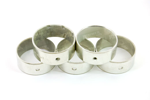

Eric do you have any pics of your front cam bearing???...at first I thought what i saw was damage....now it seems this is ...normal ? Please see picture here I found online the one with weird slots and such is what my front one looks like
...havent been able to get good pic of mine....

Unfortunately I don't have any pics of my old cam bearings. They're pretty hard to get a good look at in situ.
