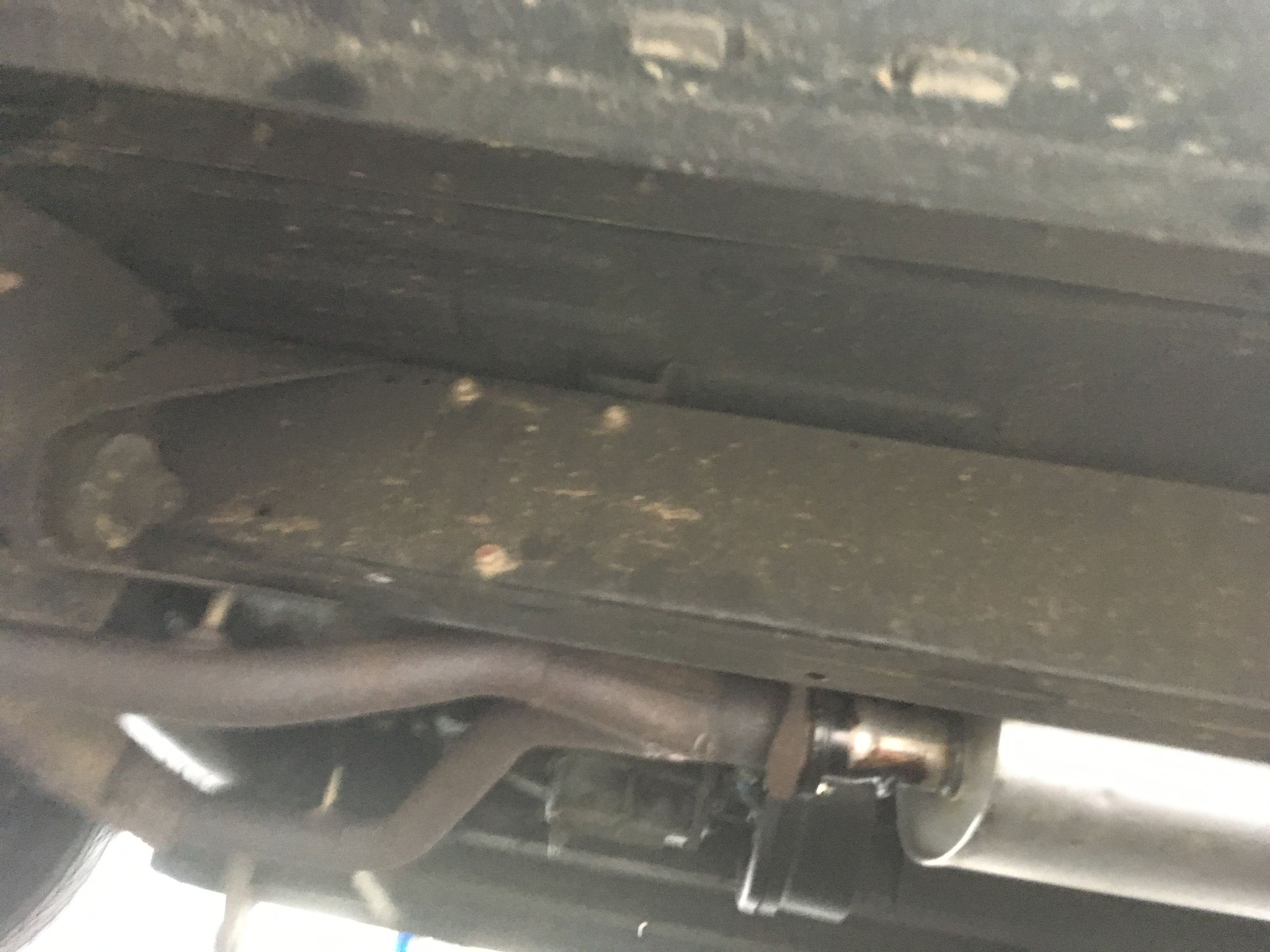

Got any pics of the new setup?

not the best, but there really isn't that much to look at either....

WOW that truck is clean/rust free, are you sure it's a LR?
The exhaust looks good, just give the welds a shot of exhaust primer/paint. They will start to rust quickly without being covered.
You don't need anything fancy just something like a $7.00 can of Duplicolor Engine Enamel from any Auto Parts Store.
Remember to wipe the welds with some acetone first and then spray away.

Over, thanks for that tip on the welds. I was wondering if that would be helpful.
The truck is a garage queen, that is for sure.
