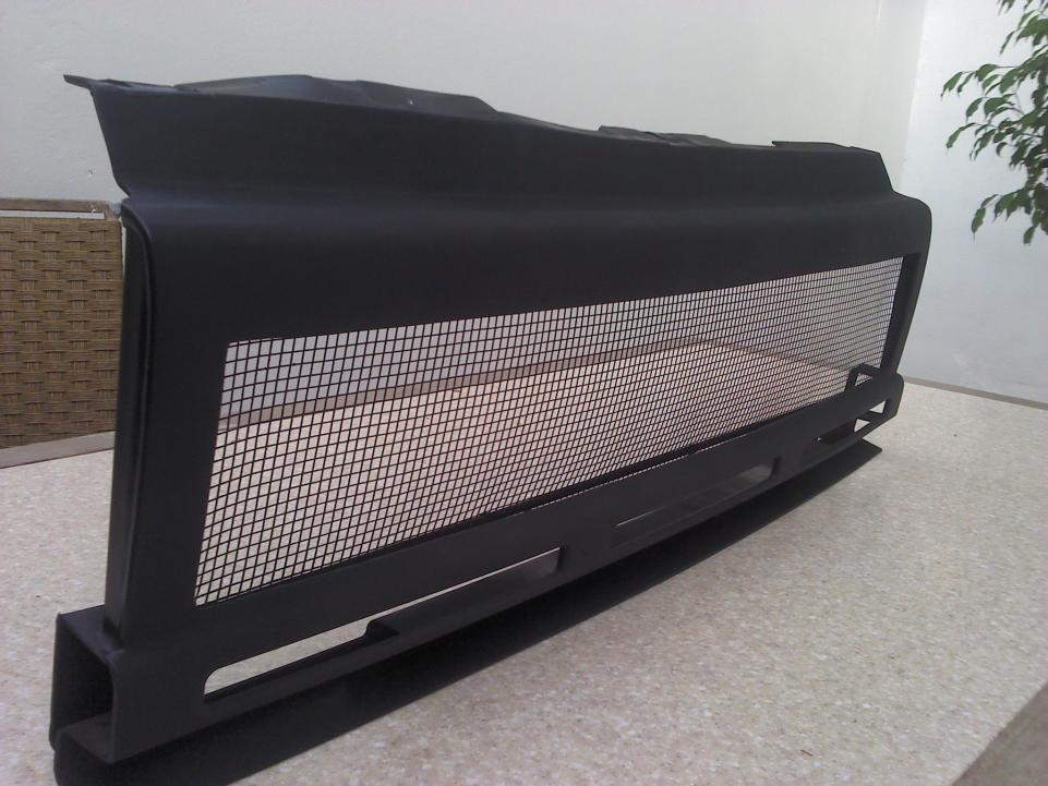

slanginsanjuan's Avatar
Joined: Oct 2010
Posts: 1,669
From: San Juan, Puerto Rico
I could not find any good grill metal anywhere that wasn't over $80. I used cheap hardware cloth with steel perimeter support. I spray prime etched it and then hit it with stovepipe paint. I painted the plastic parts with black plastic paint and then hit it with the stovepipe paint. I'm going to install the two pieces so that I can get the grill part out again should I find something I like better. I'm waiting to install until after I do the body work and wet sand, etc. so I don't mess it up. I'll probably hit the other exterior plastic bits with forever black or maybe even SEM bumper coater.
Try wiring the mesh to a steel perimeter. Lots of wire points will insre it stays straight. My stuff is pretty flimsy. I used threaded steel which I had laying around.
Attached Thumbnails mesh grill write-up-grill-one.jpg   mesh grill write-up-grill2.jpg

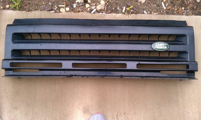

Old Oct 15, 2011 | 09:48 AM
  #108
Danny Lee 97 Disco's Avatar
Joined: Mar 2010
Posts: 5,584
Likes: 7
From: Pittsburgh PA suburbs.
I finally got around to cutting the expanded metal piece I had into two equal pieces. They were perfect height to reach from the bottom frame members where the front bumper bolts on all the way to the top of the metal edge at the top of the radiator.
The only part of the plastic grill I used was the top strip where it mounts to keep the expanded metal flush to the top. On the sides, I trimmed the upper corners to fit around the headlamp adjusters. Just a minor trim and it fit well. The sides are behind the headlights and the bottom edge is behind the bumper.
Pretty good fit. I was concerned about how to cut the expanded metal but my tin snips worked just fine cutting one piece at a time. I have a double layer of expanded metal slightly offset from each other to stagger the openings. It looks better to me that way instead of seeing thru the openings, that way the stuff behind the grill does not show thru. And it is very stout as well.

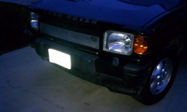

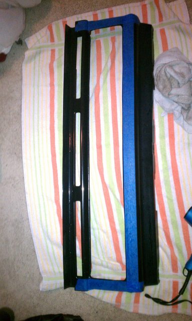

Old Dec 2, 2011 | 06:04 PM
  #109
Robert Tuma's Avatar
Joined: Nov 2011
Posts: 22
From: Dallas, TX
Default Just did mine today!
Took me all day, but I think that it turned out really nice
Old Dec 4, 2011 | 10:06 AM
  #110
Joined: Oct 2010
Posts: 1,669
looks good. would be nice to see a better picture of the after.
