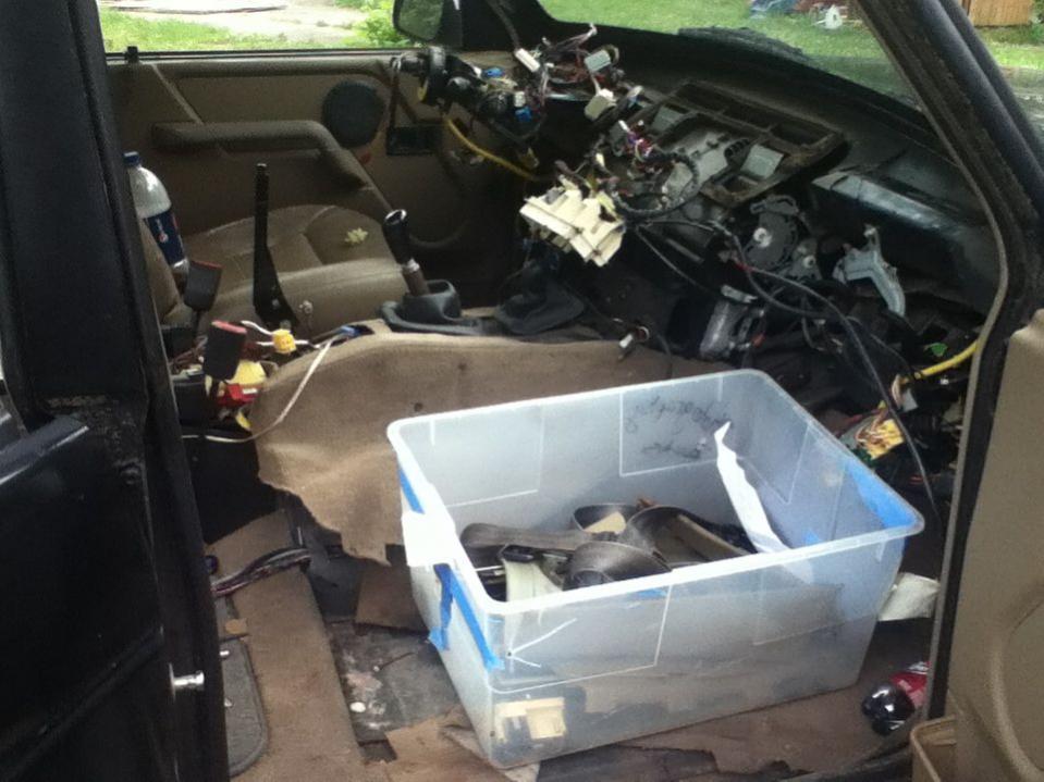

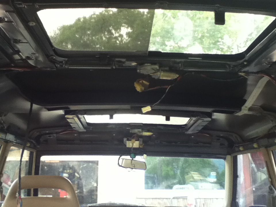

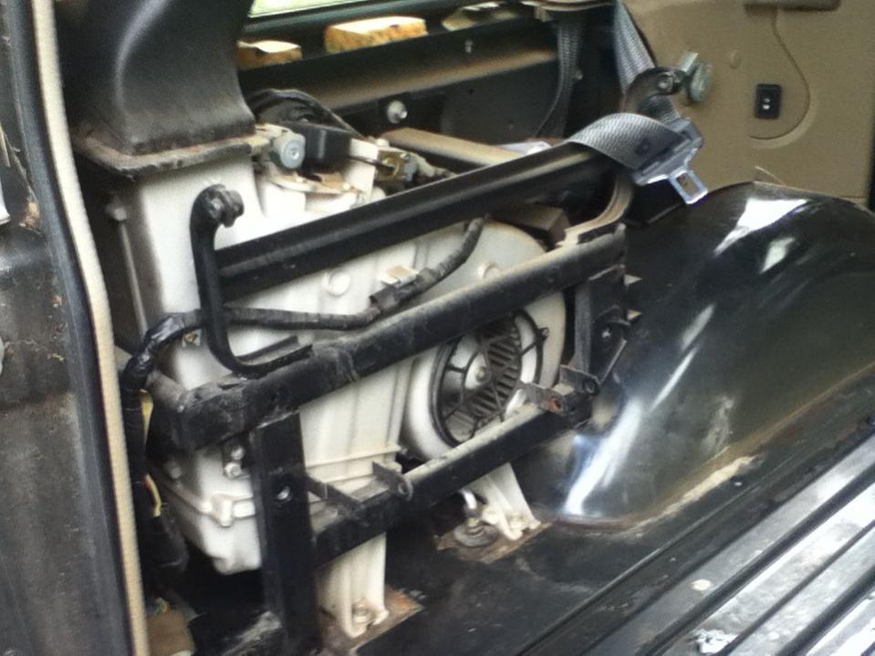

played with the truck a little more today. Started the tear down, almost finished completely pulling the interior. Ran into a little surface rust and hit that with some phosphoric acid. Stripping the truck gives me the change to really go over everything, remove and of the old harness I don't need anymore etc. I'll be rhino lining the floor or something similar before it goes back together.
Dash looks to be to gone to save. PO's tore it apart trying to get a stereo installed... plus of course the glue issue... I'll just have to find a decent one in a parts truck.

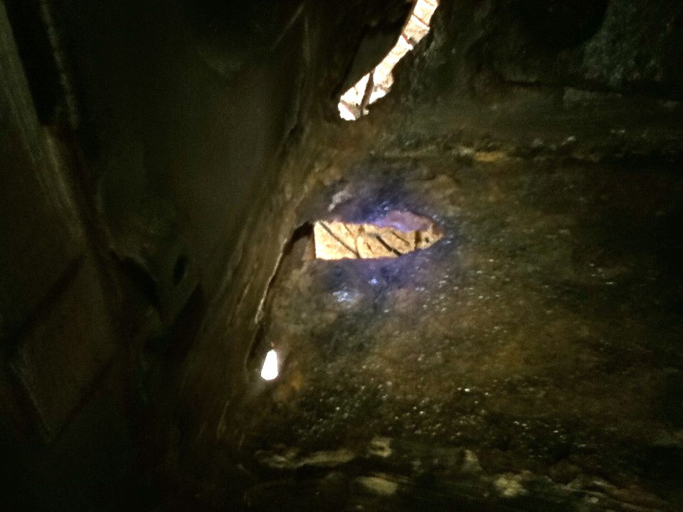

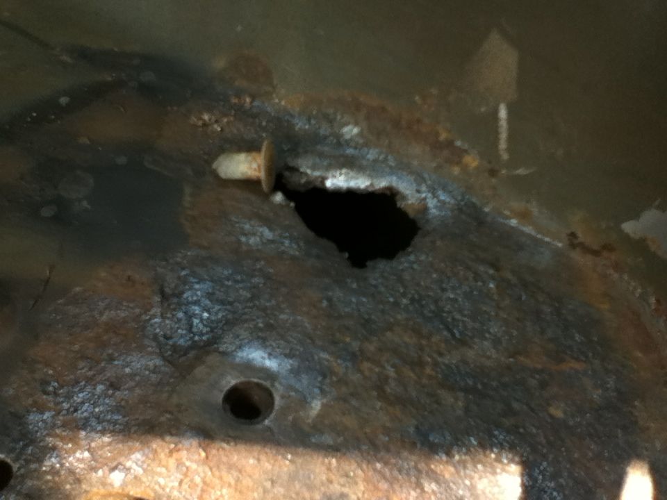

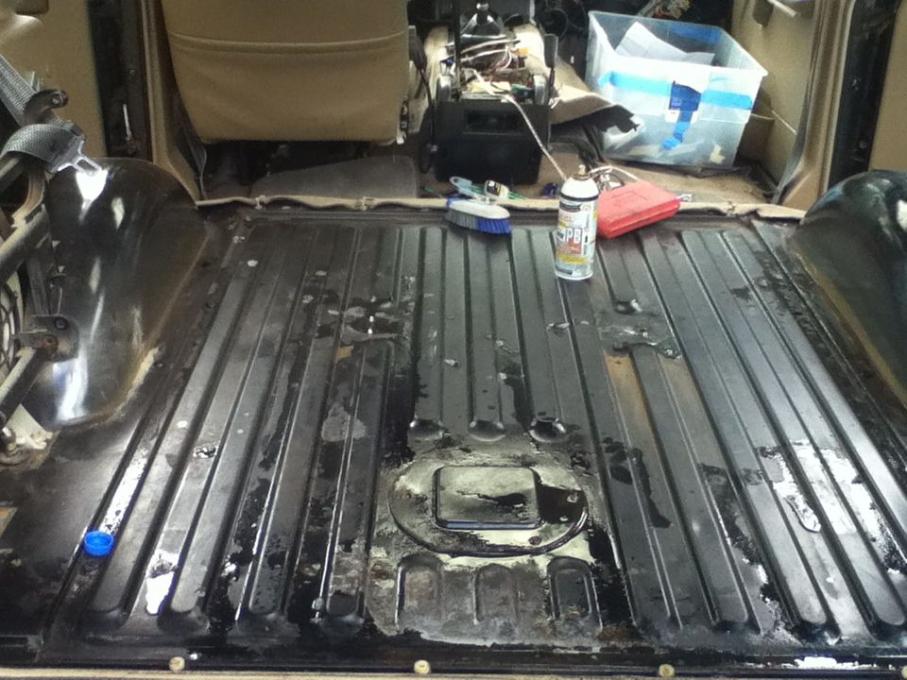

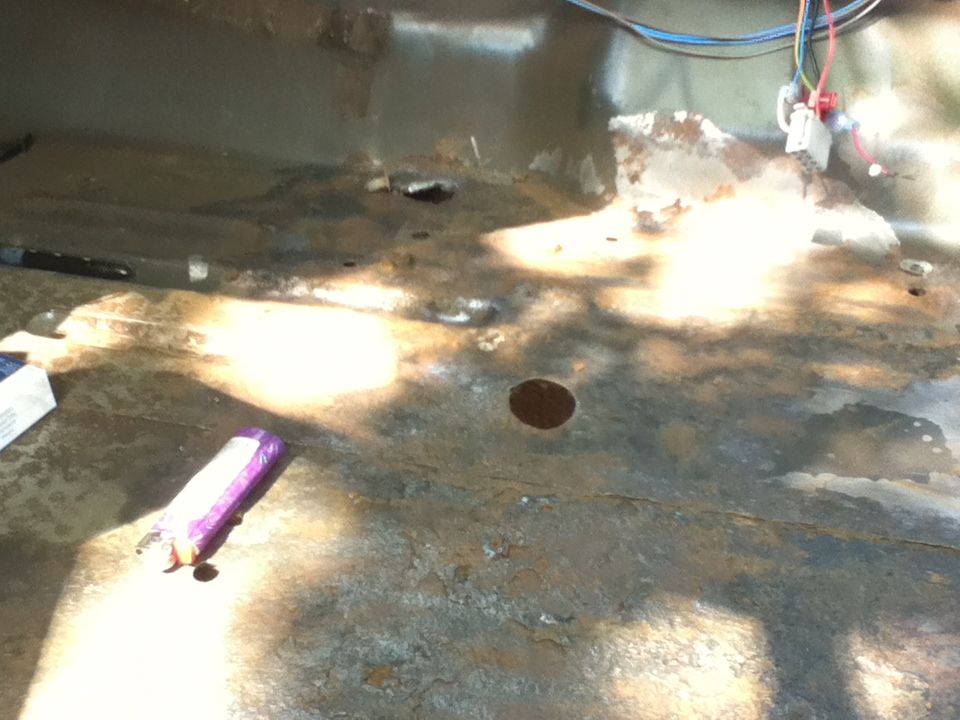

Stripping the inside it done. Sad to say, but I DID find a little rust. The padding itself was damp and stunk. I'm glad I took it all out. So I'll have to cut those little sections out and weld in some new steal. Could have, and would have been a LOT worse if left alone...

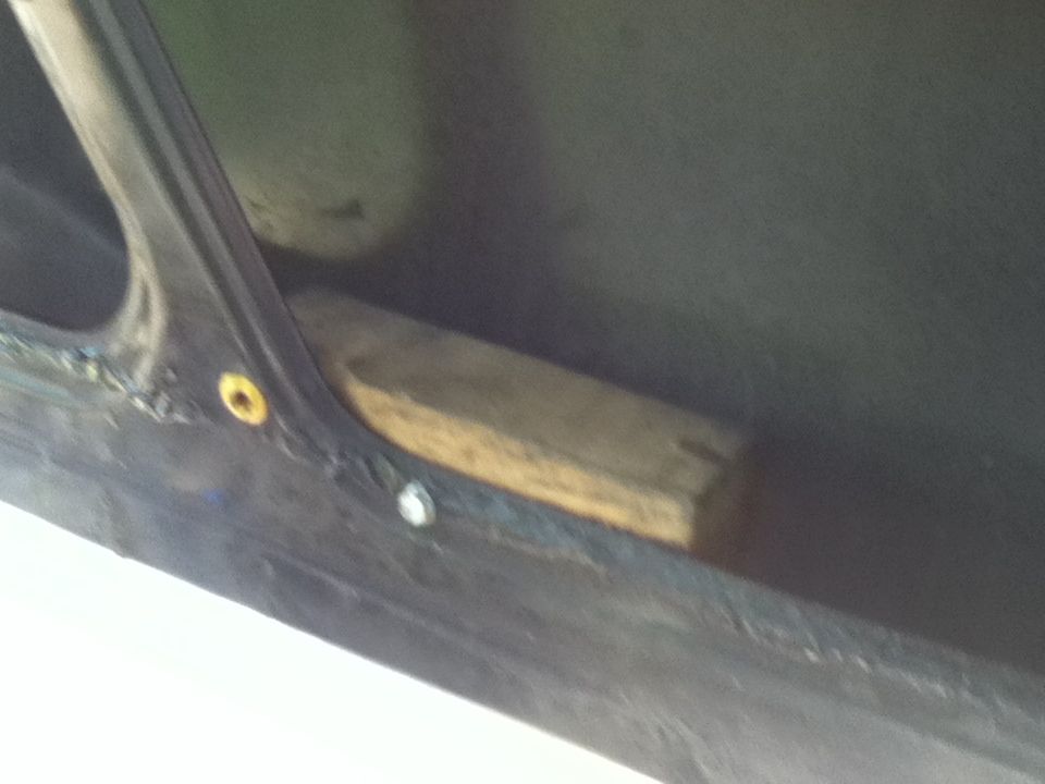

Check out this repair in the drivers door... to prevent you from rolling down the window all the way... something else to fix.

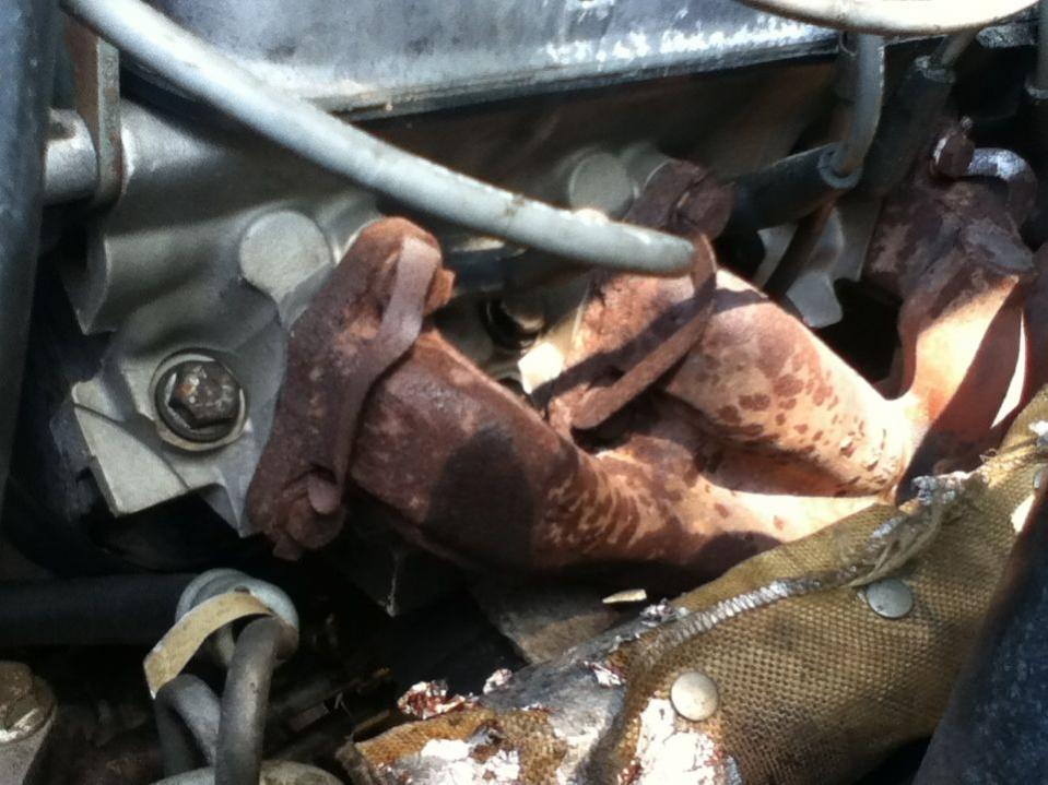

Also, look how clean the heads are on this engine... they have obviously never even been driven (except for the little I've done which is only a couple miles)

Originally Posted by pinkytoe69
Where is that rust?
Drivers side floor. The corrner up by the clutch. I've already ground it, tomorrow I'll cut and weld what I need to to fix it and hit the area with acid. Then give it a good coat do rust oleum. Should be good until I get the spray bed down.

Ok. My F350 sold yesterday, guy will be picking it up and paying balance on friday so I now have the funds to put toward this project. Not a lot to report, I cleaned up any rust I found, hit it with phosphoric acid, let it turn and dry, then painted everything with flat black rustolium for now. It's been crazy hot here the last couple days... record breaking. last thing I want to be doing is sitting inside a black land rover welding. So hopefully I'll have the 2 small holes I discovered repaired by this weekend.
