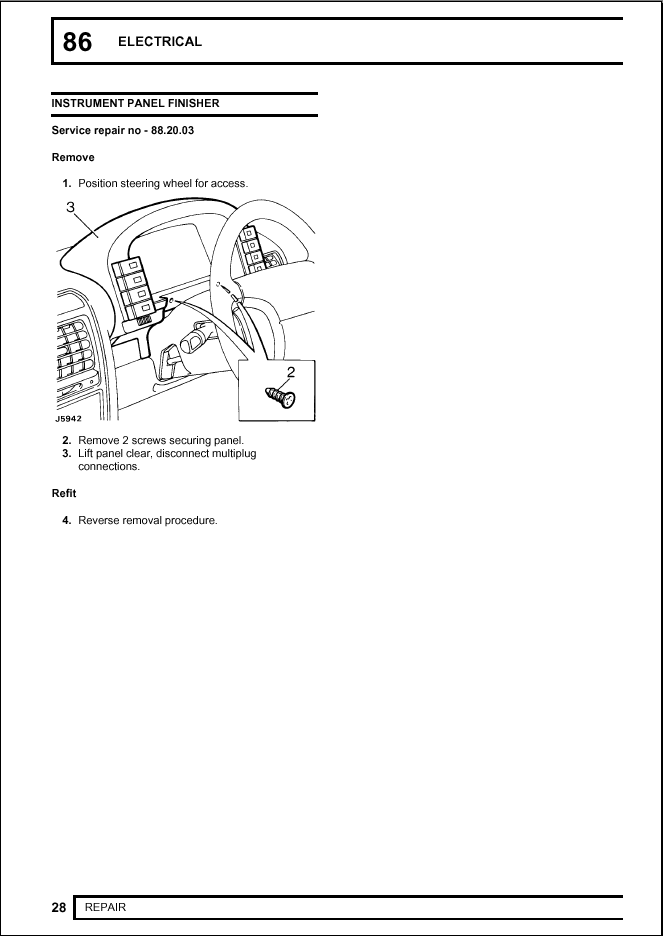

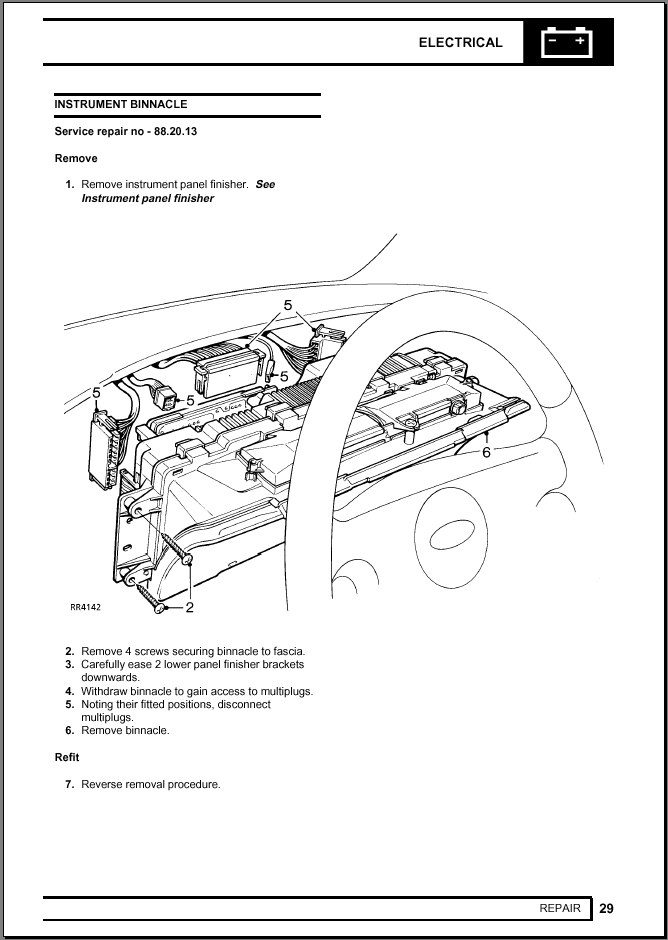

Thanks, yes the rubber gasket was still there and it was in good condition so I just cleaned it and put it back into place.
About the light I suppose I should pop open the gauge cluster and take or look at the bulbs.

Here are the pages which include the info for removing the instrument panel to get to the lights
Attached Thumbnails p0300 random misfire and p0451-capture848.png   p0300 random misfire and p0451-capture849.png   p0300 random misfire and p0451-capture850.png
