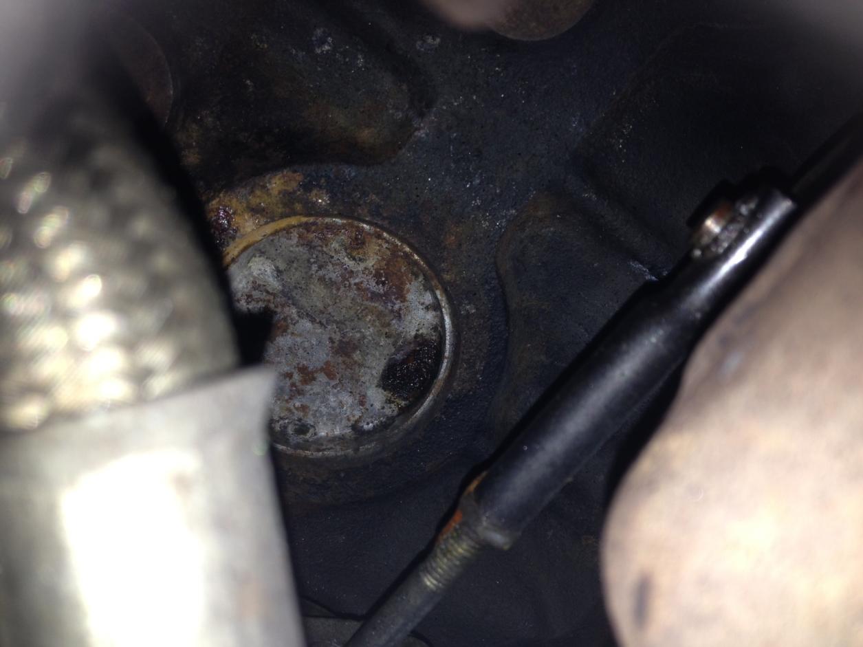

Talking may be relevant
My 95 disco td 300 had a tiny coolant leak took ages to lose a tank of coolant.
It ended up being a welsh plug rusty on turbo side of engine.
I only noticd leak with engine quite hot and i was lookin in turbo area after
manifold gasket replacement.
I ended up sealing over plug with a oil resistant sealent, as i couldnt face removing manifold again <grin>
