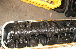

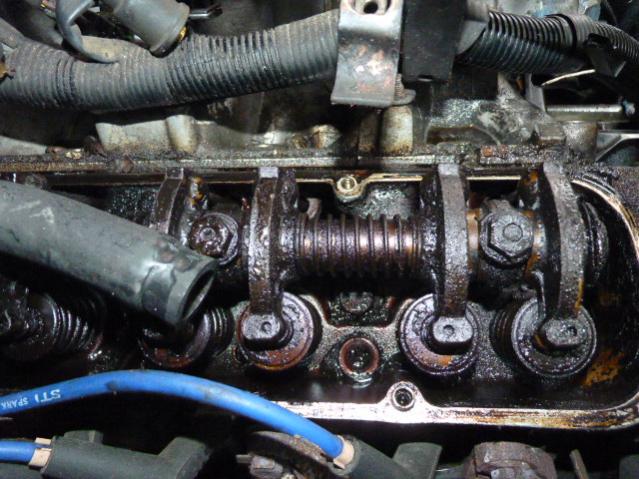

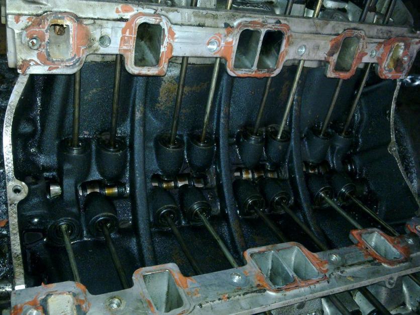

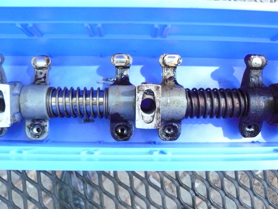

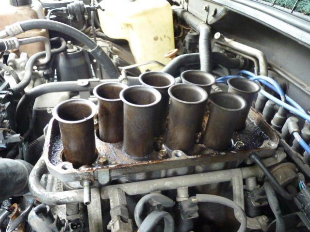

When you consider what the inside of a high miles neglected engine can look like, part of a can of Seafoam will just get a little of what is in there. There are industrial level solvents that will get it all, but they eat away all the seals as well. People have all sorts of "liquid mechanic", from kero to ATF to fancy formulas. Anything that works real fast can break down the sludge into chunks that clog up the oil intake screen. Slow over a period of time would be better.
In one of the pix you can see where the Seafoaming got a little of the intake cleaned up, but mine were so dirty that several Seafoams did not clear them off. On the D1 the PCV system puts oil fumes into the intake to burn, but some of it coats the metal and attracts dirt. In mine the hose from the driver side was bringing in oil as the PCV on the other side was blocked up.
Seafoam and other such wrenchless formulas may keep a clean engine running clean, but can't take on the severe sludge. Frequent oil changes are best thing you can do if you have a clean one.
