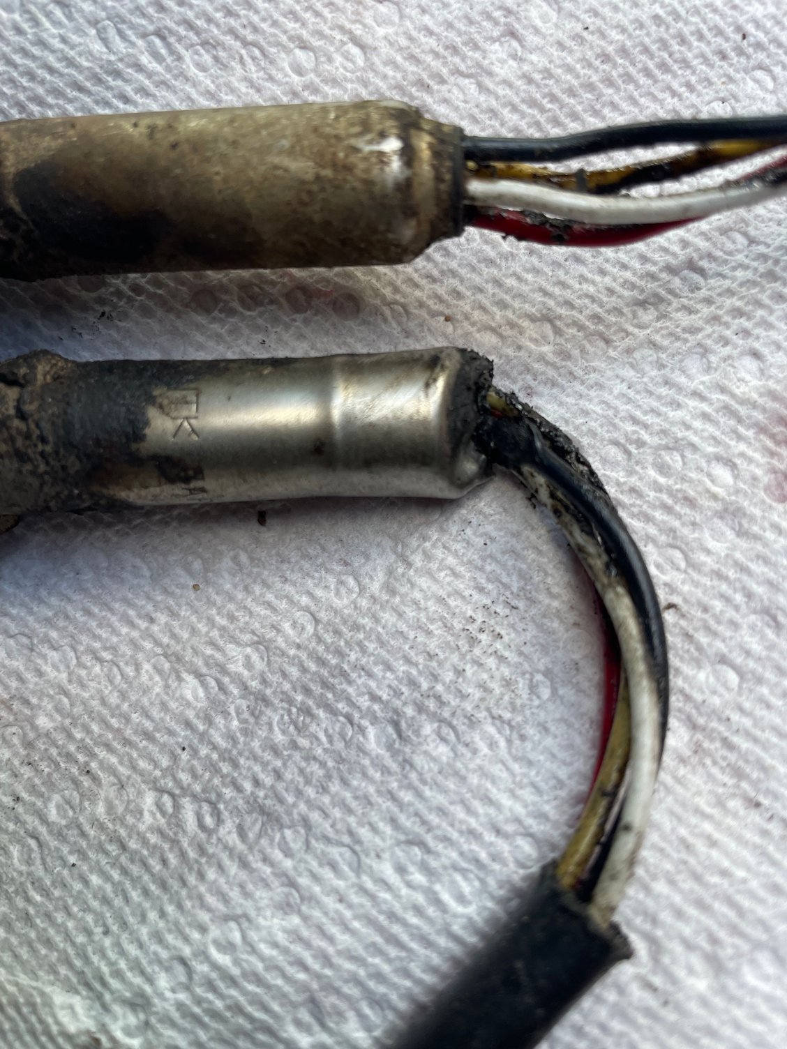

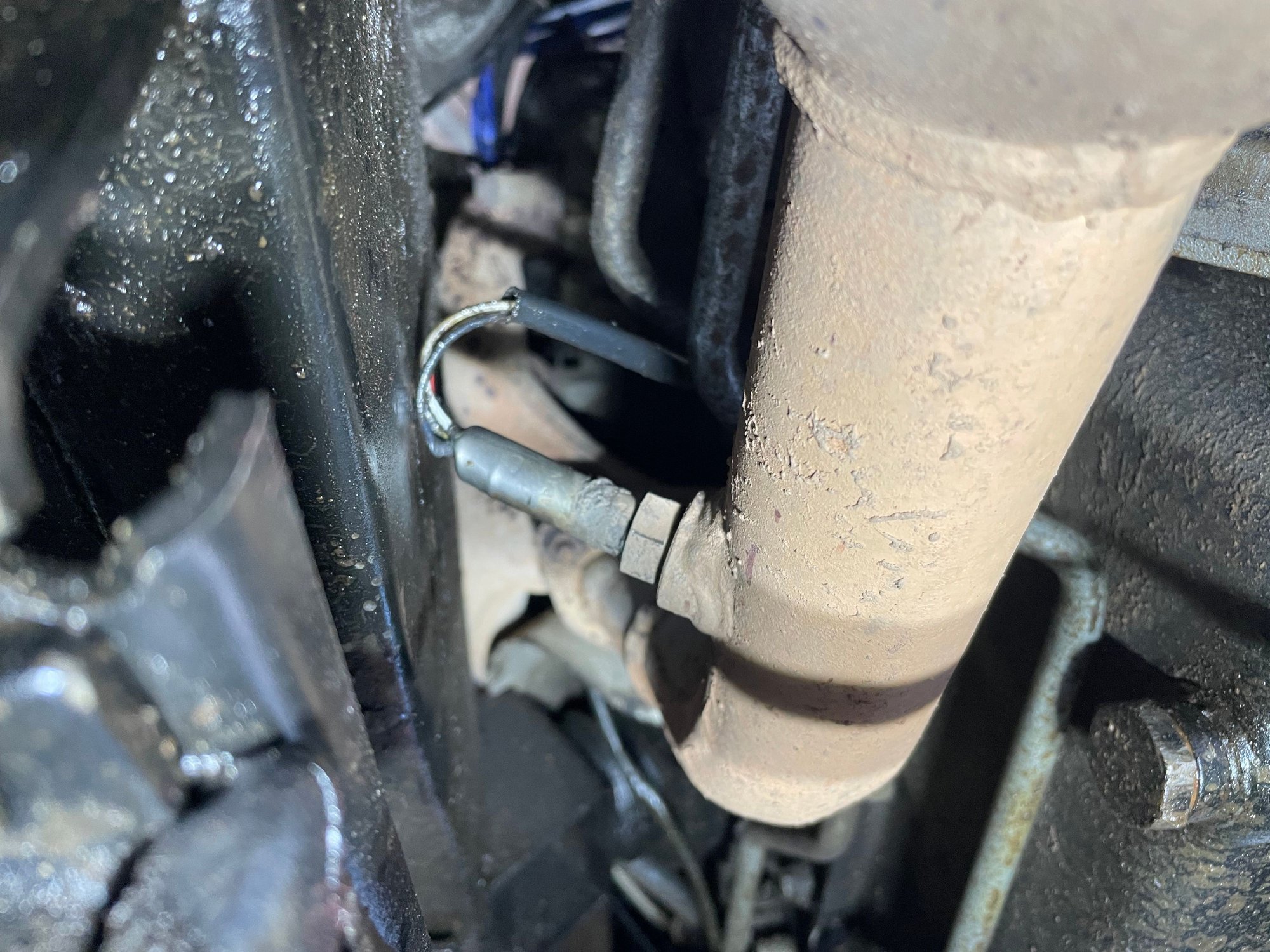

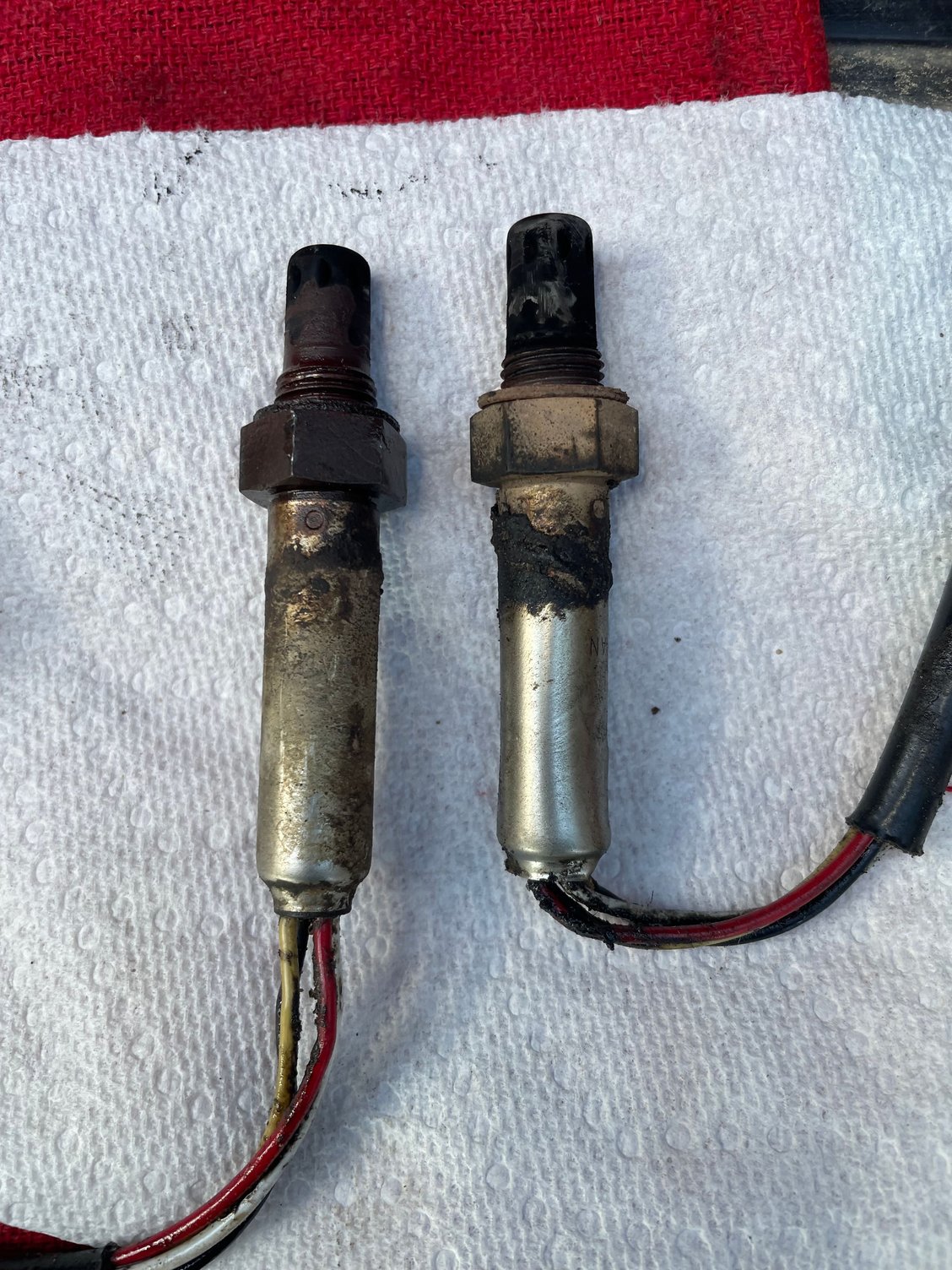

So I swapped the b1s1 for b1s2
That was easy enough. Now, b1s1 is talking. S2 is now stuck at 1.020 like it was before I swapped it.
The sensor was damaged when I hit that boulder that cracked the oil cooler in the plastic radiator.
You can see in the pics it’s “crimped”.
Just happy to get this sorta sorted out. We left Zion NP yesterday and still have two weeks of vacation to go.
