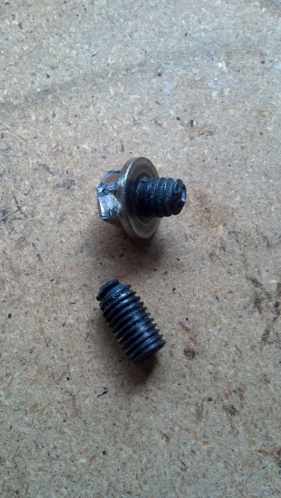

Originally Posted by fishEH
Tell 'em about the pinion bolt, Ian!!

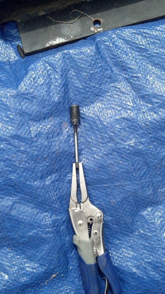

Here ya go Brett...if your pinion uses a bolt instead of the 24mm nylock nut do NOT torque it past 100nm or 74 ft lbs. If you get in a hurry and forget to use common sense and try to torque a 12mm grade 8.8 bolt to 130nm or 96 ft lbs it will end up looking like this and you will have a OH **** moment!
Thankfully this worked like a champ
