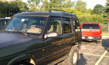

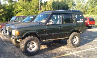

Added some window vent shade things. They were cheap and a Christmas gift so I figured why not. I like the way they look, they'll keep the rain out while having my windows cracked, and I have somewhere to rest my hand when I put my elbow on the bottom of the window frame.

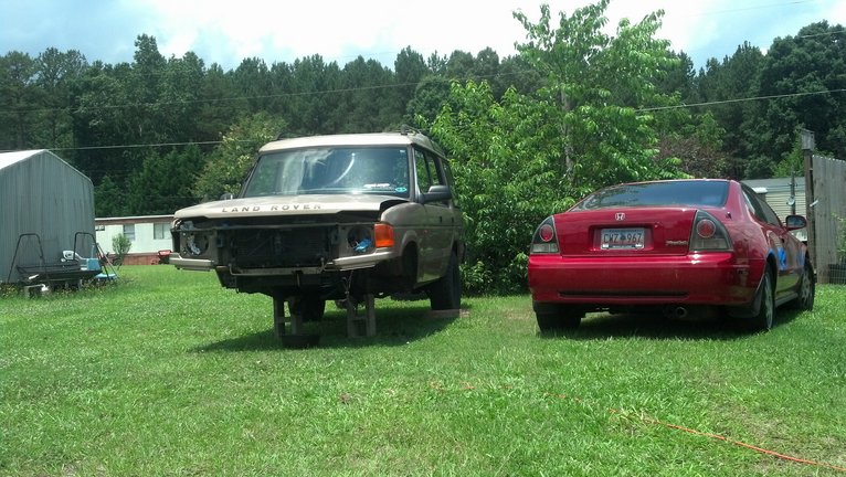

Took my yard to the redneck level. I hope its dark out when the wife gets home. All that's left to do is pull the rear wheels and a few odds and ends and she is crusher bound. Gotta make room for the new one!
