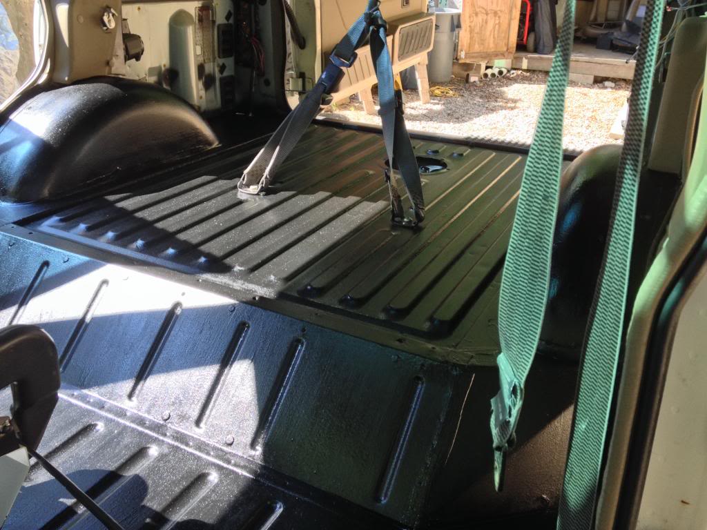

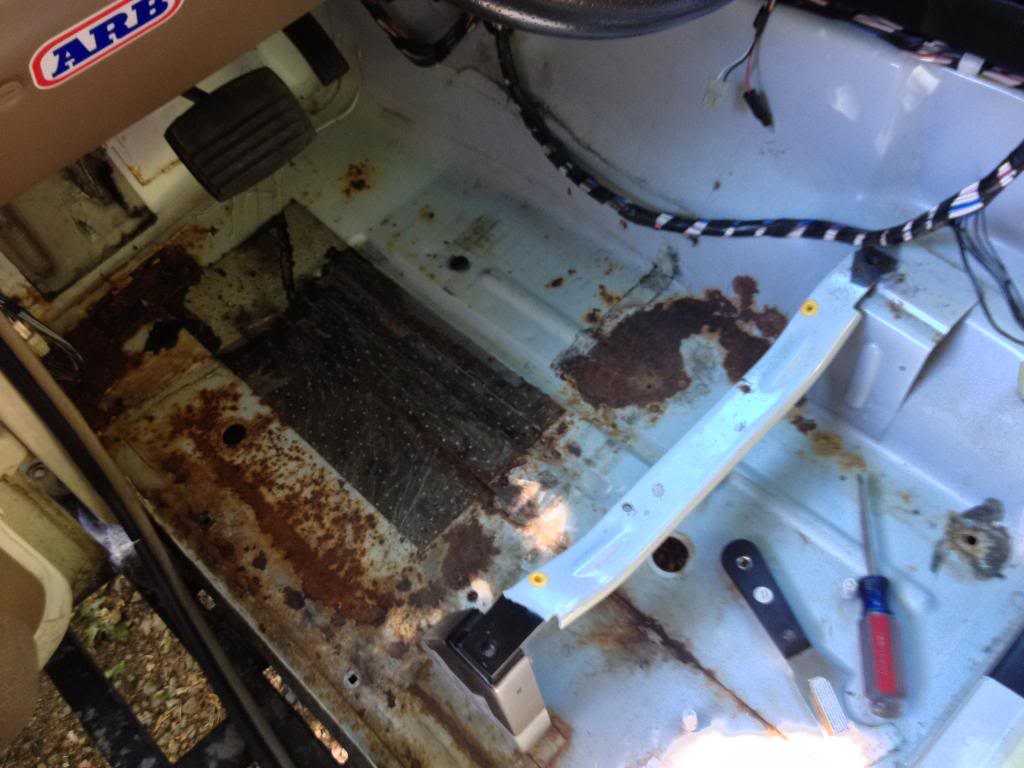

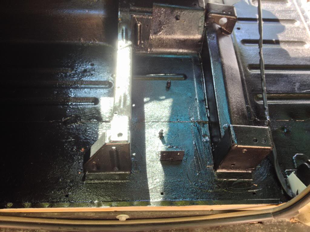

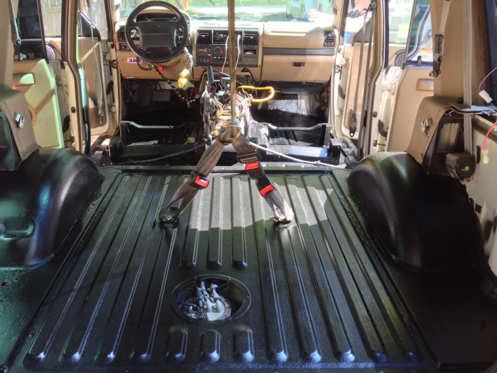

Finally got around to bed lining the floor got two coats down just gonna wait til l tomorrow to put all the interior back in. Couldn't have done it without a hand from my girlfriend Name:  E26EE363-9B9B-4C6A-9C3E-CF3D41AFBEFD.jpg

Looks great! What kind of bedliner did you use and how much did it take?

Thanks! I used the rust oleum, I have it on my sliders, headliner and rims. I bought a gallon and only used half for two generous coats

Rustoleum is the roll-on brand I use, it's not as lumpy as the others. However, from my experience, it's just a little better than paint, in that moving things around on it will scratch right thru it. It's good for things like lower body panels, hood, roof, etc, but if it's going to be subject to sliding things on it, it won't last.

It's all about the prep work when painting, if it scratches right of when you slide something across it, you obviously didn't scuff it or clean it enough/right.

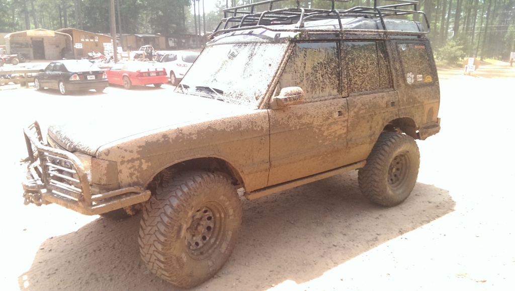

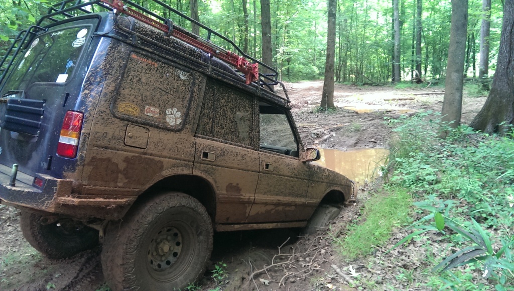

Got real stuck and dirty. Do not attempt 36"+ deep mud holes when wheeling alone. Luckily I was able to get out and then pull a Jeep out.

Tweaked the bumper a bit winching out. Looks like it deformed the frame bolt holes from a brief look.
