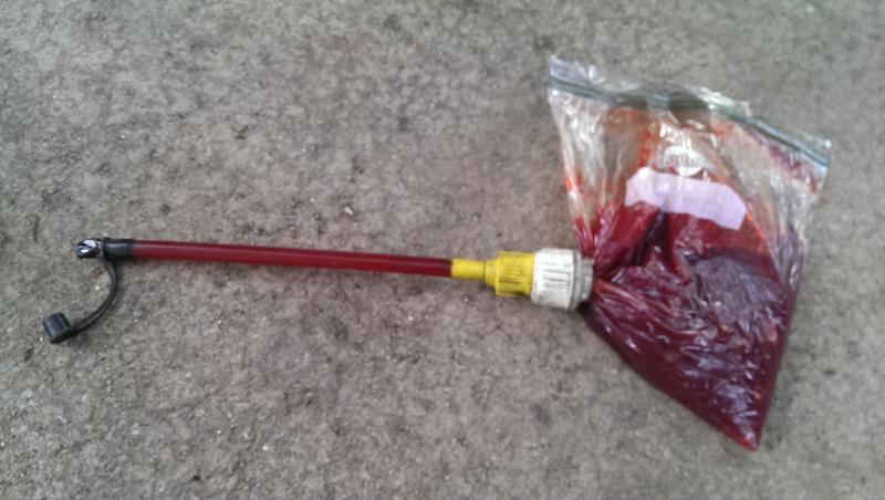

Swapped out my rotors, calipers, hubs, swivels, and axles/CV's on my '96 with the ones from my '95 in one fell swoop. Unbolt the swivels, pull the whole assembly off, and bolt it on the new axle housing.
Also mixed some grease and gear oil to put in my swivels and made a DIY filler for them.

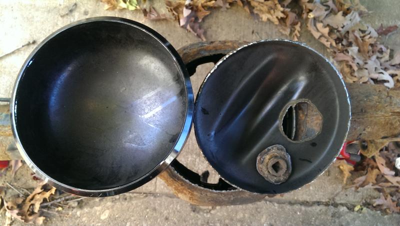

Also used my plasma to cut out the fill bung and the diff cover. Here it is compared to the sewer cap.

Love the bag idea
I used to make knuckle butter that way for our usgi vehicles, now I will just buy the oo grease from lawnmower shop,is cheap and local for me plus less mess
Wow I see why the sewer cap works, don't think we can do that
