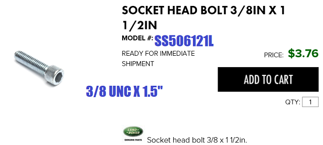

Default Starter Replacement - Almost
I went to install a new starter, but the replacement starter mount bolt that I got at the hardware store (because I stripped one taking it off) doesn't quite fit. 8mm hex, 10mm, coarse thread. Looks close on inspection, but the thread patterns are definitely different. DOH! Anyone have suggestions?

The starter mounting bolts (SS506121L) are not metric, they are 3/8" UNC X 1.5"

Well that would explain it. They fit perfectly and the job is done. Man that heat shield is a pain to get back in.
