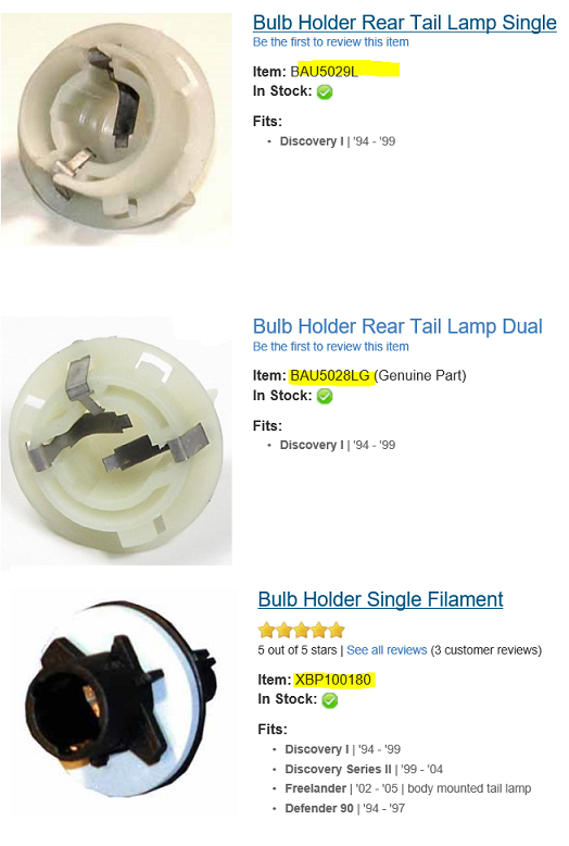

AB has sockets but I'm sure L8, RN, and Trevor @ RovahFarm will have them too.
Any way you go the sockets are not expensive at all.
> https://www.roverparts.com/nxt/?keyw...on=Discovery+I
> https://rovahfarm.com/DiscoIBodyElectrical.htm
it was RovahFarm that i ordered new from. always had good results with Trevor.

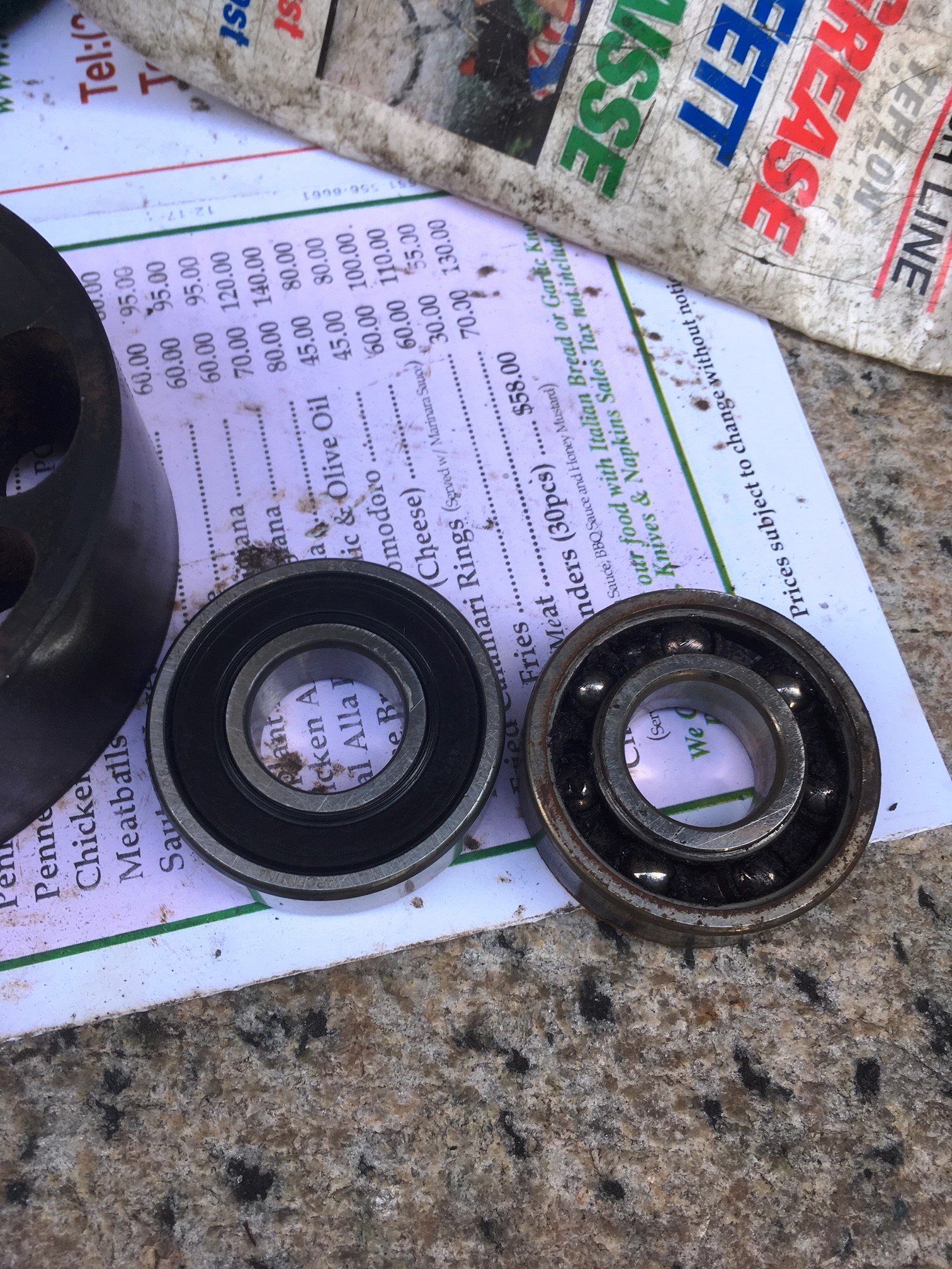

From: NYC
belt tensioner pully bearing. SKF 6203-2RSJ
It was the original and wasn't showing any specific signs of deterioration...but after 22 years it was time.
