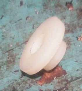

Ace Hardware has nylon bushings that will replace the bushings that come with the discovery. Here is a pic of one.
That's a 1 inch with a 3/8 hole.
I used a 5/16 T nut, outside diameter 3/8 fits right inside the bushing. I drilled a hole in the end of the T nut, drilled a 3/8 hole in the regulator arm put the T nut through the regulator arm, put a washer then a cotter pin.
