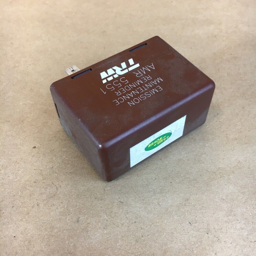

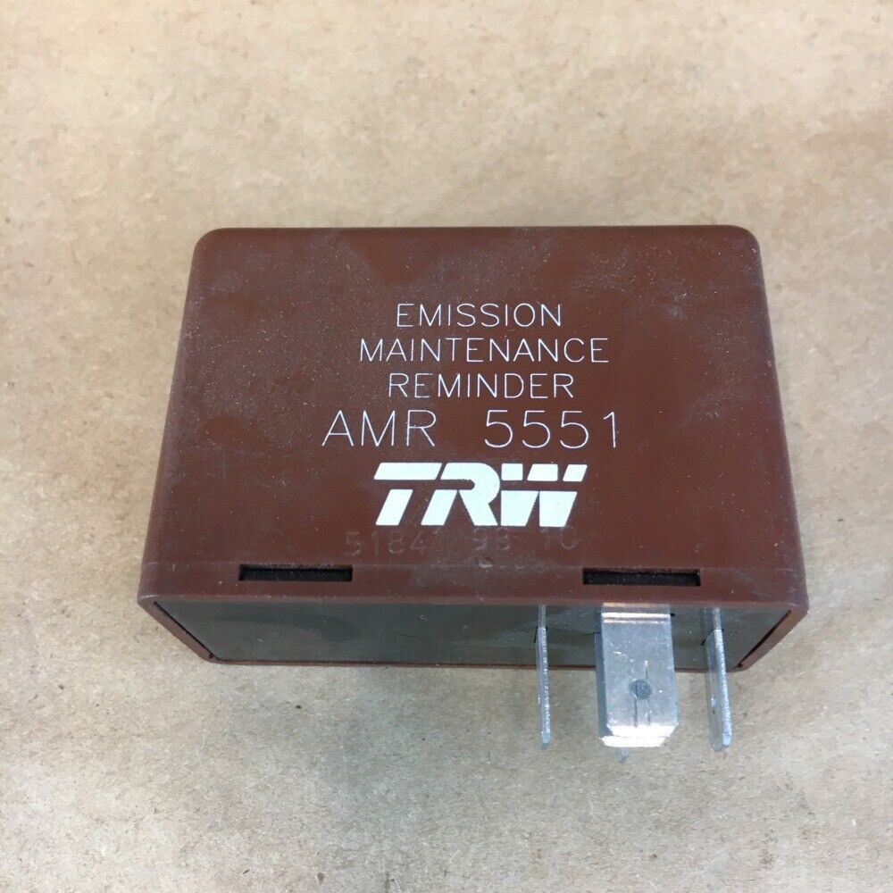

I tried for an hour and can't find the relay that turns off the "Service Engine" light, the red relay isn't there
https://discoweb.org/oldsite/reset/index.htm
Old Jun 14, 2023 | 01:46 PM
  #4622
disco96sd's Avatar
Joined: Dec 2019
Posts: 1,017
Likes: 204
Passenger side - kick plate in front of the door
These are only on the CA models I think - it is a 'reminder' to replace your CAT oxy sensors which no one ever did
I just removed my module when it came on at about the 105K miles - (it times about every 55k miles - the dealer had punched the hole in my module the first time as part of a dealer service many moons ago.
The service engine light will still light up when you turn the ignition on as part of all the other idiot lights even with the timer module removed
The module is brown and has TRW on it - see picture - the little green land rover seal on the top is just paper and as Walt's instructions show you just push the pin thru it and trip the relay

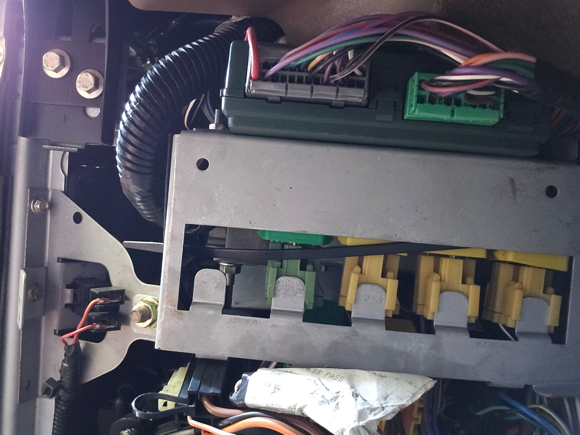

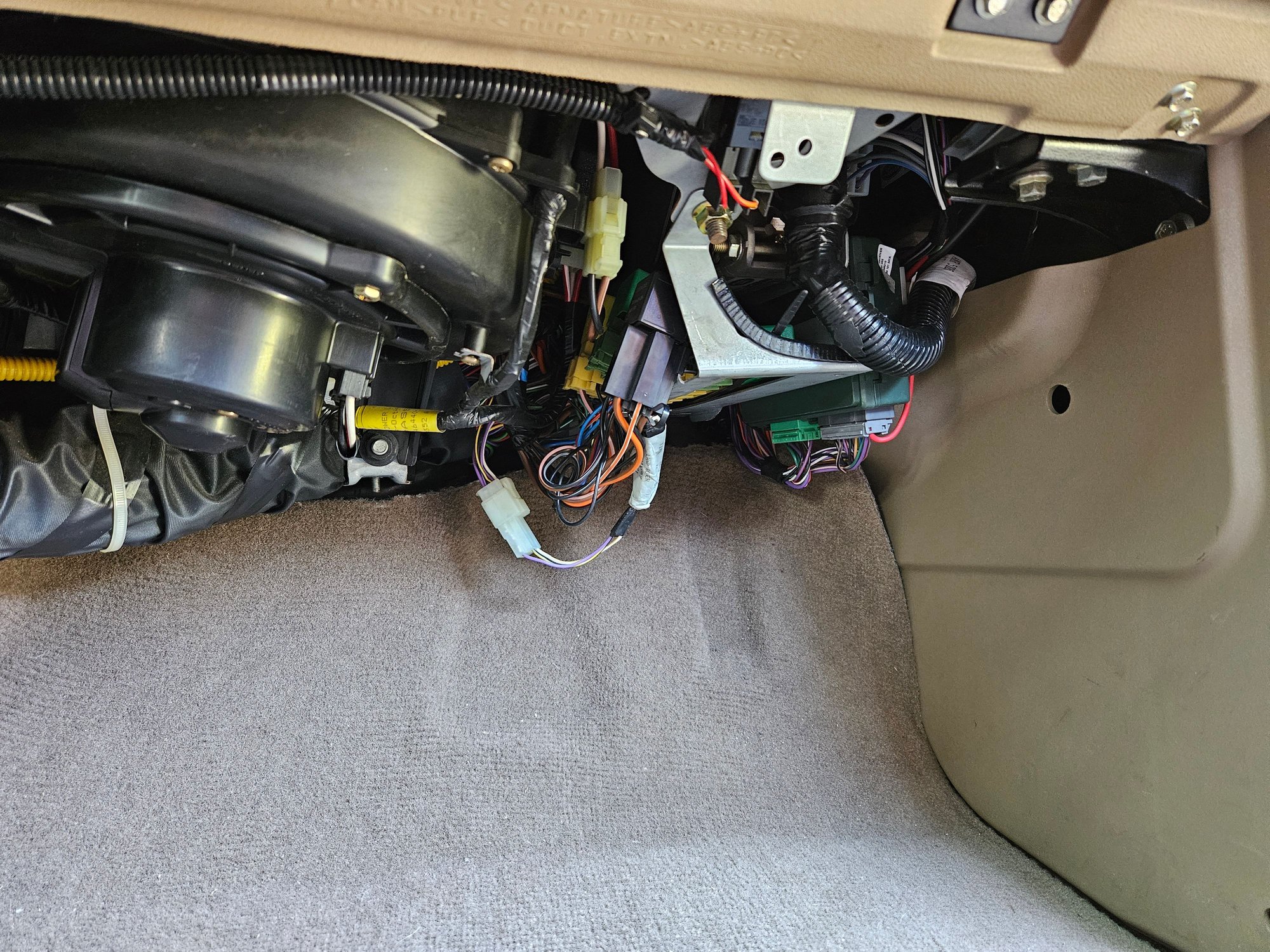

Thanks all, I have seen those instructions but mine doesn't look like that image, it may be hidden up there somewhere, just not where the instr photo shows

I found it, I didn't remove the kick plate.
Old Jun 16, 2023 | 07:23 AM
  #4625
disco96sd's Avatar
Joined: Dec 2019
Posts: 1,017
Likes: 204
Yes behind the kickplate

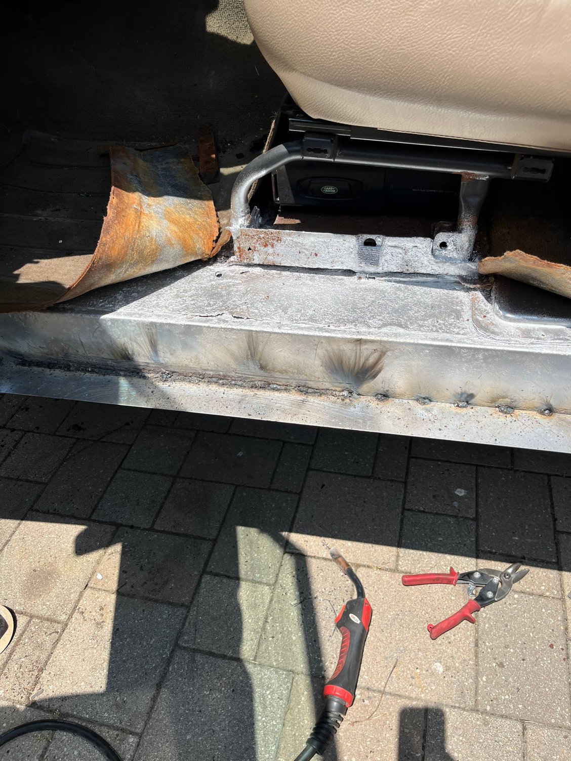

  #4626
Fastercat's Avatar
Joined: Nov 2017
Posts: 788
Likes: 295
From: Amherstburg Ontario
Building new rocker panel

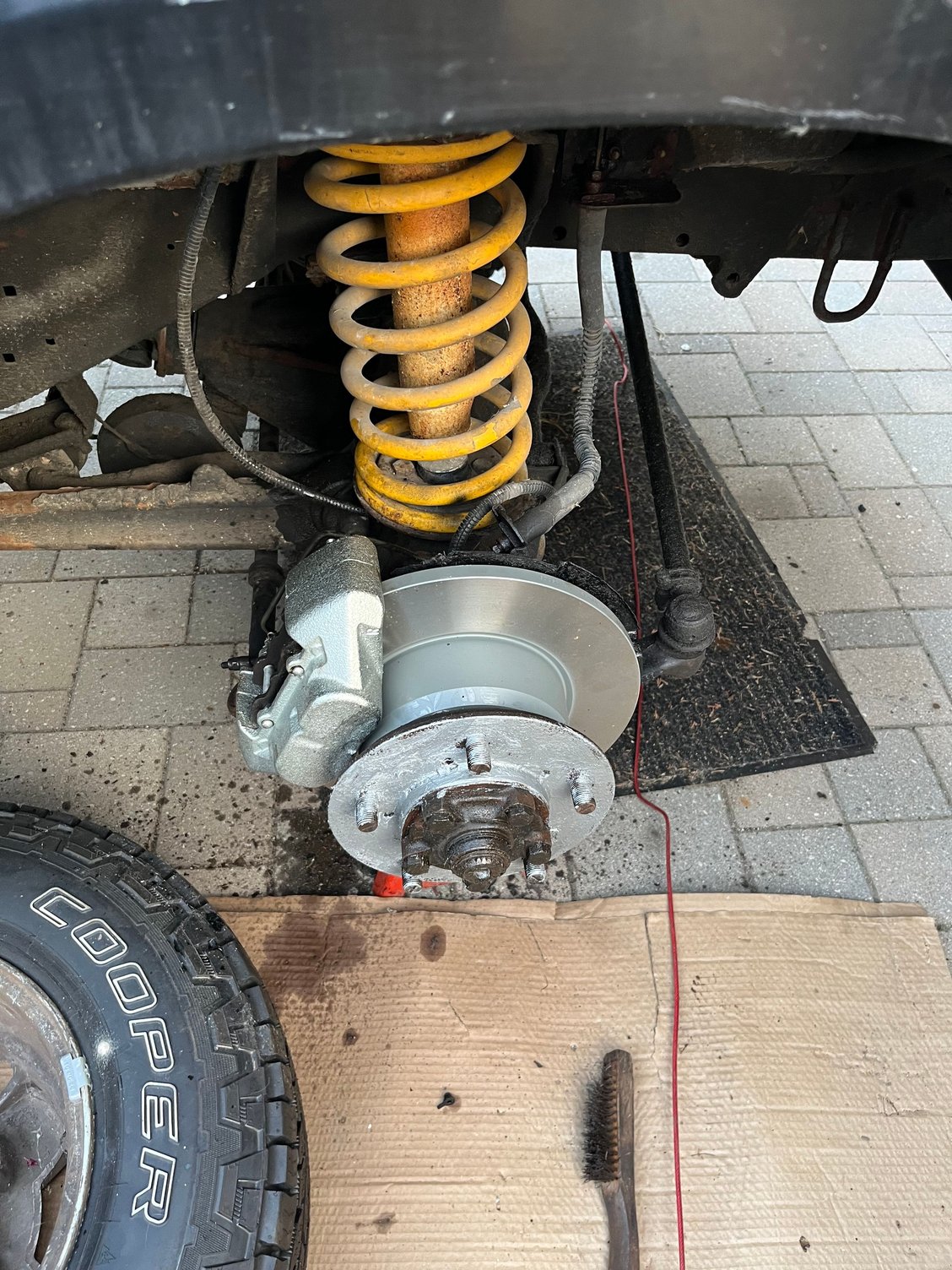

New front brakes done and bled.

Did you put new rotors, I have replaced pads a few times but I really need to do the rotors, one shop has a lathe so they can do it on the vehicle but I will have to see if they are in spec and can be turned. One shop quoted about 3K to do the rotors & calipers and Master, that is pulling the whole thing apart.
I do most work myself but don't want to come up against something I can't fix and can't hire someone to look at.
Old Jun 21, 2023 | 01:29 PM
  #4628
WaltNYC's Avatar
Joined: Mar 2010
Posts: 2,787
Likes: 628
From: NYC
It isn't that difficult....
https://landroverforums.com/forum/di...62/#post273923
You can download the service manual (aka: RAVE) in the link in my signature. Ask us questions and save a couple thousand.
I just did my fronts (and discovered I need new calipers).
For rotors I used Brembo:
https://www.rockauto.com/en/moreinfo...&pt=1896&jsn=2
And Akebono pads:
https://www.rockauto.com/en/moreinfo...&pt=1684&jsn=1
You'll need some paper gaskets and perhaps a new seal (use RTC3511 which is a Defender part number). Roverparts.com is a good source for the little stuff.

...also
I replaced my passenger side swivel ball and new front brake rotors and pads (both sides for brakes).
Old Jun 21, 2023 | 02:30 PM
  #4630
Fastercat's Avatar
Joined: Nov 2017
Posts: 788
Likes: 295
Yeah I did new pads, rotors, calipers and regreased the bearings.rear brakes are next. Hopefully the calipers are good. Everything is starting to add up, new interstate battery too. Lol
