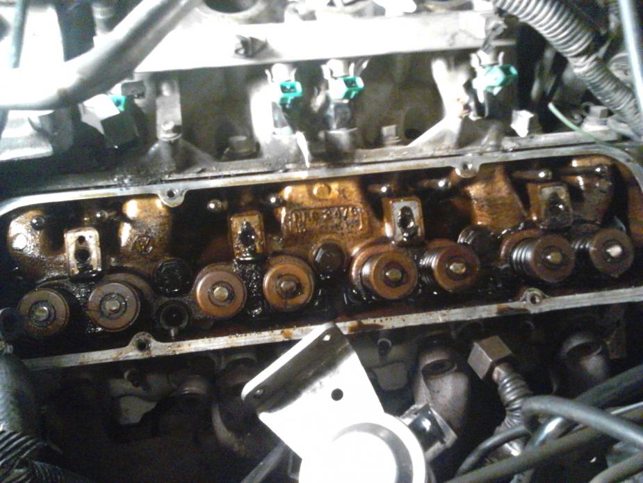

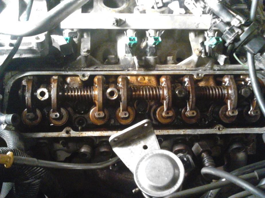

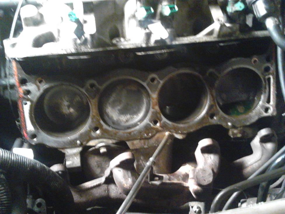

doing the head gaskets,got the drivers side heads off.got all the passenger side head bolts out except for the the 2 according to the workshop manual.i have tried using my ratchet,breaker bar, last resort my impact. it seems like i cant get a good grip on the bolt.using only the ratchet or the breaker bar and the socket i cant break it loose.using an extension i cant get a good grip because the firewall is in the way,same with an impact. anybody else had this same problem?
the number 2 bolt is the one closest to the firewall on top
Attached Thumbnails 2000 disco 2 head gasket job-picture-003.jpg   2000 disco 2 head gasket job-picture-001.jpg   2000 disco 2 head gasket job-picture-005.jpg   2000 disco 2 head gasket job-picture-007.jpg

I used a short extension (3 "?) for breaker bar to socket, and a 24" length of "cheater" pipe slipped over the handle of the breaker bar.

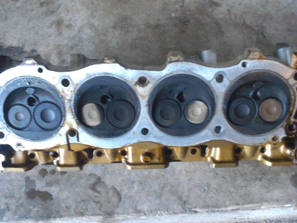

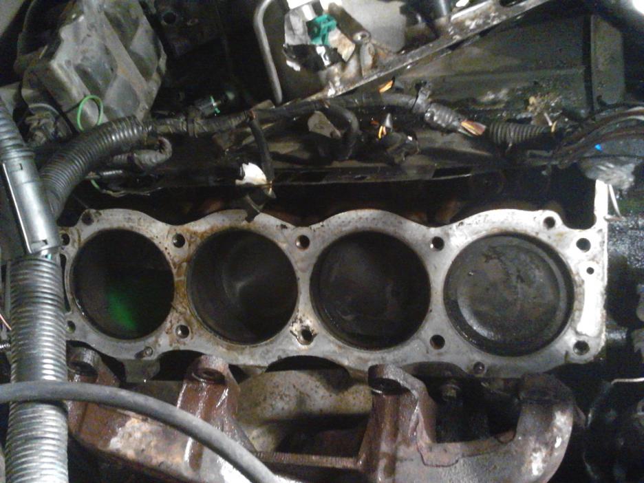

thanks buzz,worked for me. got both the heads off,ready to go to the machine shop!i am attaching some pictures so you guys can see what it looks like with the heads off.the reason im doing the heads is because i had a cooling problem,
after replacing the t-stat,the radiator,water pump,overflow cap,electric fan,i started noticing white smoke from the exhaust,figured it was a gasket, now here i am.
Attached Thumbnails 2000 disco 2 head gasket job-picture-011.jpg   2000 disco 2 head gasket job-picture-012.jpg   2000 disco 2 head gasket job-picture-013.jpg   2000 disco 2 head gasket job-picture-015.jpg   2000 disco 2 head gasket job-picture-016.jpg

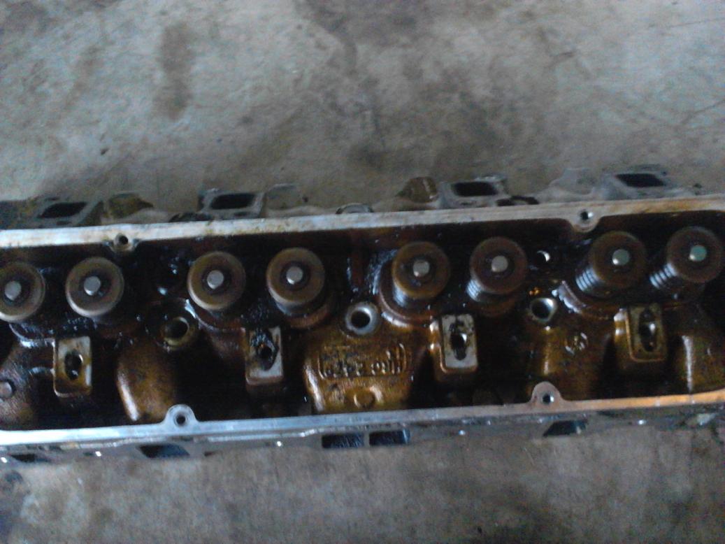

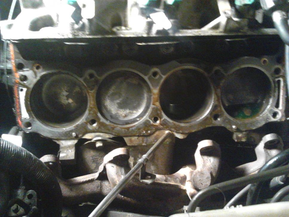

more pics
Attached Thumbnails 2000 disco 2 head gasket job-picture-017.jpg   2000 disco 2 head gasket job-picture-018.jpg   2000 disco 2 head gasket job-picture-012.jpg

Mine out-sludged you by a little. Keep the old valley pan gasket, use it as a template to line everything up (both heads and the valley pan) before you start torque on the heads. Trust me on this, and flip thru my ordeal posting on it.
Looks like valve train will need some cleanup. Not sure if your machine shop will take care of that as well. Mine did the heads and valves and seals for $250. I should have let him plop the valve covers in the hot tank.
Be sure, be dang sure, that any bolt you can start with fingers and keep going for many threads. Cross thread aluminum slows you down, costs more time. I put RTV around the 4 water channels (corner ports) on the valley, some do, some don't.
