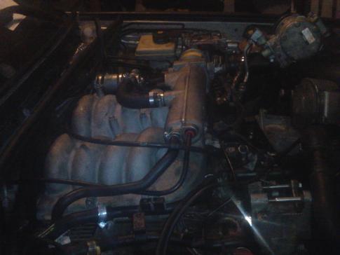

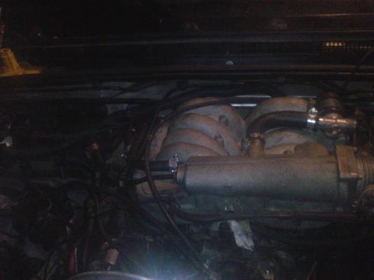

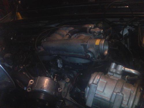

I wanted to show you guys my progress, its taking me awhile but I'm almost done, ..just spark plugs and pulleys, alternator, basic stuff to finish,, I really can't tell you guys how much I have appreciated your help, people that are willing to take the time out of they're day to answer questions for us newbies are invaluable, ...will post more pics and let you guys know how it goes when its finished
