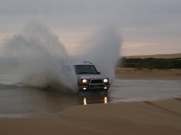

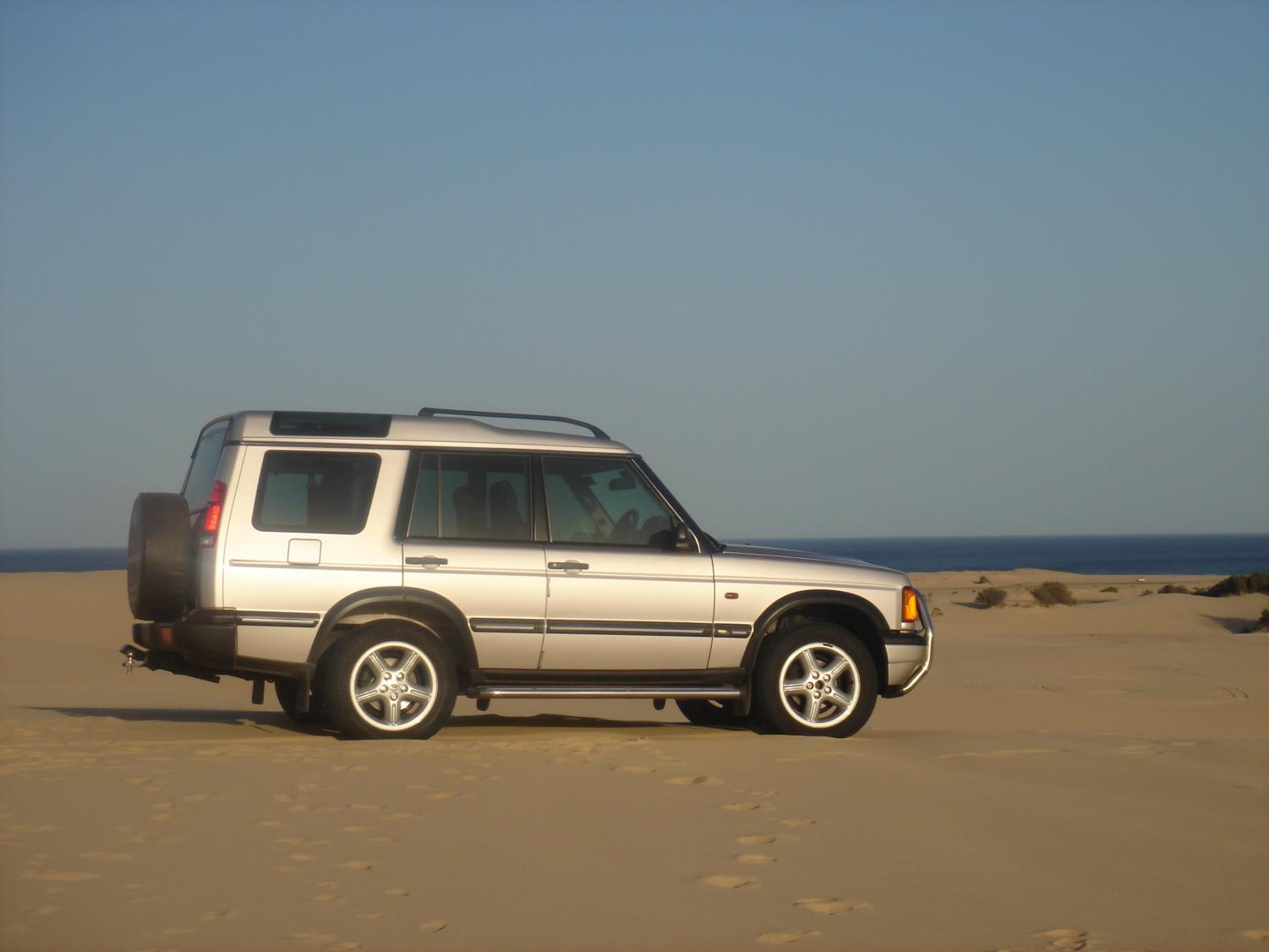

Hehee... funny you mention that, I actually married a yank from San Diego! I've posted a pic of the Disco on the beach up the road from our house
And, BTW.. thanks to all your advice, the misfiring issue is now FIXED!! Thanks again guys!
Attached Thumbnails 2001 Disco 2 runs very rough-septoct08-125.jpg   2001 Disco 2 runs very rough-grandma-papa-nov08.jpg
Last edited by ando98; Feb 2, 2012 at 07:57 PM. Reason: added an action pic for Savannahbuzz..

Your steering wheel is on the wrong side mate!!!
Hehee .. but remember, where does LandRover come from? The country that has the steering wheel on the RIGHT side ..

Oh and btw.. my avatar pic is of the car driving through fresh water (it had just rained), not salt . I guess when I mentioned we do a bit of beach driving the assumption is that we drive through salt water, but that's not the case.
