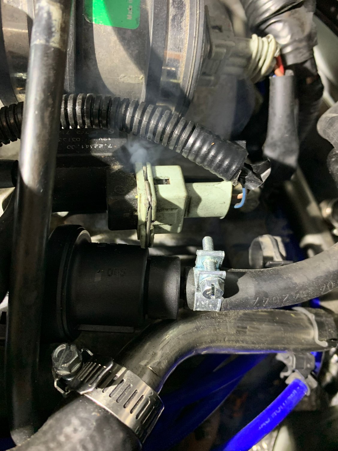

Default Spoke too soon...
Guess I will be replacing the vacuum solenoid after all!

What was the operational symptom of that SAI valve being leaky, other than the codes?
When I did a smoke test, all the smoke was pouring out the solenoid.

I wonder if I have the vacuum tubes going to the solenoid reversed from when I replaced the purge valve. Would it cause an issue to swap them around and see it that resolved it before buying a new solenoid.
