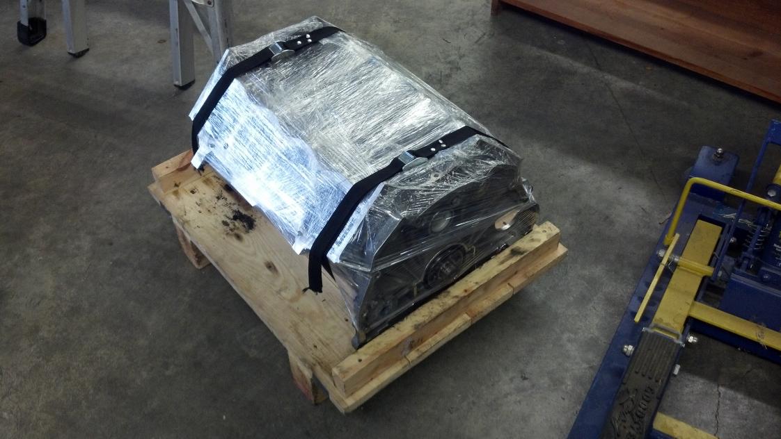

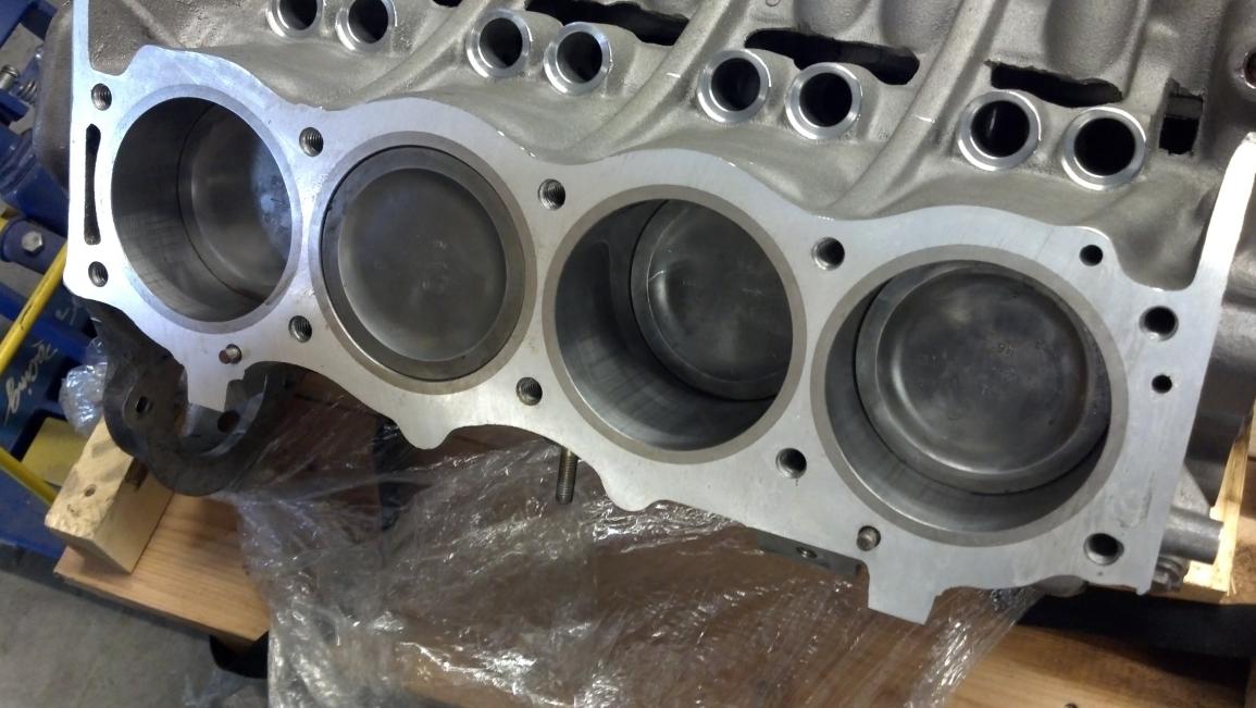

Engine was supposed to be here on Friday 1/27/12. Arrived a week later on Friday 2/3/12. Cannibal was a little slow to respond to emails/phone calls (I emailed them a week ago about shipping the core back to them and they responded that they would send me the bill of lading info... still waiting on that), however at the end of the day, the block arrived, looked to be very well done and I would recommend them to others. Other than the slow communications, the only other complaint I have is that I had to tap all of the threads that bolt the block to the bell housing/torque converter and the headbolt threads.

Turn alarm on/off several times, like off 4 times in a row, I think you may have awakened it and it immobilized the truck. When it immobilizes, no starter crank , no fuel, etc. Great looking block. If Rover had left off the alarm, and used that money for top hats or pinned liners, we would all be better off.
