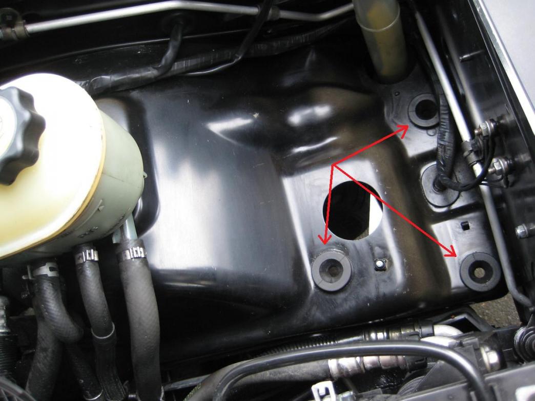

Checking the air cleaner today, I noticed I had alot of "dirt" in the bottom of air cleaner box. So I decided to clean it. Did not see any posts on how to remove it so I figured it out on my own.
The easy way would be to just vac the box clean, i wanted to pull it out and give it a good once over cleaning.
...remove the mass Air connection from the box.
...remove the air cleaner top.
...remove the 2 nuts securing the inlet to side wall (in picture) The lower part of this part disconnects from the airbox itself.
...the lower part of the box is secured by 3 posts, set into some rubber holes and with a nice firm pull upwards it will come free. PICS BELOW(Watch the little return line on the top of the radiator and your ACE / Power steering resevoir when pulling up on her.)
if this post is redundant... sorry. Thought it might help someone done the road. ( I always like to see pictures)
gives you nice access to do some spring cleaning in the front part of the engine compartment.

Nice job. Write-ups are always appreciated, and pics are definitely the most useful. I still can't figure out how to edit pics on my computer.

Pics definitely help out... I love to see a good pic before attempting to take something apart...that I haven't done before.
FYI...
If you have windows photo gallery
Use the OPEN tab at the top
Then I choose PAINT...
Can resize the photo there and use options to draw the lines... Etc.
