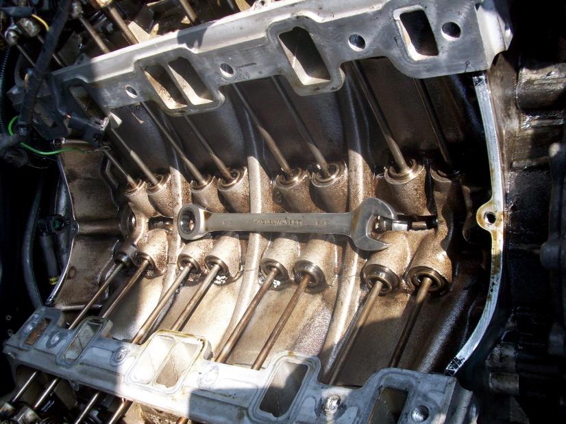

or this..... did you account for all tools and bolts?
can you take out the plugs and turn it by wrench? Or do a compression test (using starter, not the wrench)?
Attached Thumbnails back to square 1 again with 2 cylinders misfiring...-100_2422.jpg

Had it towed to a shop and they found that it is most likely a push rod out of place or bent. If so, what usually causes this?
Old Nov 15, 2012 | 07:15 PM
0304Disco's Avatar
Joined: Oct 2010
Posts: 514
From: IL
If you broke a valve spring it could cause the push rod to not seat on the lifter or bend the push rod. You really won't know until you start breaking it down.
