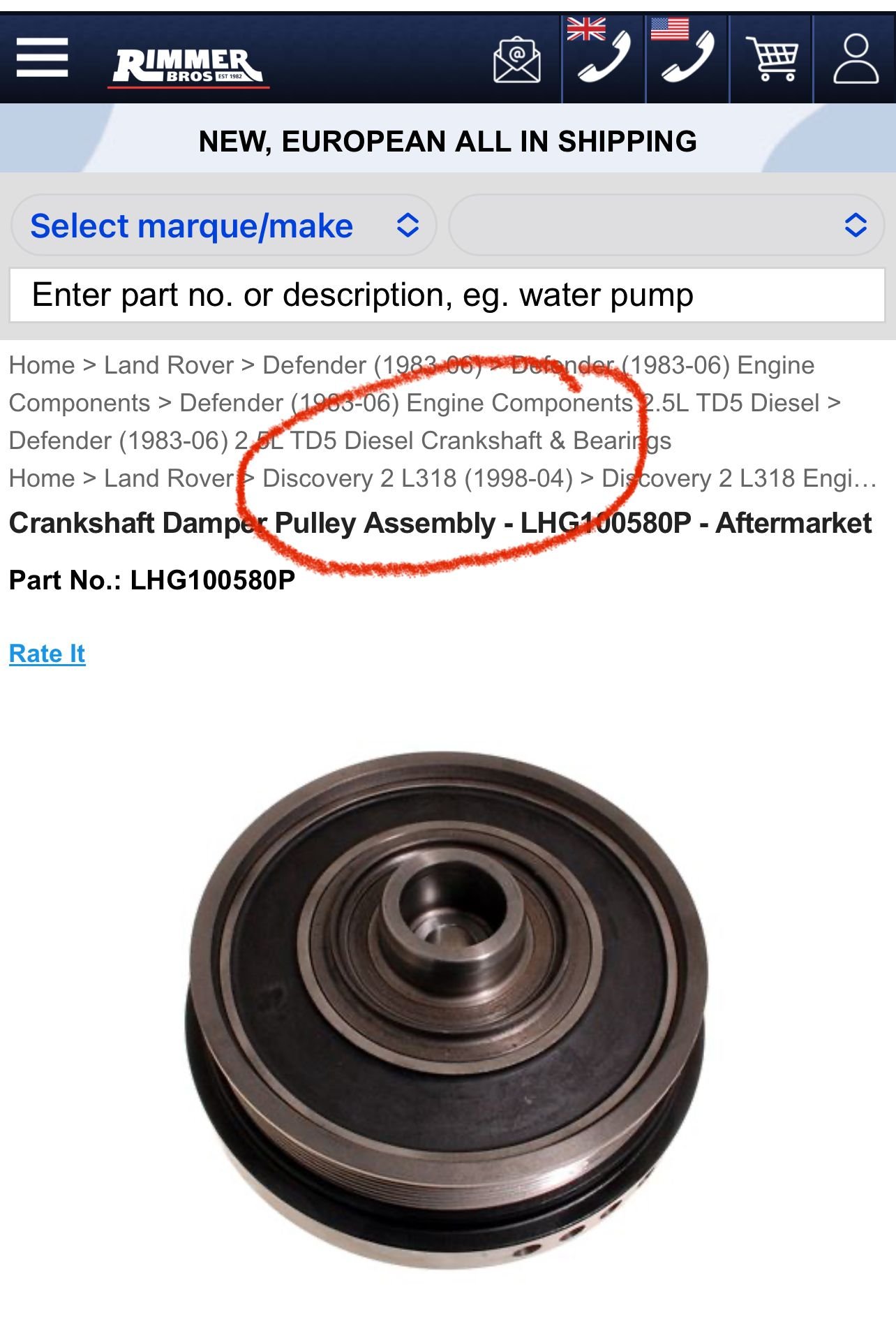

I ordered the wrong pulley damper from Rimmer in the UK.
Saw that it fitted ‘04 and ordered without checking the part number. It fits 98-04 deisels. Doh.
Rimmer shipping to US was lighting fast, however I’m stung for the return shipping.

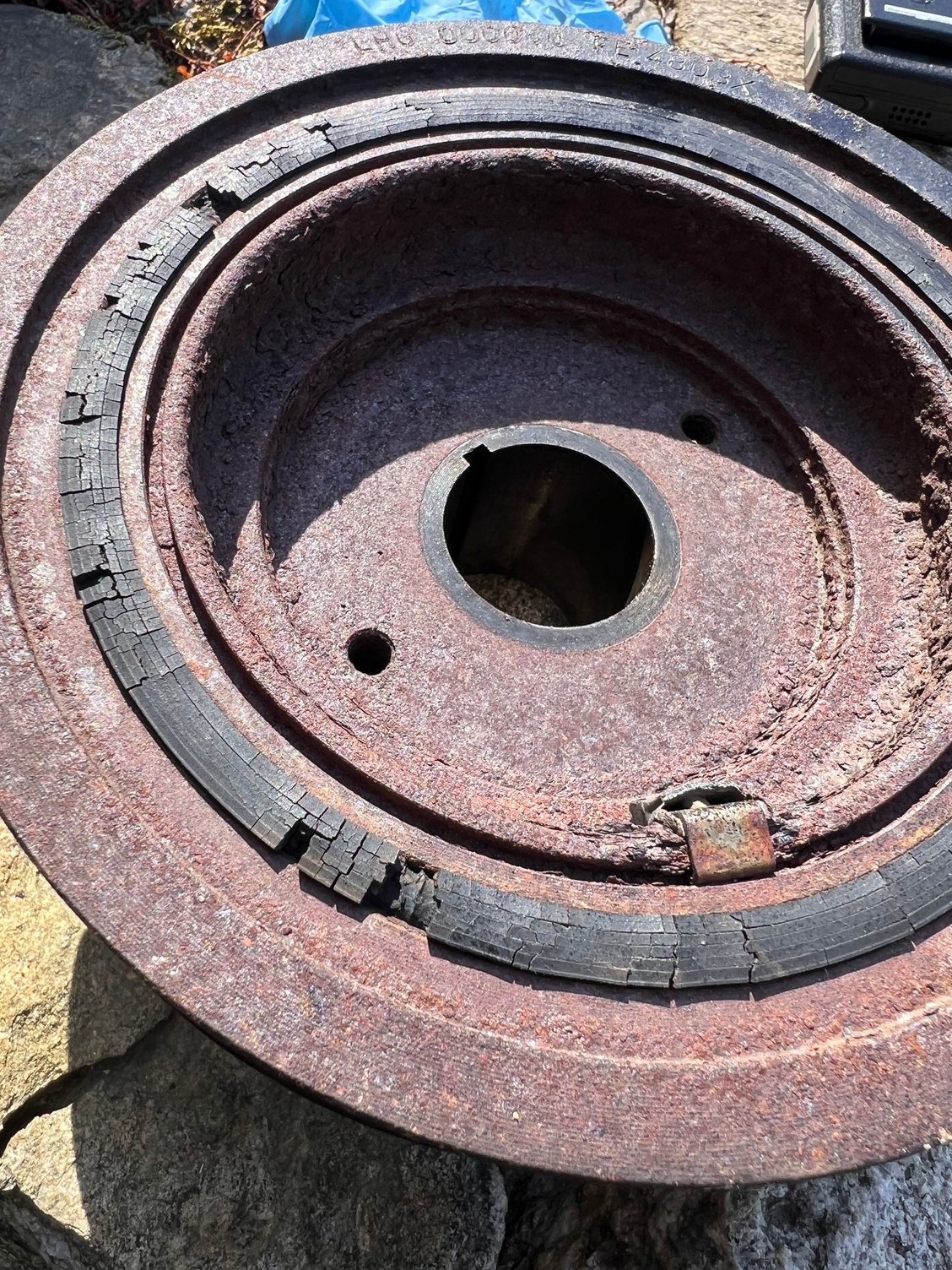

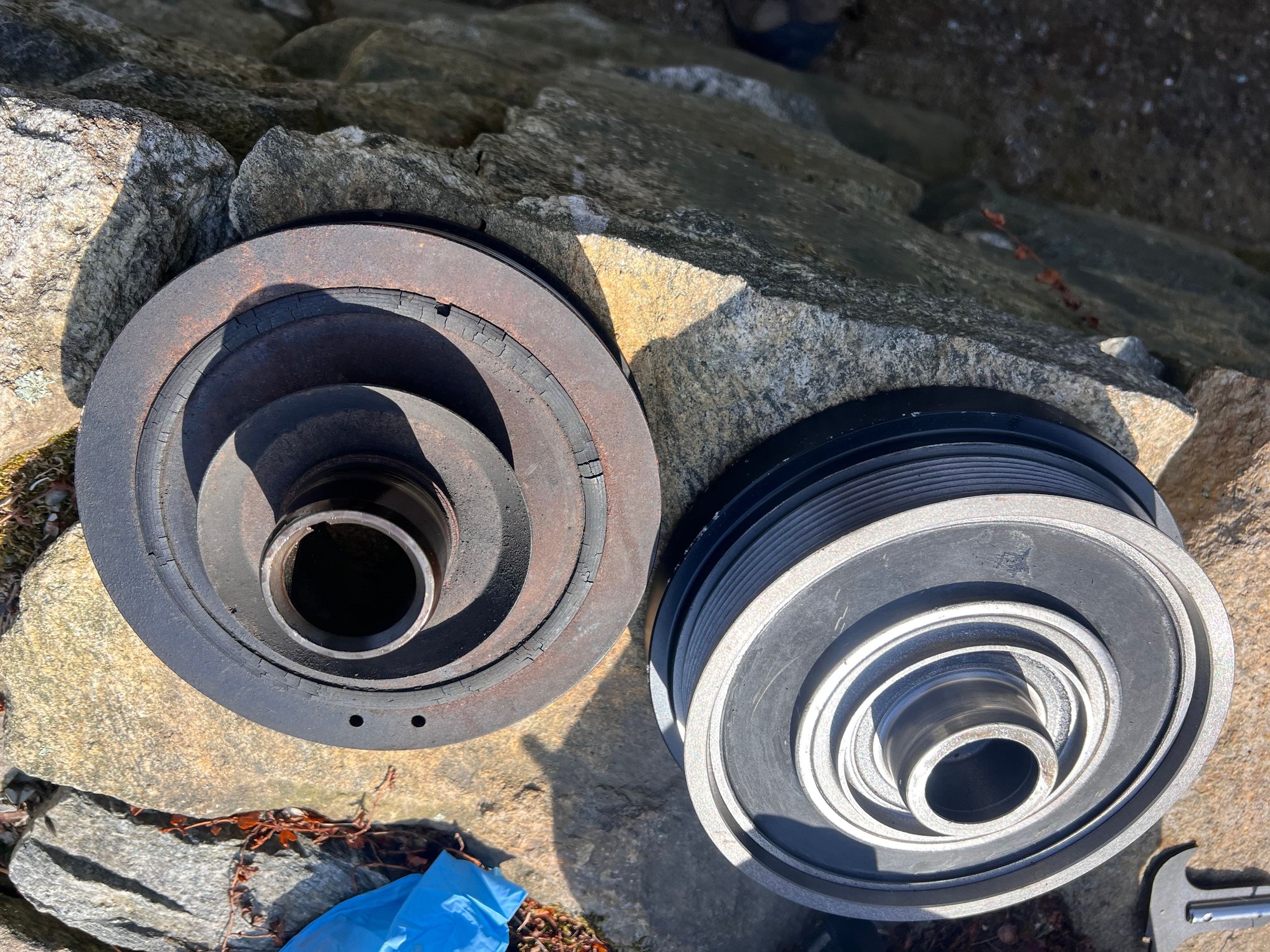

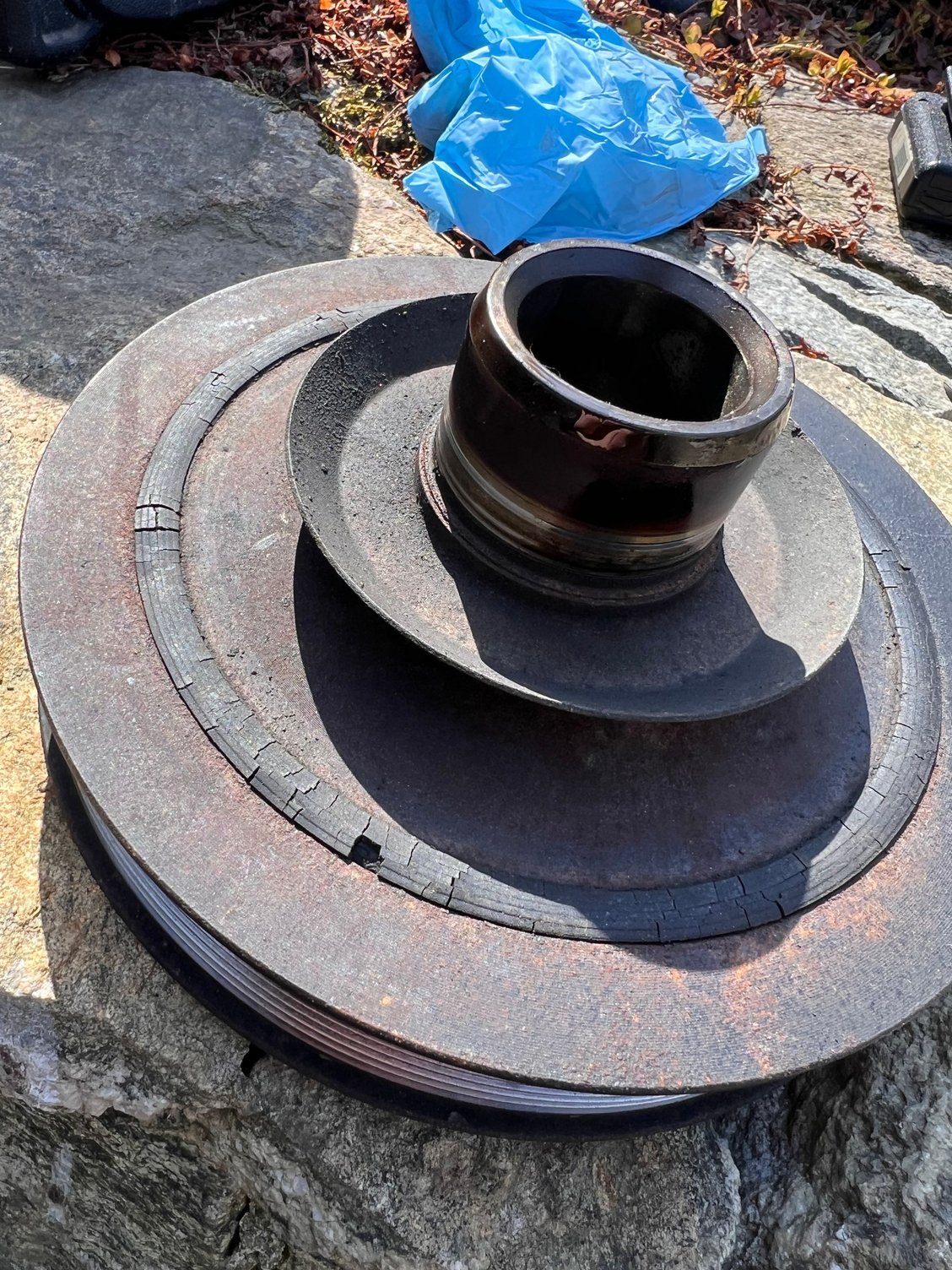

So, I got a good look at mine, as I took it off.
Does this look like it could cause a weird harmonic vibration at the front of the car? (Hubs/bearings were done recently.) I believe that rubber is really breaking down and becoming detached from the pulley itself.
Found a used one that is in far better condition than mine. Will swap that on and see if my vibration goes away.
